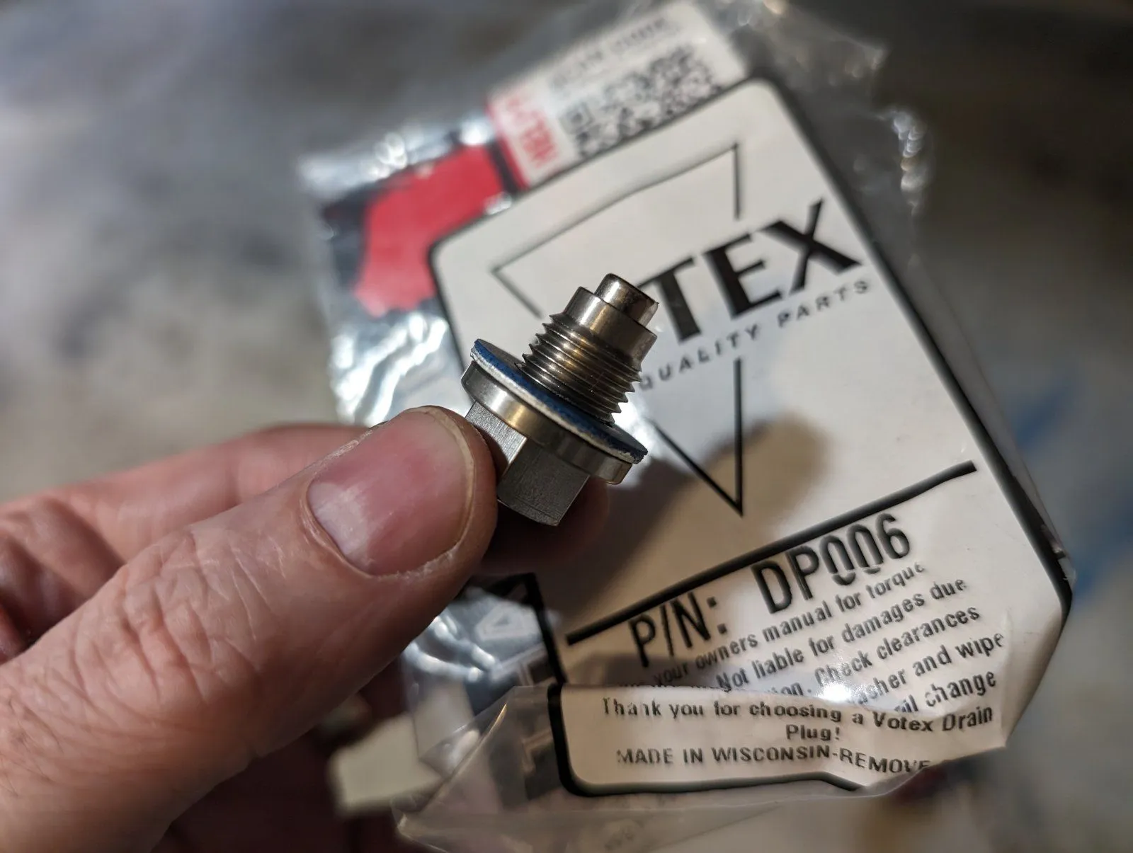

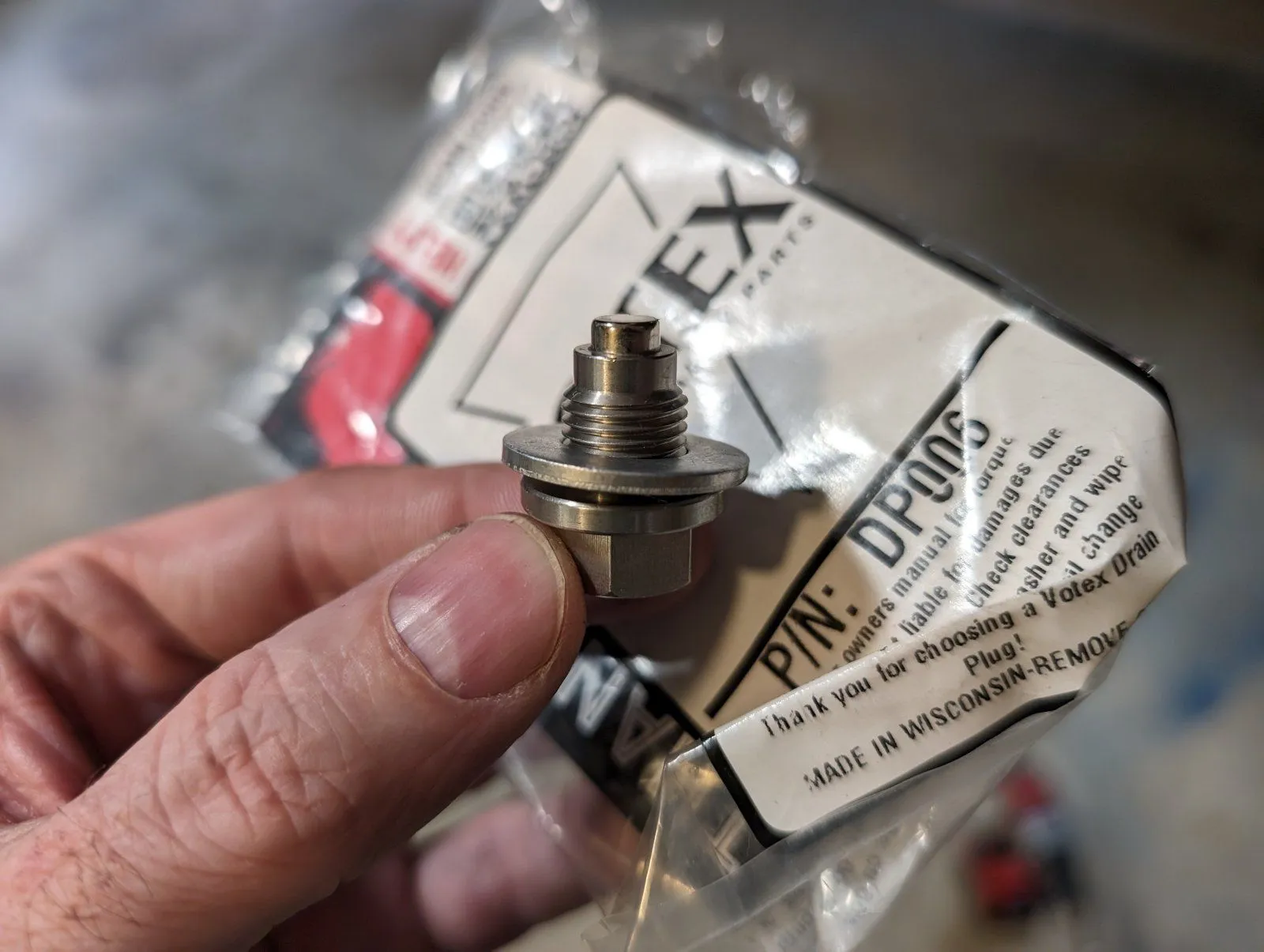

For those interested in the Votex magnetic drain plug, please note that it comes with a metal washer that is NOT needed on a Lotus/Toyota motor. Use the standard single-use Toyota crush washer each time instead.
Votex with included washer (dispose):
Votex with new Toyota crush washer:

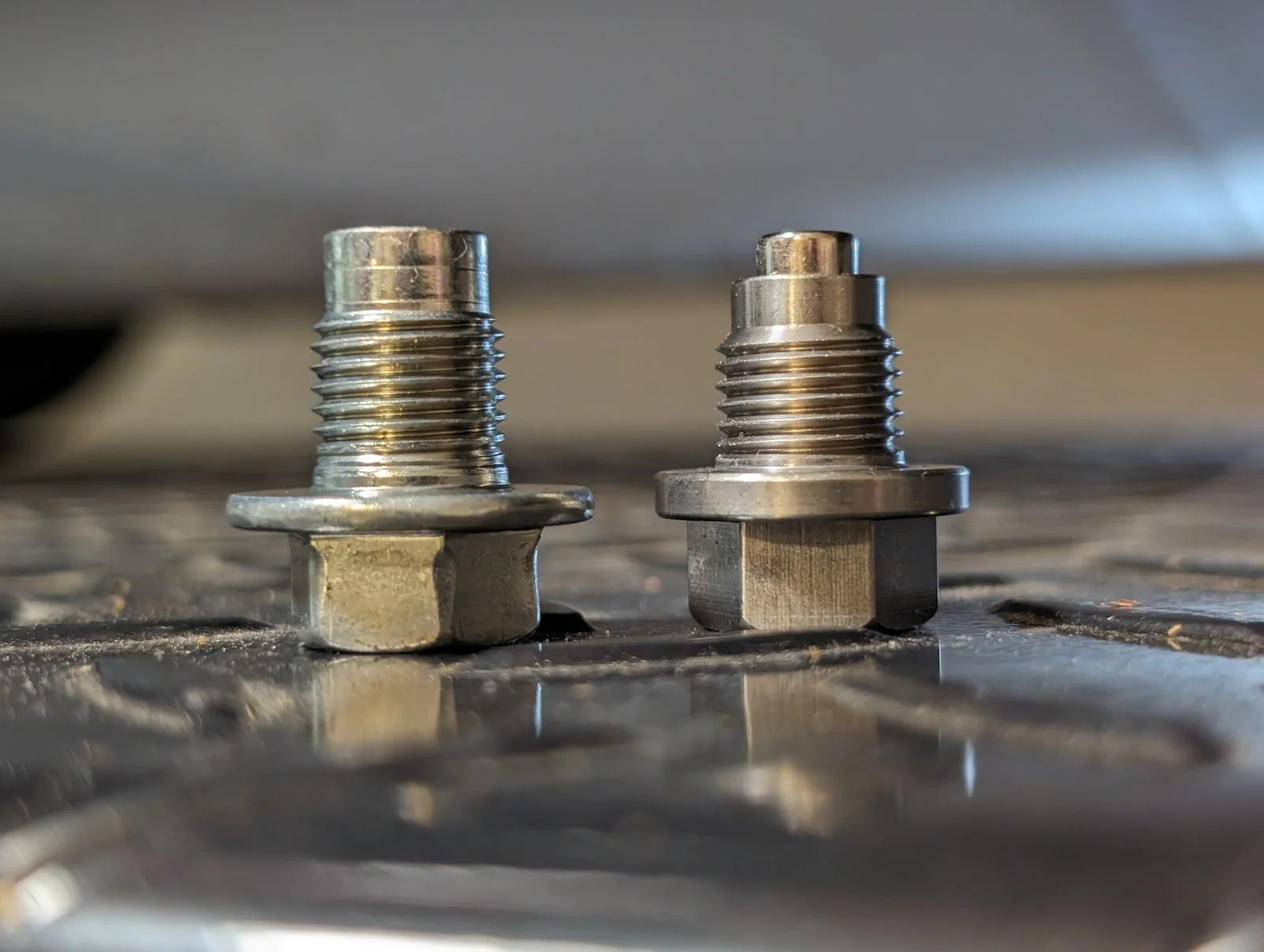

Votex compared to stock drain plug, both are steel. There is plenty of thread length to fully screw into the factory oil pan. Votex on right:

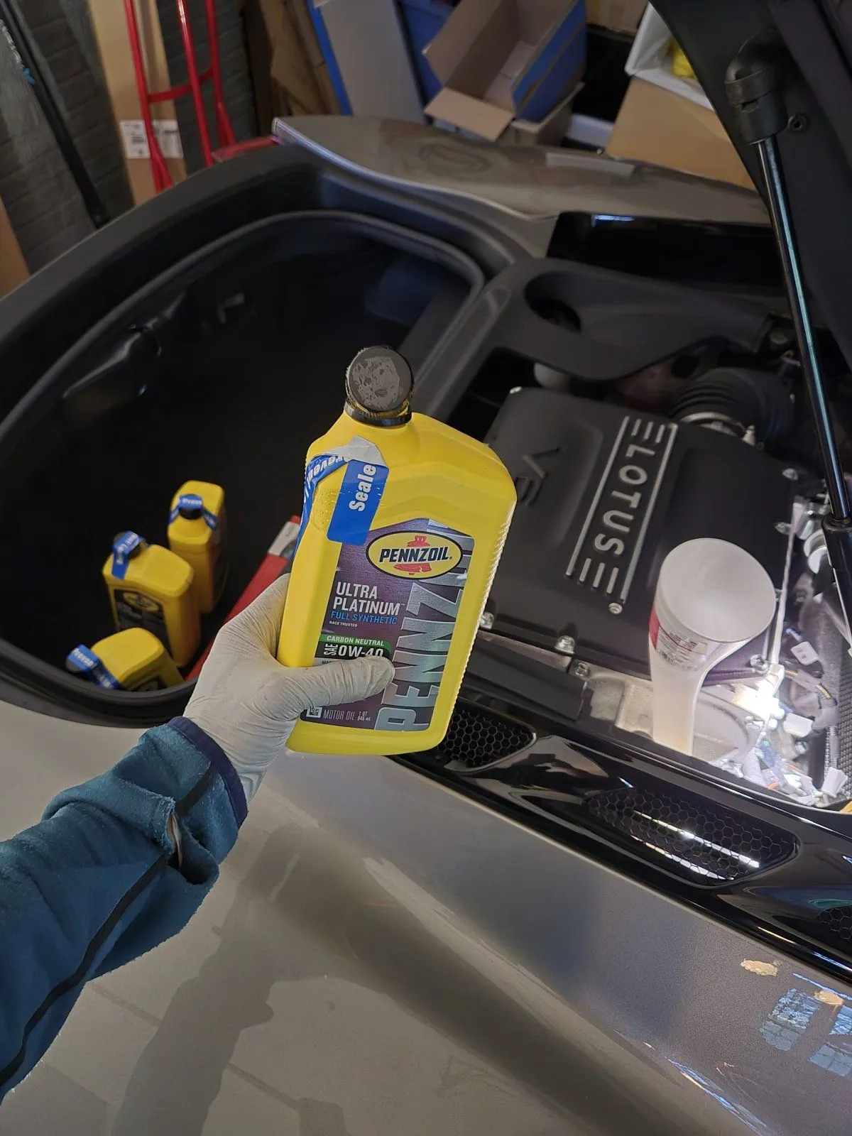

I also changed my oil yesterday at 724 miles. The sample is off to Blackstone for analysis. I was lazy and didn't clean off the undertray before reinstalling it. There was some stone crunching on the reinstall while tightening the bolts that made me wince. Remember to clean off the undertray before you put it back. I got maybe a little over 5 quarts of oil out of the car.
On my car, the filter housing was only hand tight - I was able to spin it off with my hand. I bought the motive tool set but only used the wrench for re-tightening. I placed a plastic bag over the housing while unscrewing it to catch all the oil drips. The oil fill cap on top of the engine was also kind of loose.
The zigzag funnel was very helpful.
I got a bit more. I put 6 quarts back in and the level after running briefly was in the upper half of the dipstick range.

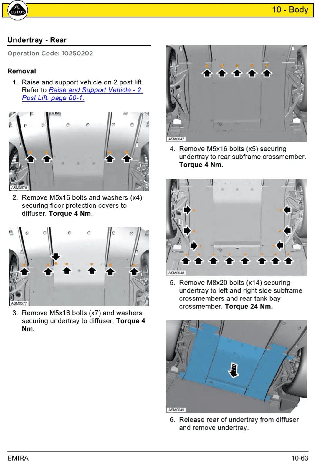

Is there a DIY writeup on removing the access panel for the oil change?
How about we go one better?
FYI the bolt count and descriptions are not a 100% match to the car as manufactured. So use this as a general guide, not an exact step by step. For example, there are 3 10mm bolts under rubber grommet covers that aren't called out in the diagram.
We removed all fasteners, pulled down on the plastic rear diffuser to let the access panel shift rearward (releasing the front edge) and then carefully lowered and removed it.
Thanks Porter. That was one of my thoughts. Do you need to remove any bolts from the diffuser undertray to facilitate removing the oil change access undertray. I'd like to put together a cheat sheet for my indie that I will have do the oil change.

You do need to remove some bolts that go into the diffuser, but they actually go up through the tabs extending off of the rear aluminum undertray as well. Essentially you're just decoupling the plastic diffuser panel from the aluminum undertray at that edge where they meet.
Removing the rear diffuser panel itself is not necessary. There are a number of small hex socket fasteners in it for example, and I didn't touch a single one.
