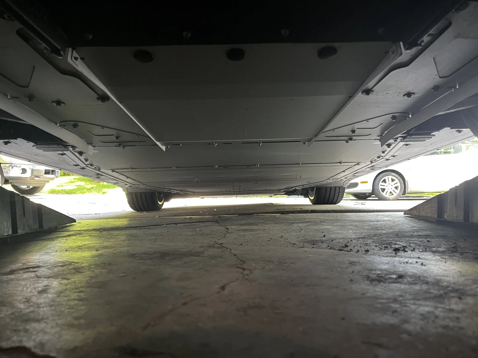

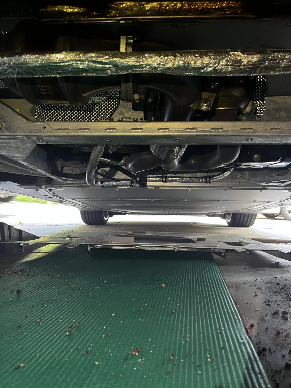

In this case, with a 4 post lift.
You could do it with a set of race ramps or rhino ramps under the rear wheels, but it would be pretty awkward with so many bolts to remove. Do-able though.
I just used regular rhino ramps. The car has plenty of clearance so you don't need low profile ramps. That being said, it was a relatively tight fit under the car.
I also did not see the manual images posted above so I ended up removing the plastic diffuser as well. Honestly was not bad, just time-consuming. Kinda glad I did because it gave me the chance to dump a ton of small rocks that had accumulated up there somehow.
A 4 post lift would make the job super easy IMO.

Thanks KCDarkV. You've answered one of my questions: I see you backed the Emira up onto the Rhino Ramps. One other question: does your driveway slope down from the garage floor, increasing the space under the rear end of the car, or is your driveway level to the garage floor? Appreciate your post with pics and comments.
Walmart usually has the 0W-40 Mobile 1 Euro oil for around $25 per 5 quart jug. I used a lot of it on my various MB cars. I used the Pennzoil for the first oil change on my Emira but I'm sure the Mobile 1 is fine also.
I also backed up to Rhino Ramps, and while it was a tight fit under the car to get the rear tray off, all went well after that.
My driveway is pretty flat leading into the garage. Glad you found the pics helpful!

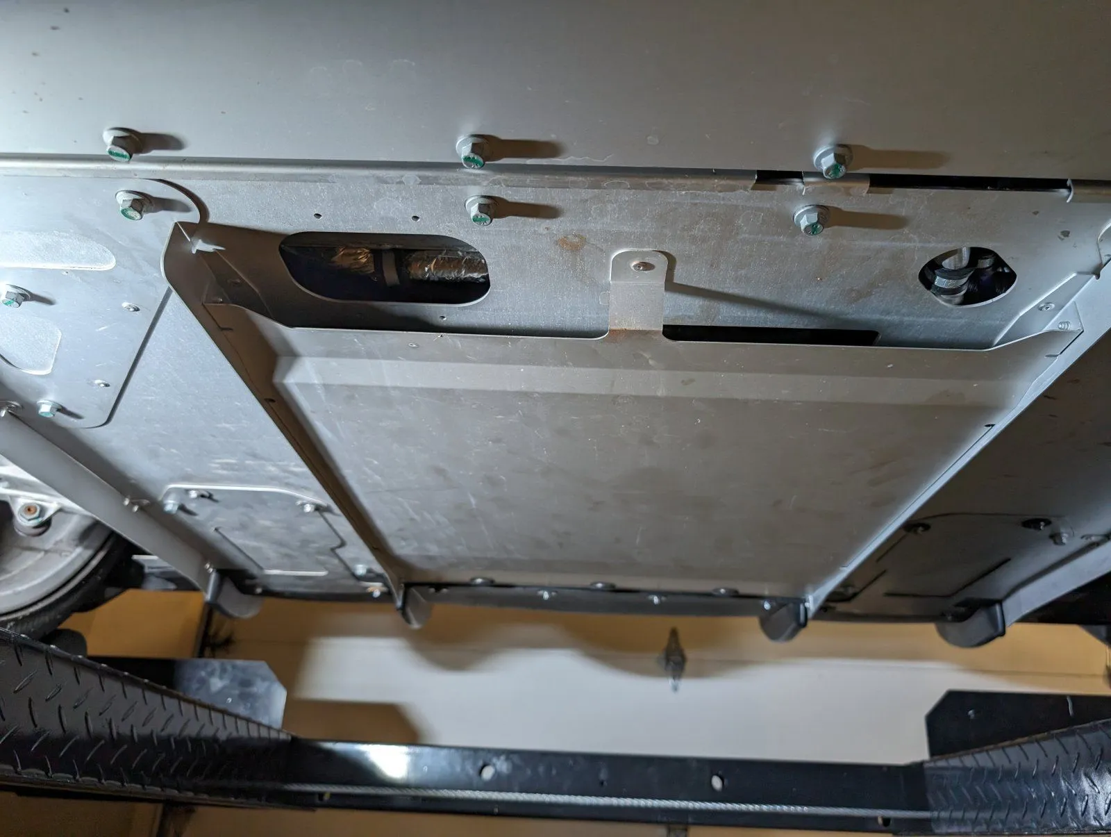

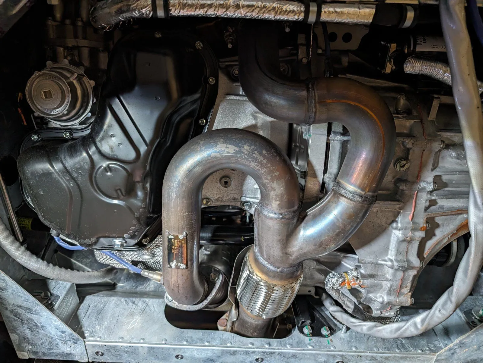

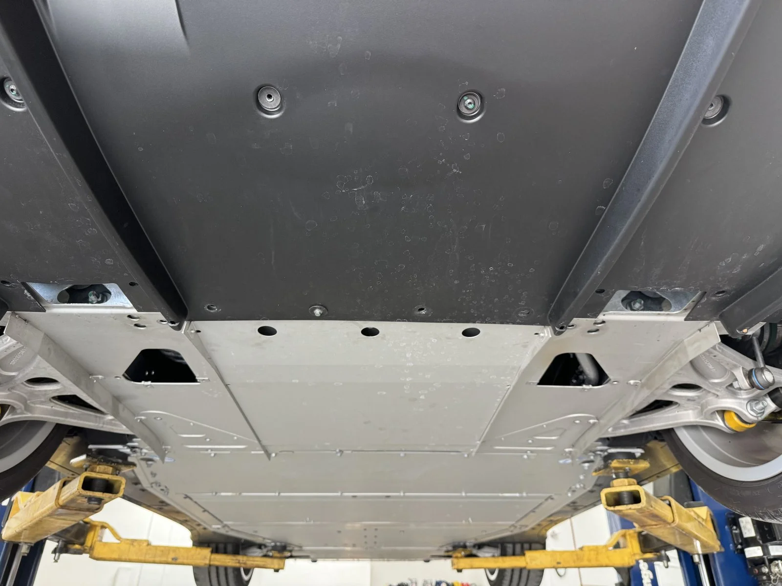

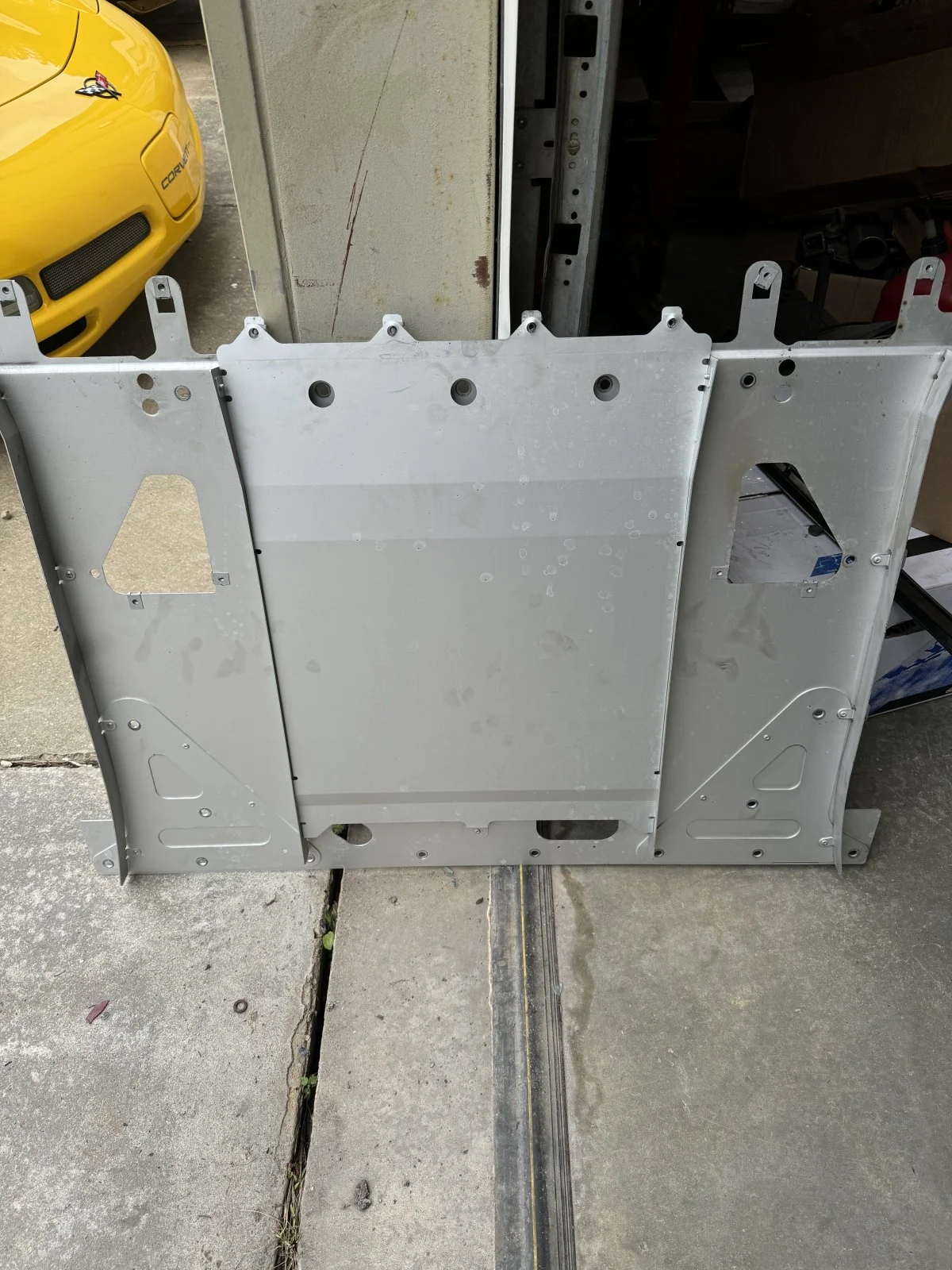

Did my first oil change yesterday, with the kind assistance of @B r I a n
The number of bolts on the bottom of this car is insane. It all goes together quite logically, but wow. I can't imagine the engineering schematics involved in designing all of these precision-fit interlocking pieces.
Bottom access to the engine is great once the undertray is removed. Clear and easy.

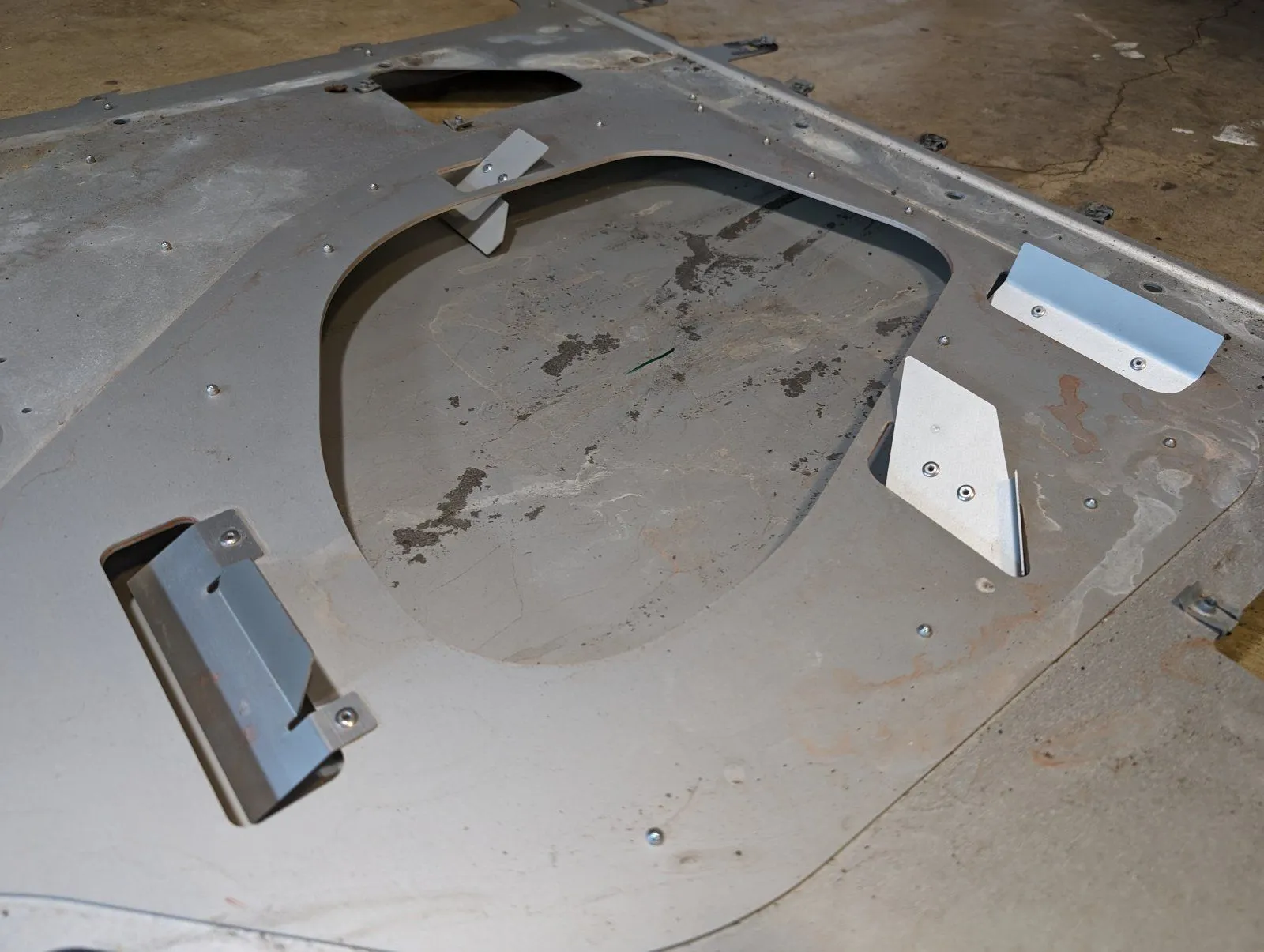

Here's the top side of the ducted undertray showing the air management. Very cool design.
do you have the touring mode? Mine is missing the panels for the 2 openings. I have the sport.
Does everyone have 2 holes on each side of
do you have the touring mode? Mine is missing the panels for the 2 openings. I have the sport. View attachment 45150
No, I have Sport. Very interesting.
Were any of the fasteners there? The 10mm bolts on the outer sides?
I wonder if yours were removed to check something and then not reinstalled ? Seems weird to be a production change.
Very odd, talked to service at my dealership and said it was a tour and sport mode thing, but I think that’s not right.
