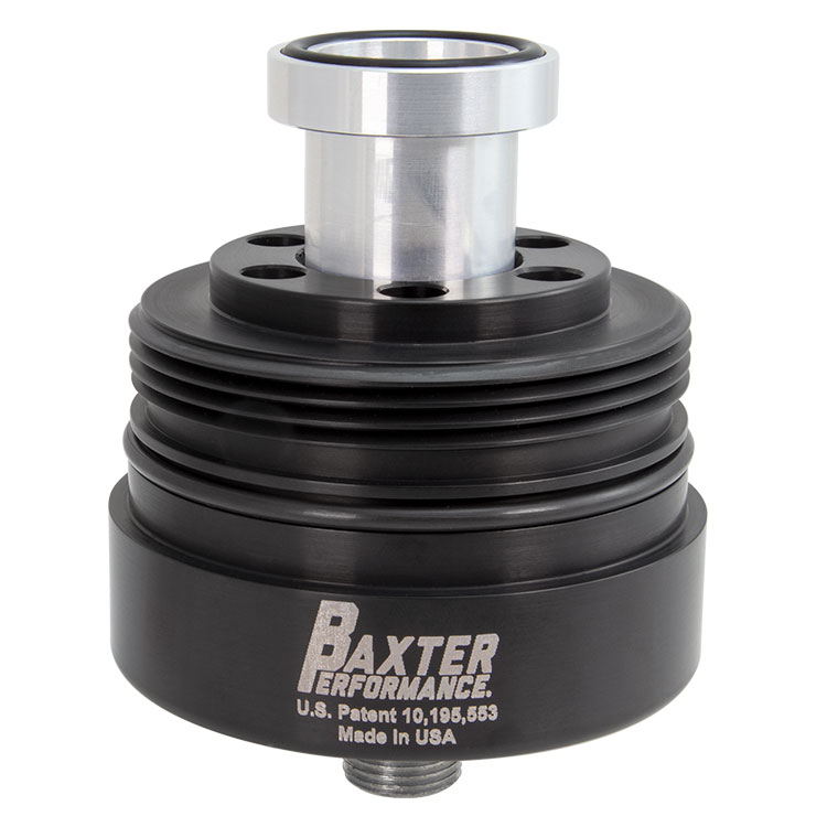

At first blush, it does look like a neat solution to the oil spill problem which I've encountered with all drop-down internal filters, although you'd still get some, as you do with any spin-on external filter. The back-flow prevention of the spin-on filter, is a bonus as well, which is something he mentions in the video. Aside from the question of whether there's room on the Emira to accommodate both the adapter and the spin-on filter attached to it, there's the question of which filter to use AND whether the use of this new filter risks invalidating the engine warranty. Assuming it fits, this may be something to consider AFTER the expiry of the engine warranty(?). Some food for thought. Thanks for the interesting post brainf18.
agreed...I'd probably not install it until after the warranty has expired.

I put one of these on my 986 Boxster, worked great and made oil changes way easier. As mentioned, I will wait until warranty has expired before upgrading...

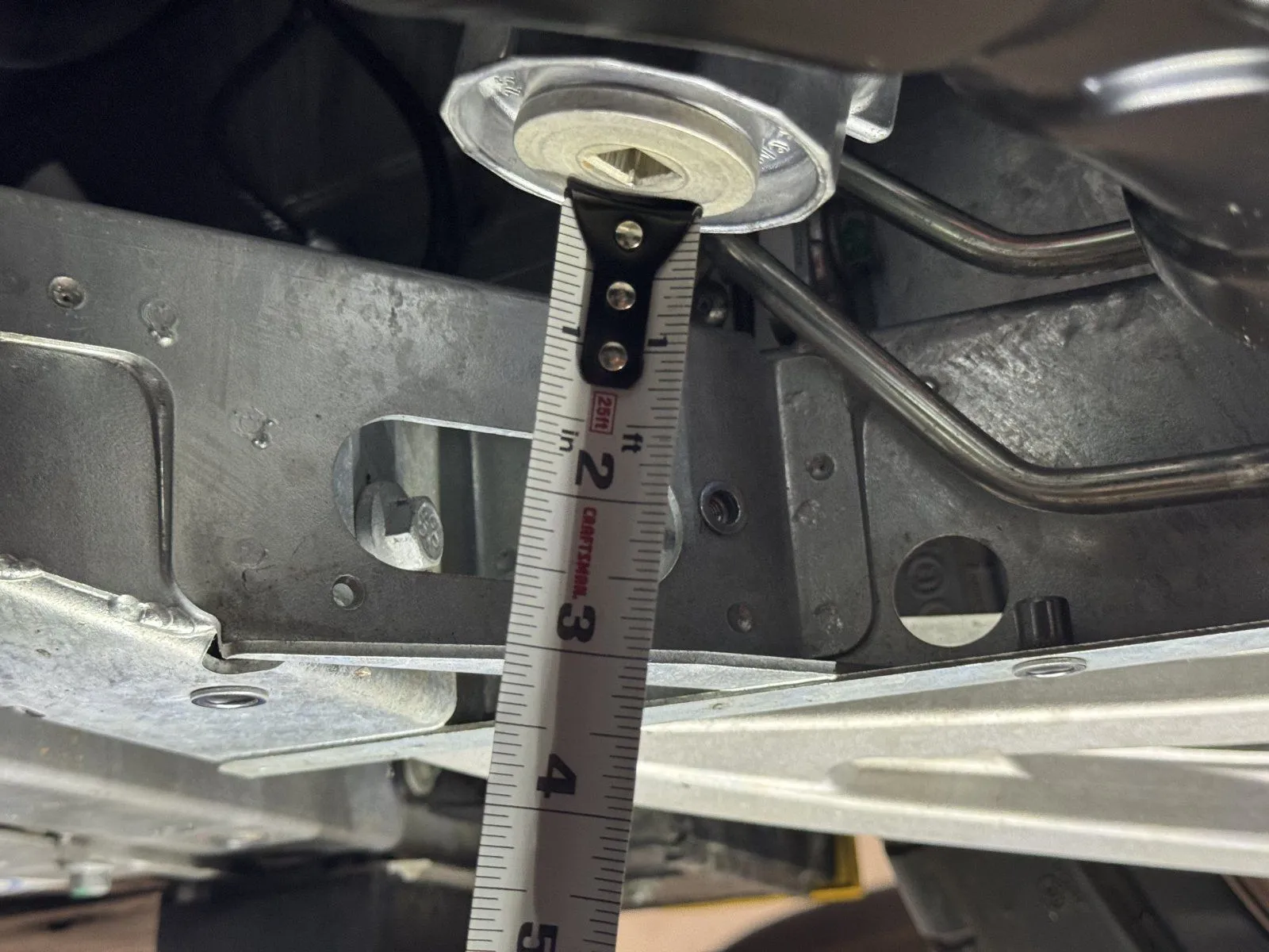

I’m under mine today. There is about 3in from the oil filter housing to where the undertray would be. I would say max clearance to keep things safe is 2.5in
You'll gain some clearance with the cartridge removed...but doesn't sound like enough room for a reasonably large oil filter. But least the Emira's filter cartridge is metal!

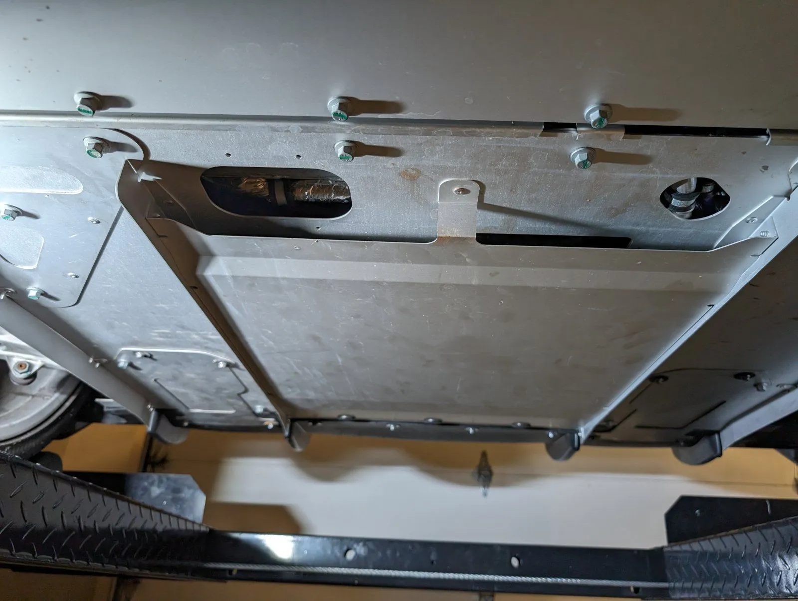

Did my first oil change yesterday, with the kind assistance of @B r I a n
The number of bolts on the bottom of this car is insane. It all goes together quite logically, but wow. I can't imagine the engineering schematics involved in designing all of these precision-fit interlocking pieces.

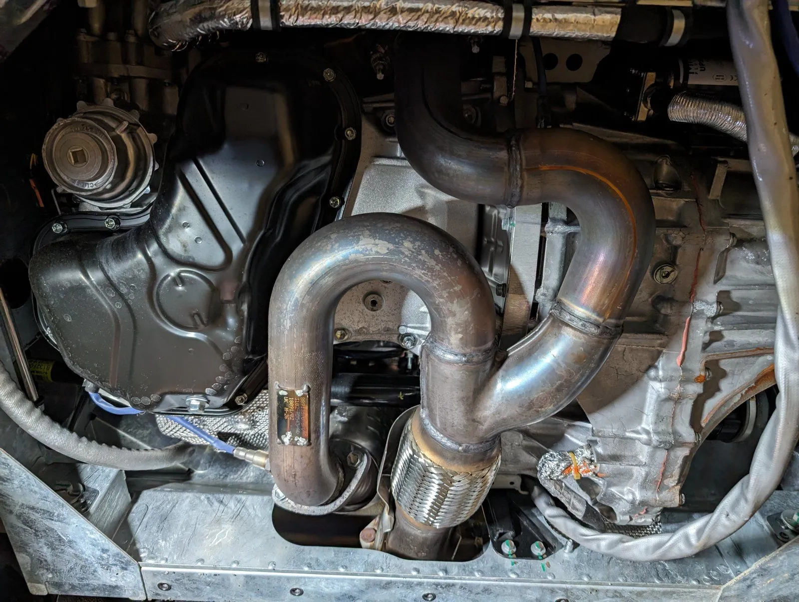

Bottom access to the engine is great once the undertray is removed. Clear and easy.

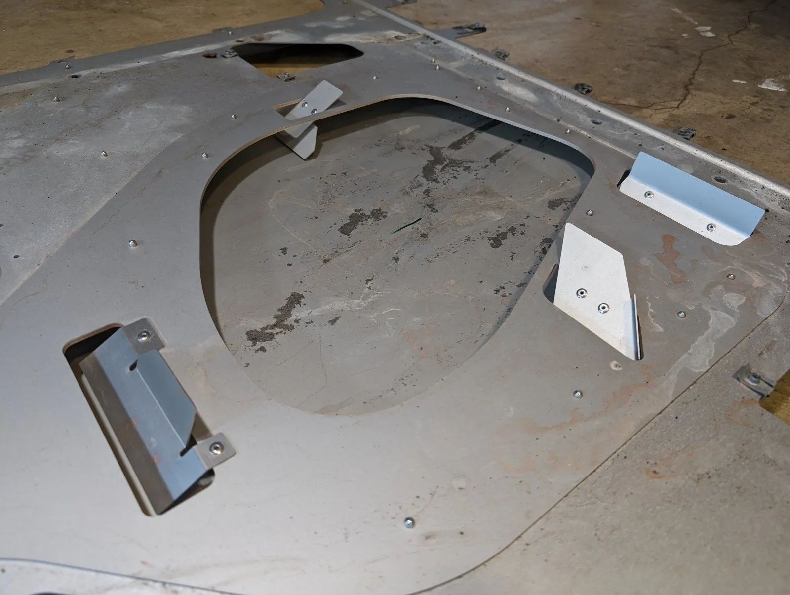

Here's the top side of the ducted undertray showing the air management. Very cool design.
