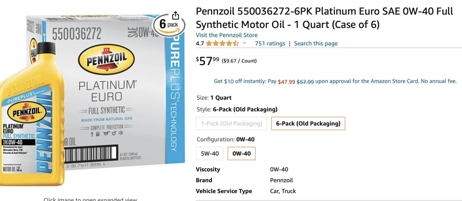

Try this instead for the motor oil:
Why would I want to do that? Just to go longer between oil changes?
Extending the oil change interval doesn't make sense to me unless this is a consumable daily driver that someone intends to get rid of in 50k miles.
If you intend to change the oil every 5k miles, the Ultra Platinum I originally linked is better oil. Or, quite frankly, Amsoil Signature Series 0W-40 which is excellent as well. It consistently tests to be one of the finest motor oils available and is just slightly more expensive than the Pennzoil Ultra when purchased by the case.
