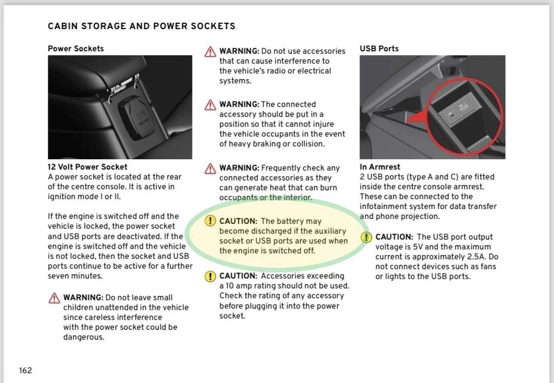

I’m pleased so far with the Garmin Dash Cam Mini 2…and the Garmin app is surprisingly good. I also note that it stays on while the car is turned off - so I unplug it so as to not drain the battery.

It should turn off, but it takes several seconds. At least that’s the case with the connection I tapped for my radar detector.
try turning the car off and locking it, it should turn off
Ah interesting, I could be wrong then. I can't try it because the car is away getting ppf

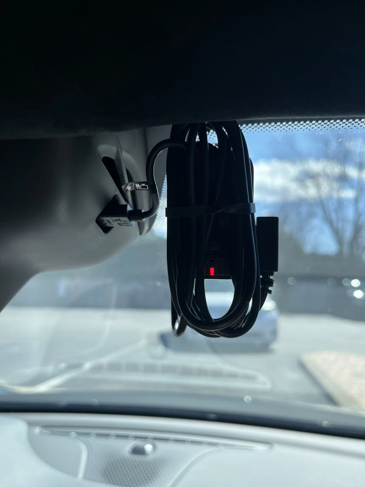

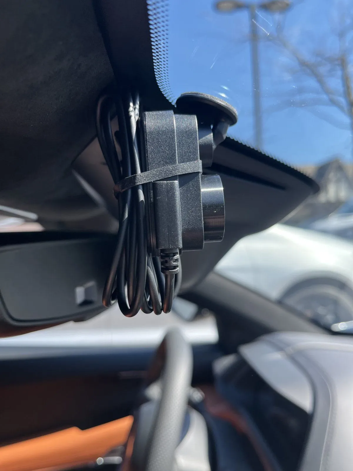

I bought this one. I had heard it might not work on the Escort 360c because of the amperage loss during conversion. But I got one and plugged it into a usb on another vehicle and it works just fine.
I'm replying to my own message with an update. I picked up the car today and connected my Escort 360c with the above mentioned step up cord. It worked just fine with no intermittent issues. I'll keep an eye on it but it's very practical.
