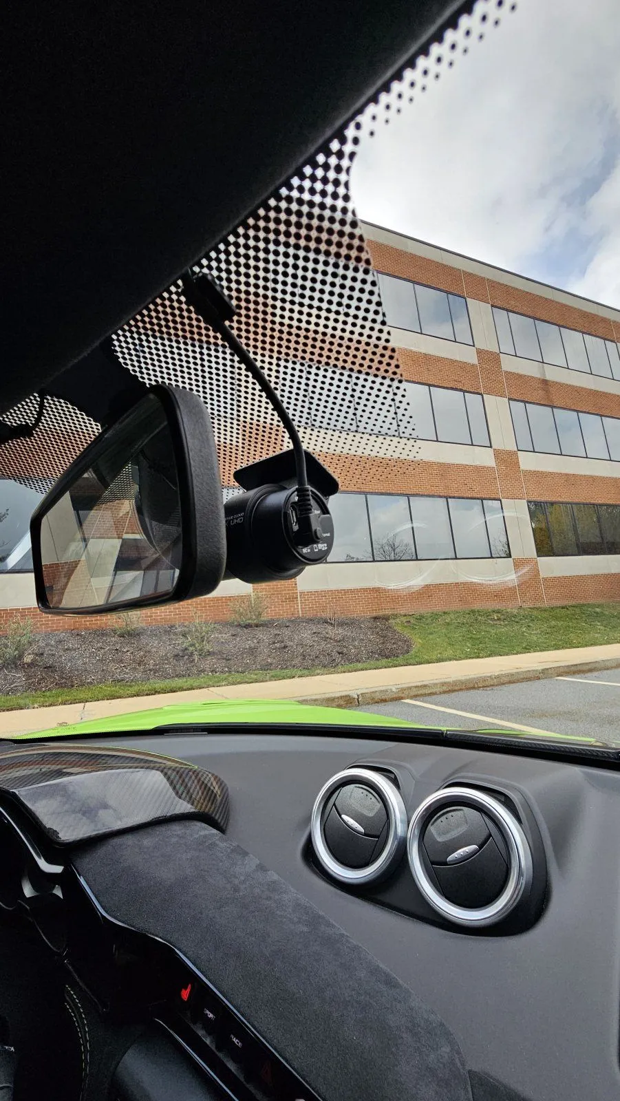

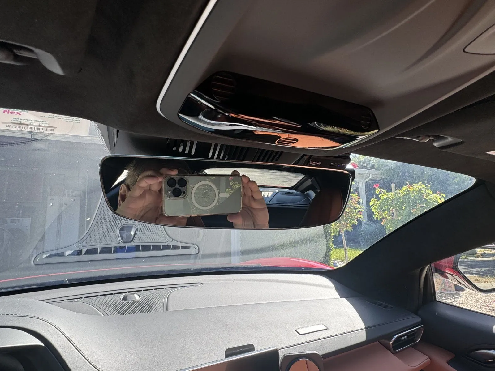

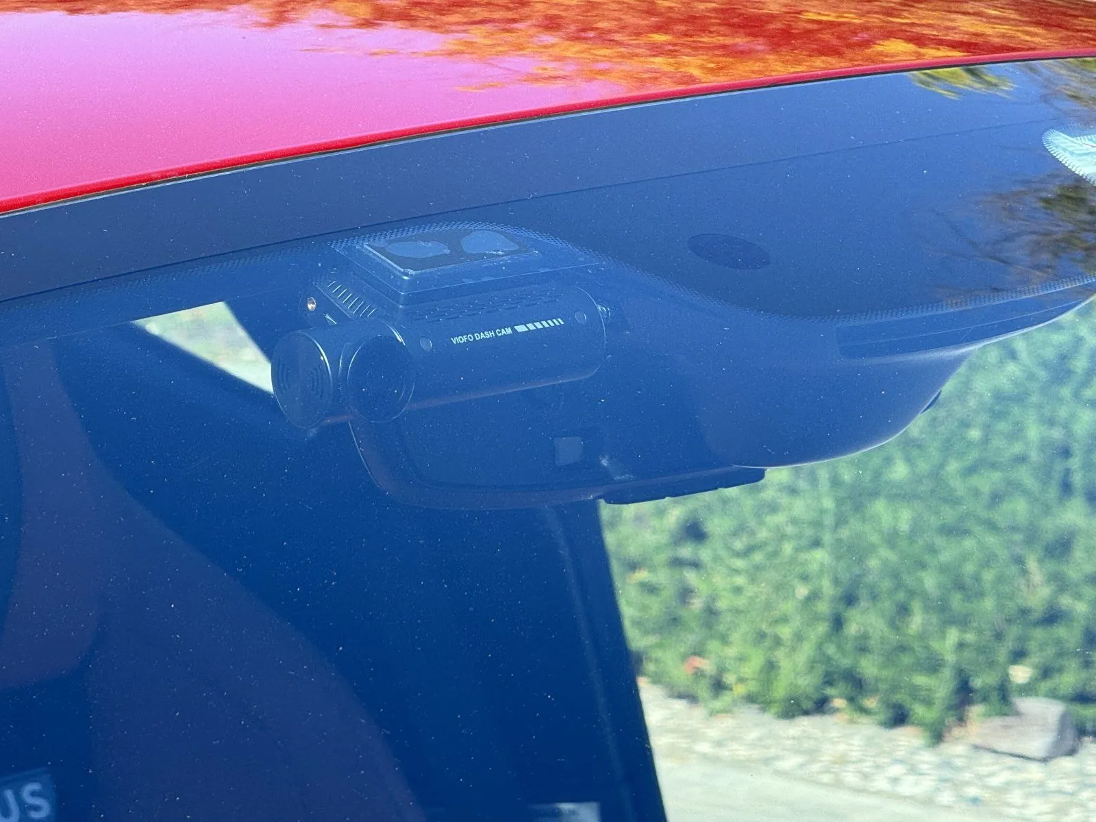

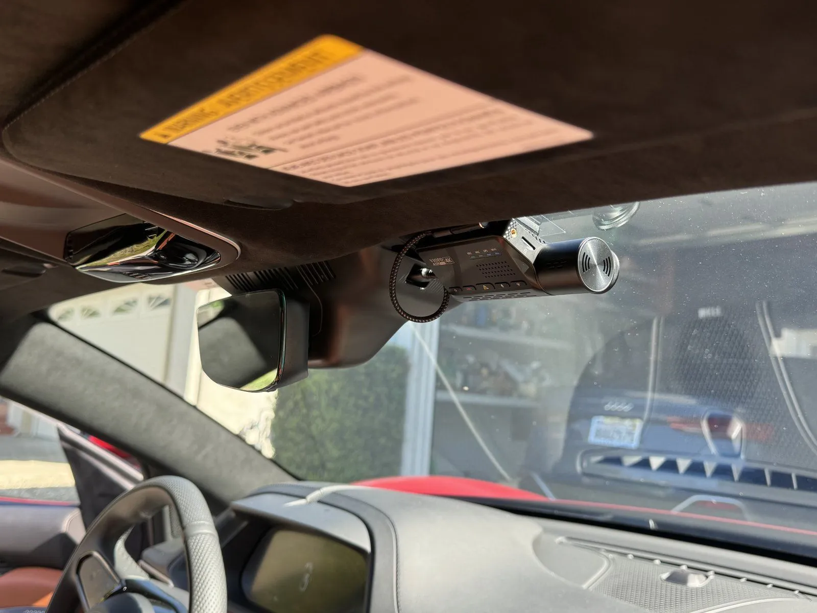

I finally got around to mounting the dashcam yesterday. I first tried mounting it directly under the mirror mount. Although it's totally hidden from my view by the mirror, it is quite noticeable from the outside.
So I removed it and started over as they do give you extra adhesive pads. In the process of doing that, I finally took notice of the 2 static stickers in the box. Gave them a try and they seems to work great. Move it to the passenger sidenext to the mirror mount. looks pretty good, will run it a few days and see.

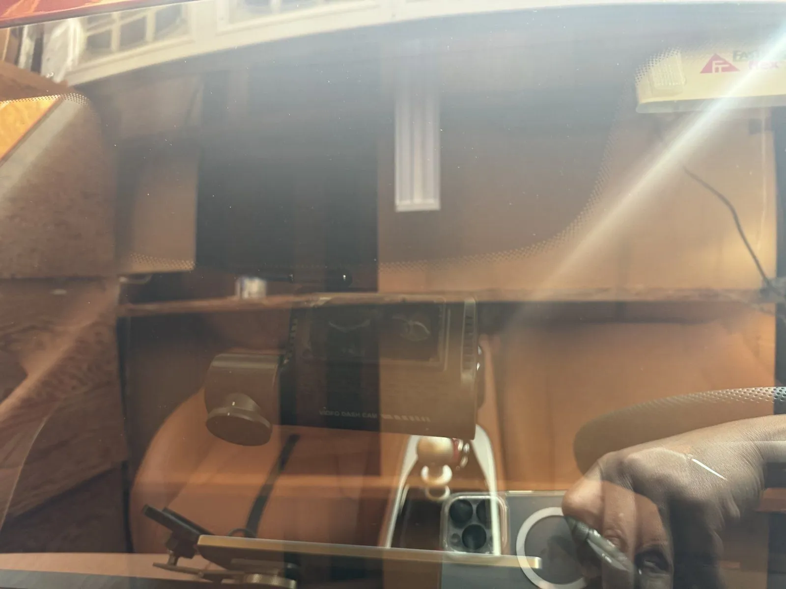

I'm liking the look of that location in the second pic from the inside. What model is this?
I'm really happy with my BlackVue 970X Plus dashcam. I still gotta wire up the rear cam. I tested it through the louvered hatch and was able to actually capture some decent footage if anyone rear ends me. Plus I get to see the engine and supercharger actuator flexing. 😉

I finally got around to mounting the dashcam yesterday. I first tried mounting it directly under the mirror mount. Although it's totally hidden from my view by the mirror, it is quite noticeable from the outside. View attachment 44145
So I removed it and started over as they do give you extra adhesive pads. In the process of doing that, I finally took notice of the 2 static stickers in the box. Gave them a try and they seems to work great. Move it to the passenger sidenext to the mirror mount. looks pretty good, will run it a few days and see. View attachment 44147

I installed my Viofo A229 Pro in almost the exact same location as your second one, but I moved mine forward (down the windshield) a bit so I couldn't see any of it from the driver's seat. The area above the mirror on the right isn't blocked on mine.

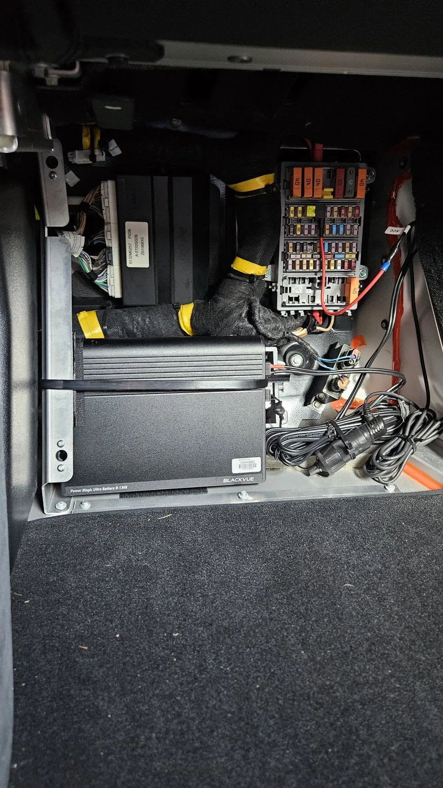

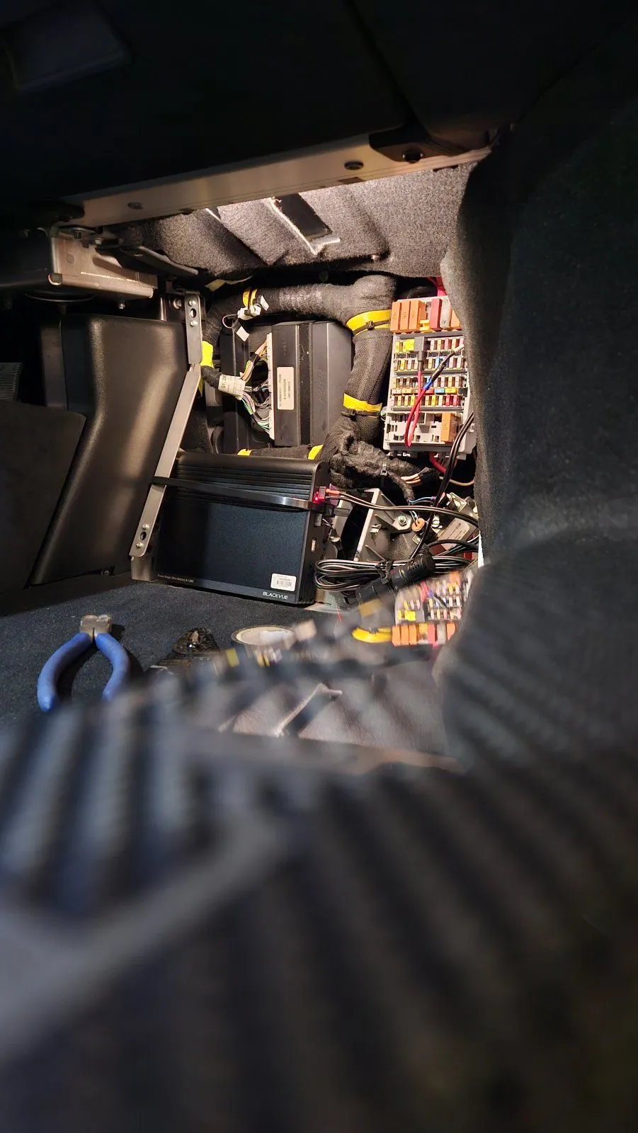

Yes, hardwired with a fuse tap! I run the Blackvue B-130X battery backup for parking mode, so no worries there. The cam is powered 100% from the battery backup, which is tapped into a switched 12v fuse so it charges while the car is running.
Once I shut off the car, then the cam runs off the battery and a full charge (takes ~20 minutes to charge up from 0%) will run parking mode for ~30 hours or so. Once the battery back up is depleted, the camera will shut off.

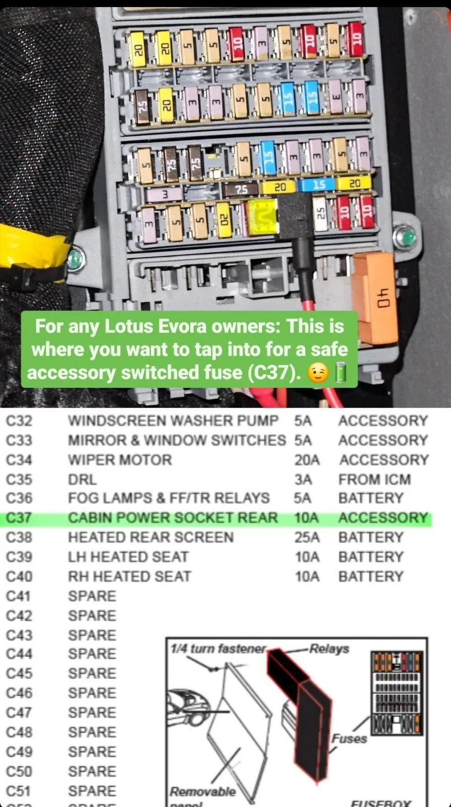

And here's where I tapped.. Might be the same for the Emira, but double check:
Thanks for the details and pics, looks like a nice clean install. So sounds like it's good for overnight but maybe not 2 overnights. And while its in parking mode, does it notify you of "activity?" If so, by what means? I'm considering that when I'm parked in a building parking garage, and upstairs, that there will be no signal that can possibly reach me. Also, is that the footwell on the passenger side? And can I assume trim needs to come off on the A-pillar and maybe top of the windshield? (Sorry so many questions, dashcam newbie here). :)
I actually like how mine turns out as I can see the status light since I had the notification volume down low.
You can access the live feed via wifi (useful when parked at home) or purchase a LTE model and pay for live cloud feed subscription. I assume the battery would work for 2 nights but I've never left my car overnight for longer than a single night without driving it and recharging the battery. The BlackVue app has a battery monitor too.
And yes, that's the passenger footwell. Same location as the Emira. It's under a metal kick plate that's easily removed. No trim came off. The headliner pulls down just enough to tuck the wire and so does the A pillar. Then you can just feed it behind the glove box down to the footwell.

You have to hardwire to the fusebox in the footwell to get any kind of parking recording as the USB port in the mirror housing shuts off along with the car.
