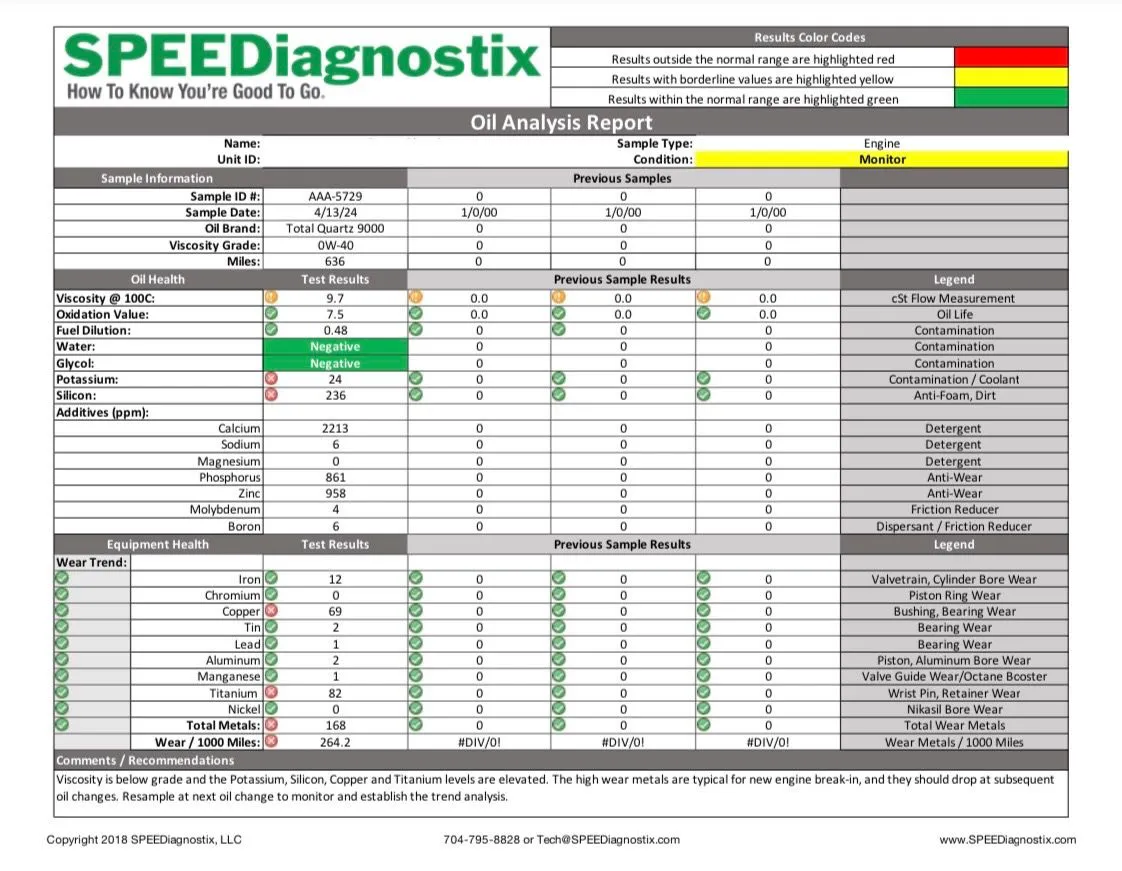

Here’s a UOA of the factory oil:

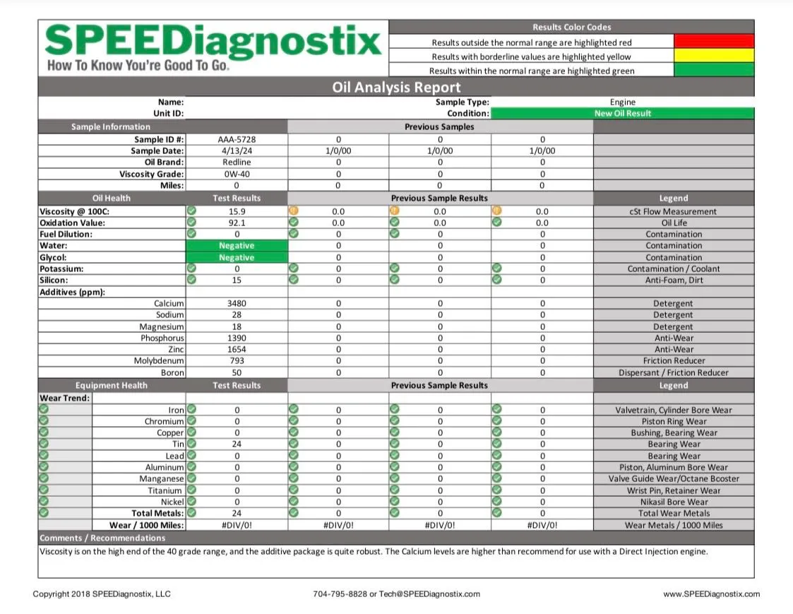

And here’s a VOA of the RedLine oil I used:
Notice the OEM oil viscosity grade is lower than expected. Range for 0W40 weight oil is 12.5 - 16.2 mm²/s.
You can sure see the difference in the quality of protection the Redline oil provides. It's more expensive, but it delivers.

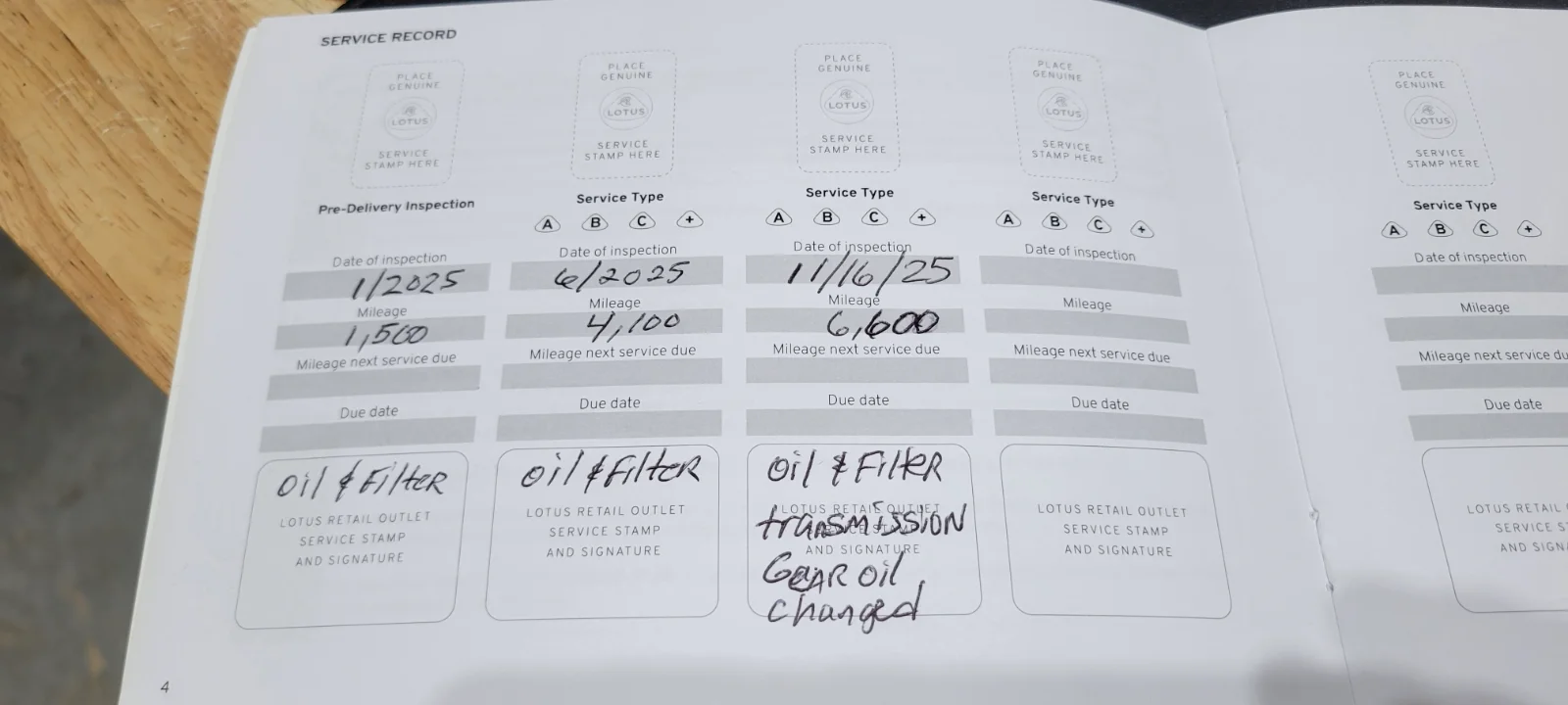

Did mine around 1,400. Dealer had no issue at all doing it, and said the GM did the same with his. $300.

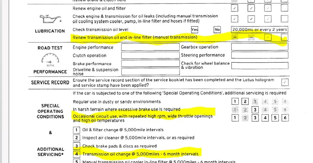

I did mine at 1100. Just worked out that way. Always a good idea to get that factory oil out after the first 1k. Been wrenching on my own cars since 72 and was taught that by several veteran mechanics. Changing out the gear box oil is a good idea as well. I've done the 1k oil change on every new car I've owned. Manufacturer recommendations are usually the minimal and do not necessarily reflect real life driving.
I've done 3, and the manual transmission fluid --- it's easy enough to keep it fresh. (DIY only)
