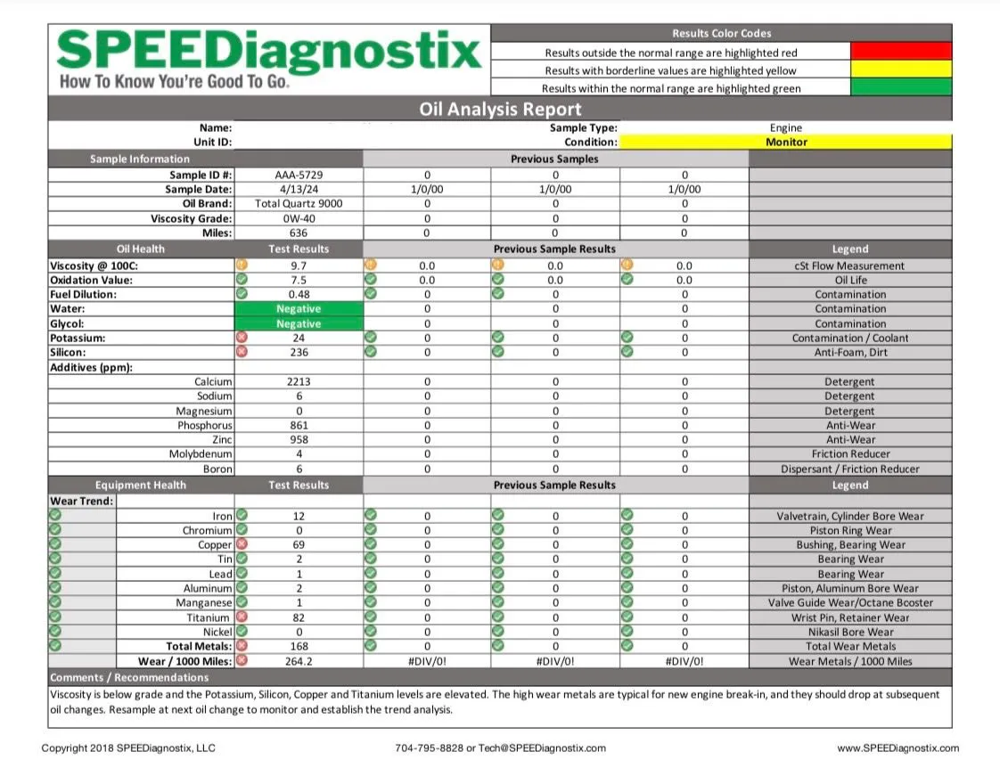

I did the first one at 600, about to do a 2nd one at 1000ish. From there every 3000.

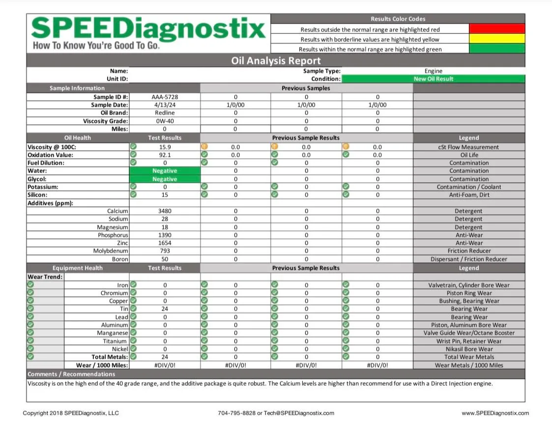

Used 6qts of RedLine 0w40, Amsoil oil filter and a HPS magnetic drain plug with OEM Toyota washer.
Here’s a UOA of the factory oil:
And here’s a VOA of the RedLine oil I used:
Notice the OEM oil viscosity grade is lower than expected. Range for 0W40 weight oil is 12.5 - 16.2 mm²/s.
Does this mean I should do the first oil change at 600 miles?
