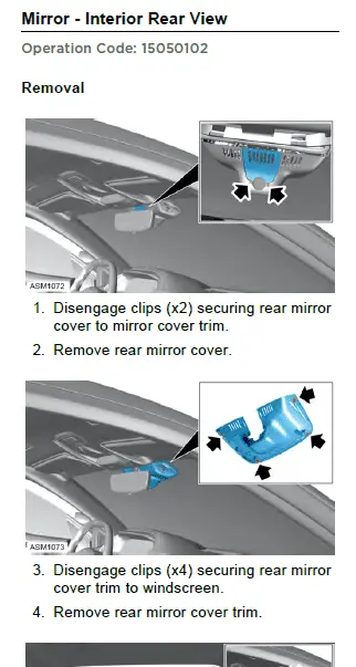

I tried to pull off the cover, to wire tap but luck too chicken to pull hard.
If someone figures out how to remove the cover please let me know

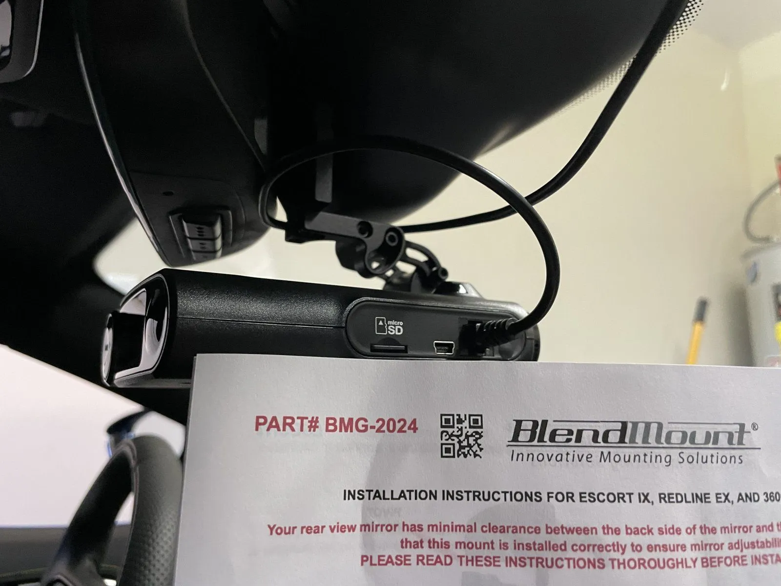

BMG-2024 works with Escort Maxcam360c
Does the Escort get enough juice from the USB jack or is it hardwired to a 12v source? Possible to get a couple more pics of the instill from different angles? How happy are you with the Escort Maxcam 360c? I've always been a Valentine 1 user but having one unit to provide dashcam and radar detection has a lot of appeal. Many thanks for your insights!
Just tried it and the USB by the rear view mirror did not have enough juice to power Maxcam360c

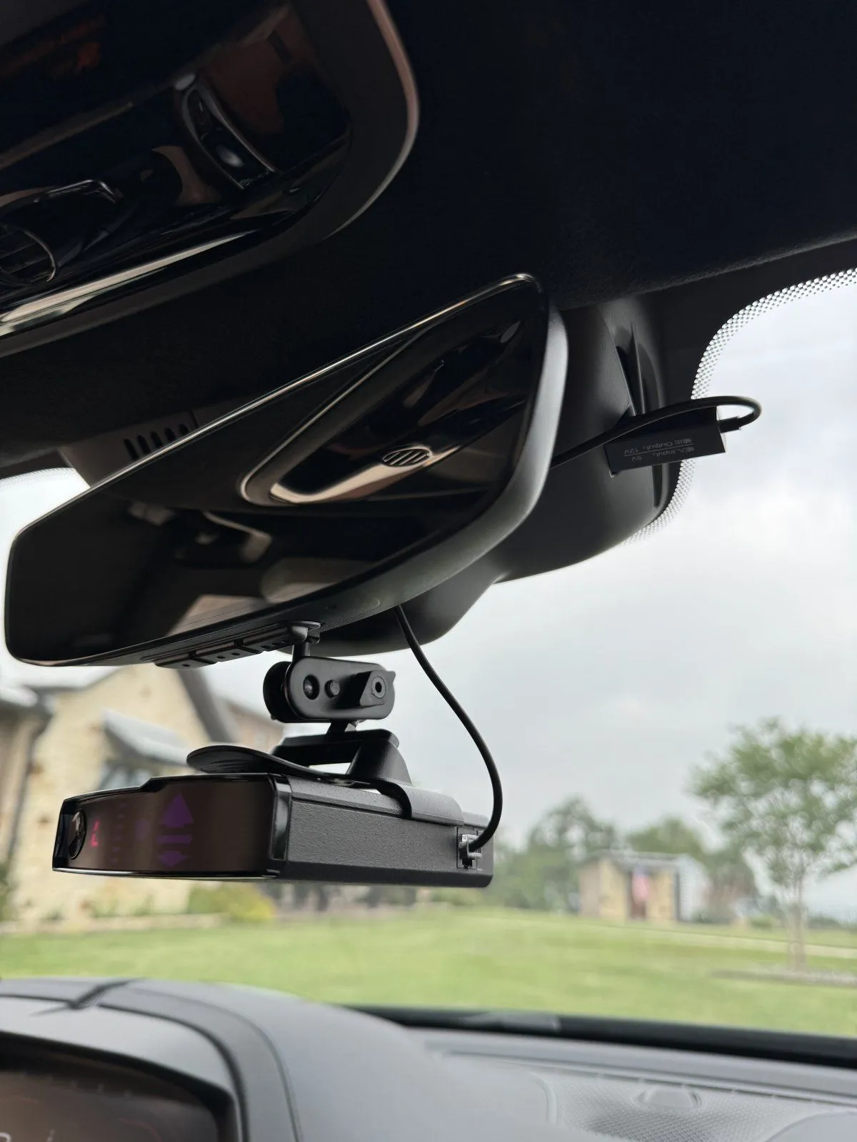

Luckily, I had an extra Mirror Mount and USB to RJ11 cable for my Gen2 Valentine V1 radar detector. The Mirror Mount is a tight fit and doesn't allow much rear-view mirror adjustment, but I was able to make it work with my seating position. My USB to RJ11 cable is 12'' long and works well. I zip-tied the little bit of extra cable to the mirror mount to help hide the wire as much as possible. I will post some photos later today. Links below to the products I used.

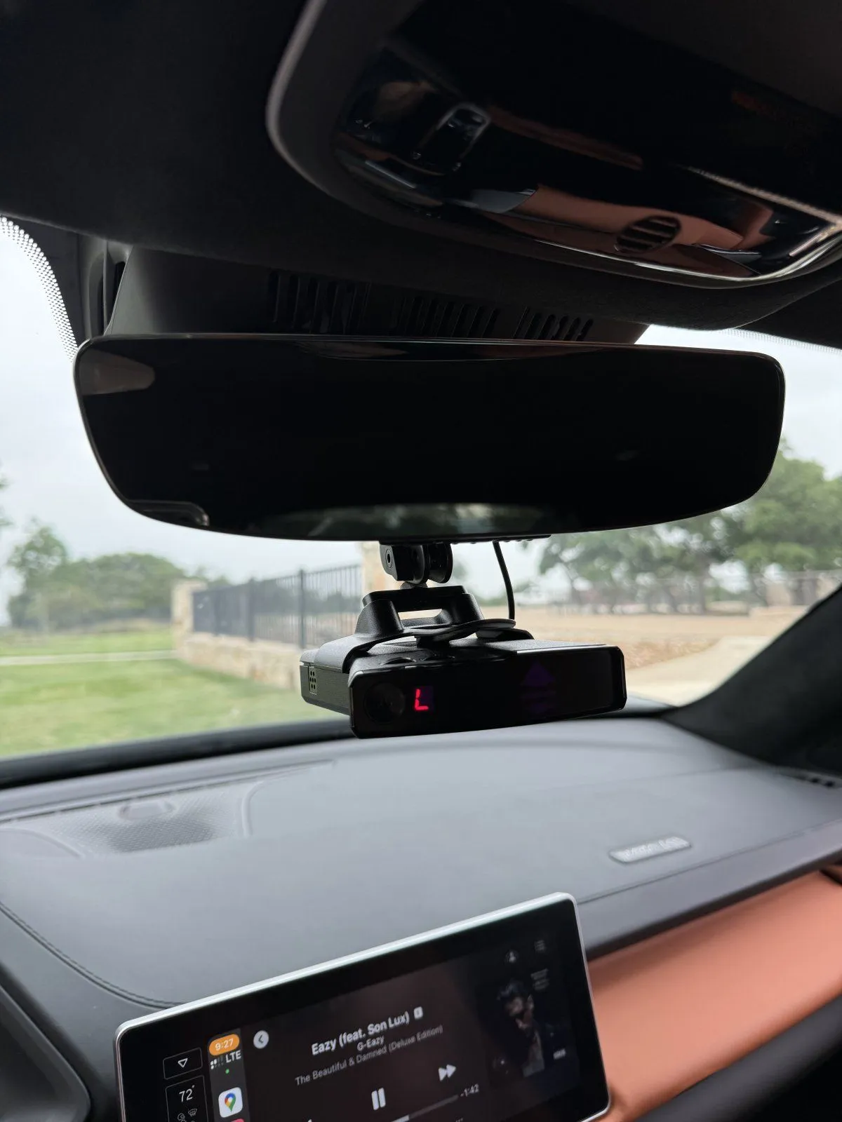

I bought this Blendmount model for the Emira in June and it is working fine: BR7-2024.
I use it with the Uniden R8. There is a bit of vibration noise coming from that area. However, after some investigation, I have figured out that the noise is coming from the R8 itself, possibly from the buttons.
