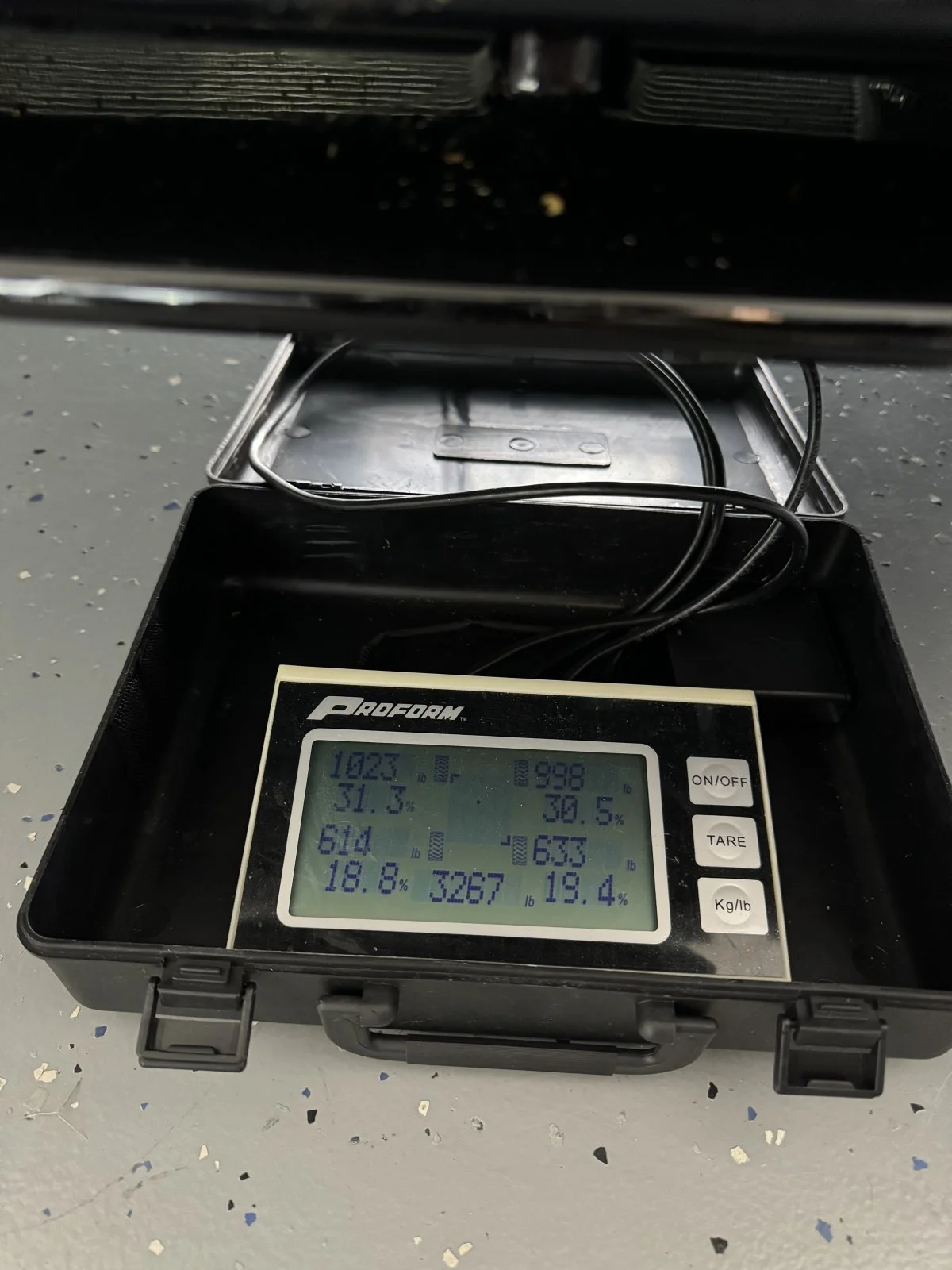

The total weight with a full gas tank and all the above modifications is 3,267 lbs.
More mods are coming soon, and then it will go back on the scales!

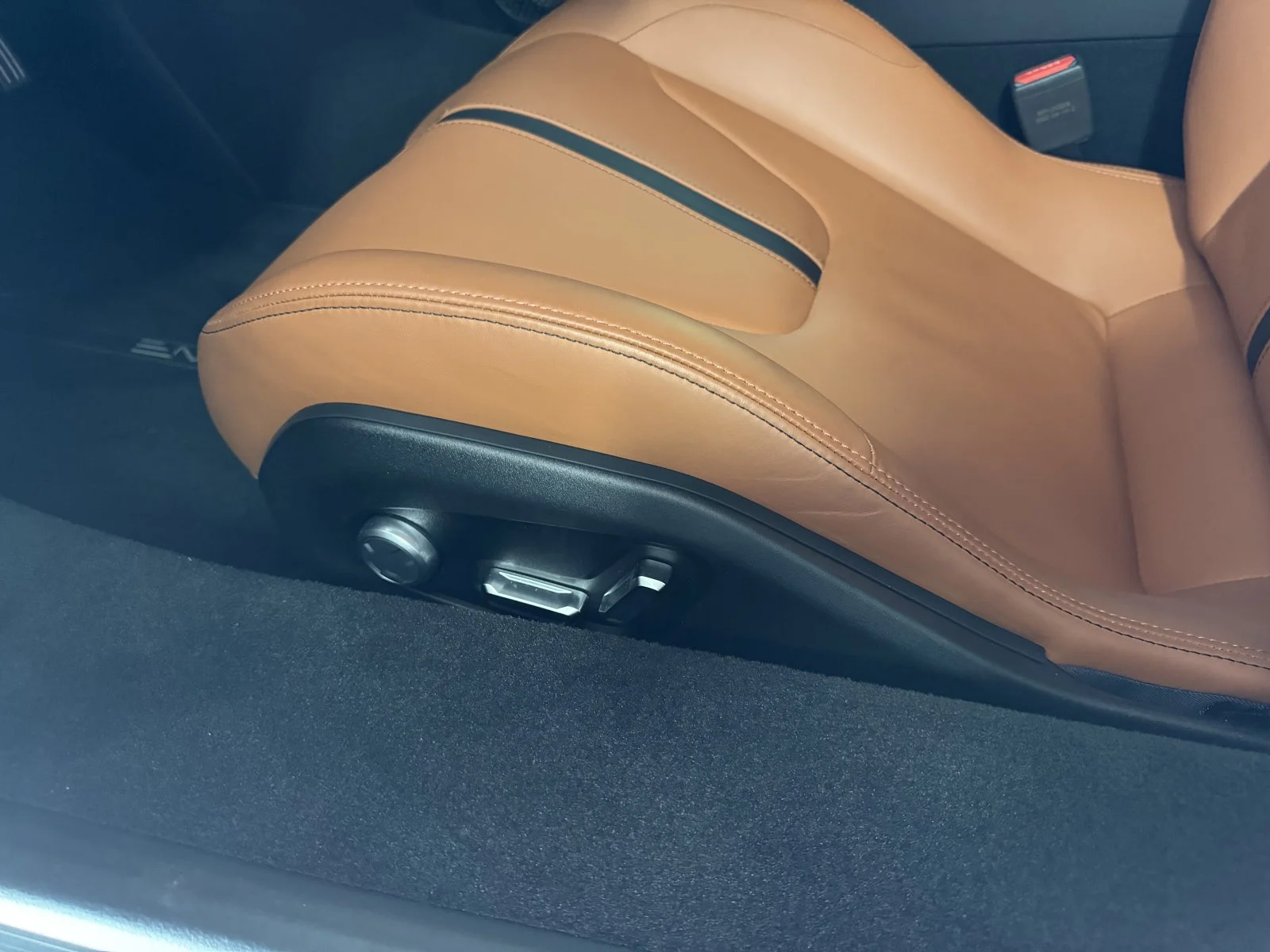

Do you have a leather or Alcantara interior?
Yours and mine have the same factory build, so your stock weight of the car has to be the correct one then. I can't seem to find anyone near where I live that has an actual corner balancing weight scale system.

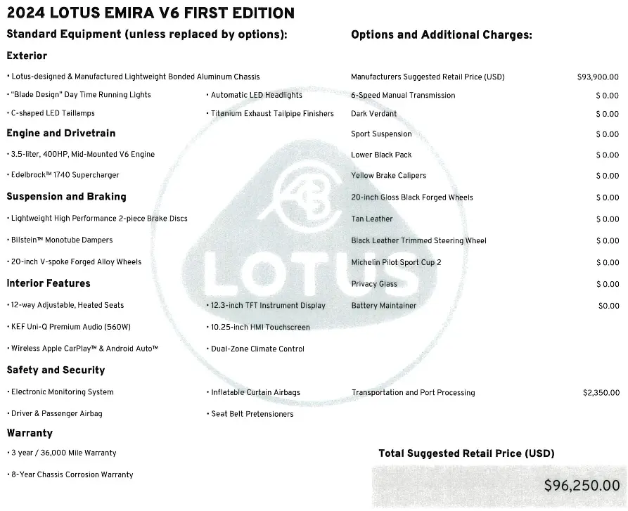

I just updated my first post with an image of my window sticker so you can see the exact build.
Ah you have the Sport suspension with the Cup2's. I have Touring with Goodyears. I wonder what the weight difference is between the two tires.

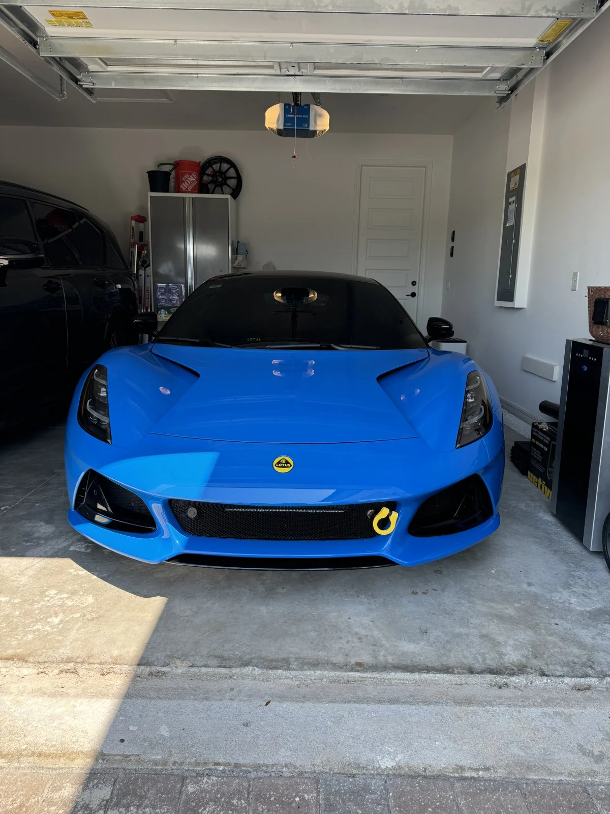

I bought the same version of ZL1 tow hook, I wanted to ask when you installed the ZL1 tow hook, when FULLY tighten, does the tow hook sit straight? Or did you have to loosen up to make it straight?
I just installed mine and it’s slight off and could potentially block the parking sensor… and when loosen it to make it straight and it became not sturdy enough.

Did you tighten it by hand? It looks like you only need about a 1/4 of a turn to get it square. Maybe use a short wooden dowel to help you turn it enough to get it square if needed.
I tighten it as much as I could by hand and then I used a bar insert it into the hook to further tighten it, and its not going any further.
So I feel like the one I received it’s just now thread it properly from the manufacture so that’s why it’s crooked. I noticed other ZL1 products has an adjustable nut that would allow you to make it straight. Honestly I wish this one has that feature it would be so much easier…
I contacted Greg and I might get an exchange to a different type of tow hook.
Hmm, I guess when the threaded bung was welded into the car, it could have been clocked differently. That or, the rod was off when they machined the tow hook. You could try adding a good amount of thread-seal tape to the threads to see if that would help clock it correctly, or maybe add a nut to it; that way, it acts as a stop.
