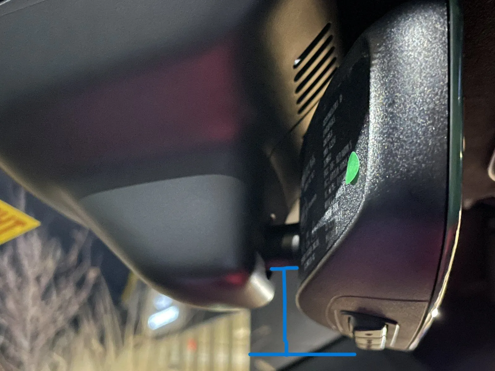

Need a picture of the mirror from the Passenger Side, side view, like example below?
And if possible the measurement from the bottom of the mirror stem to the bottom of the mirror? (see attachment)

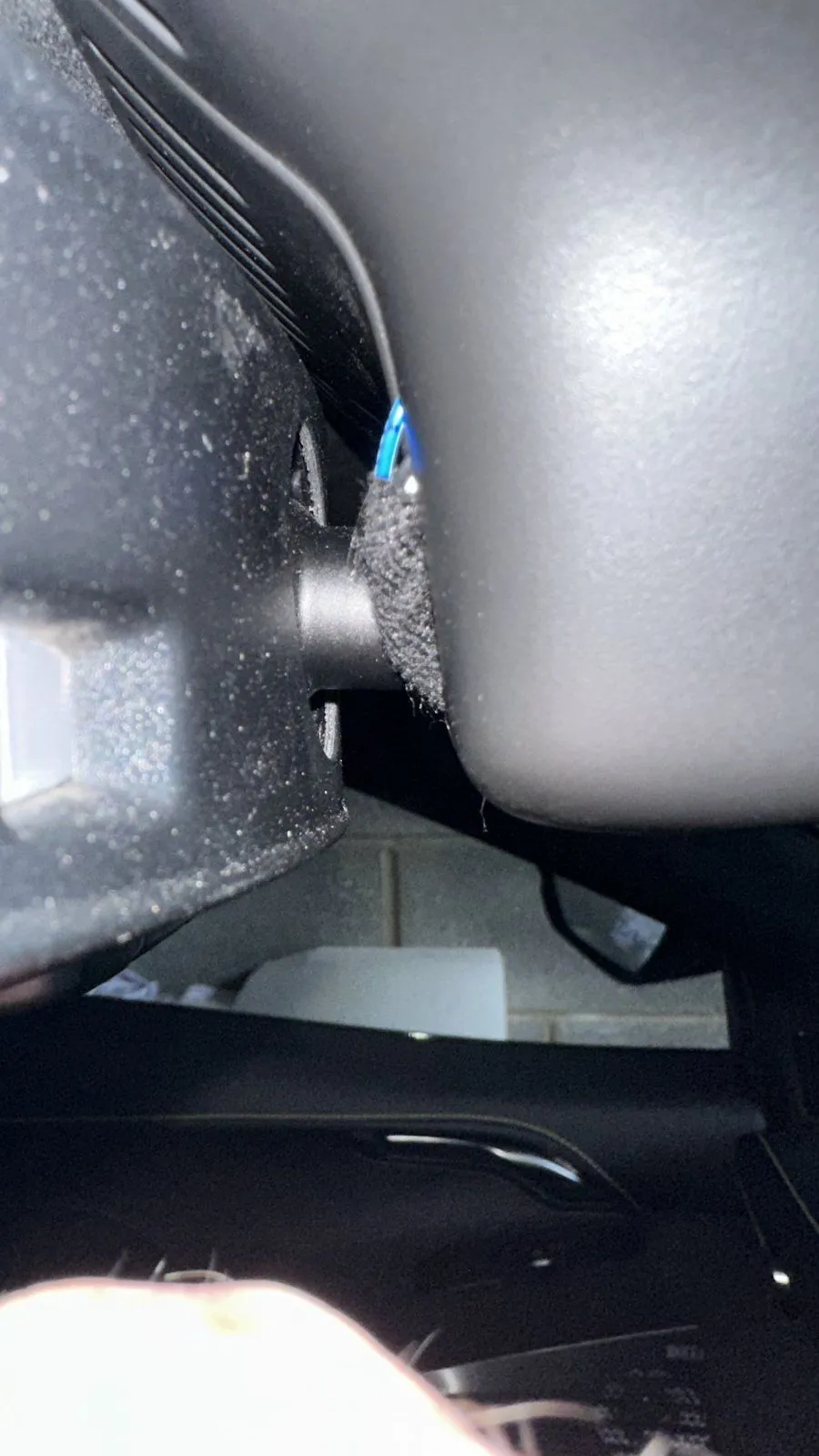

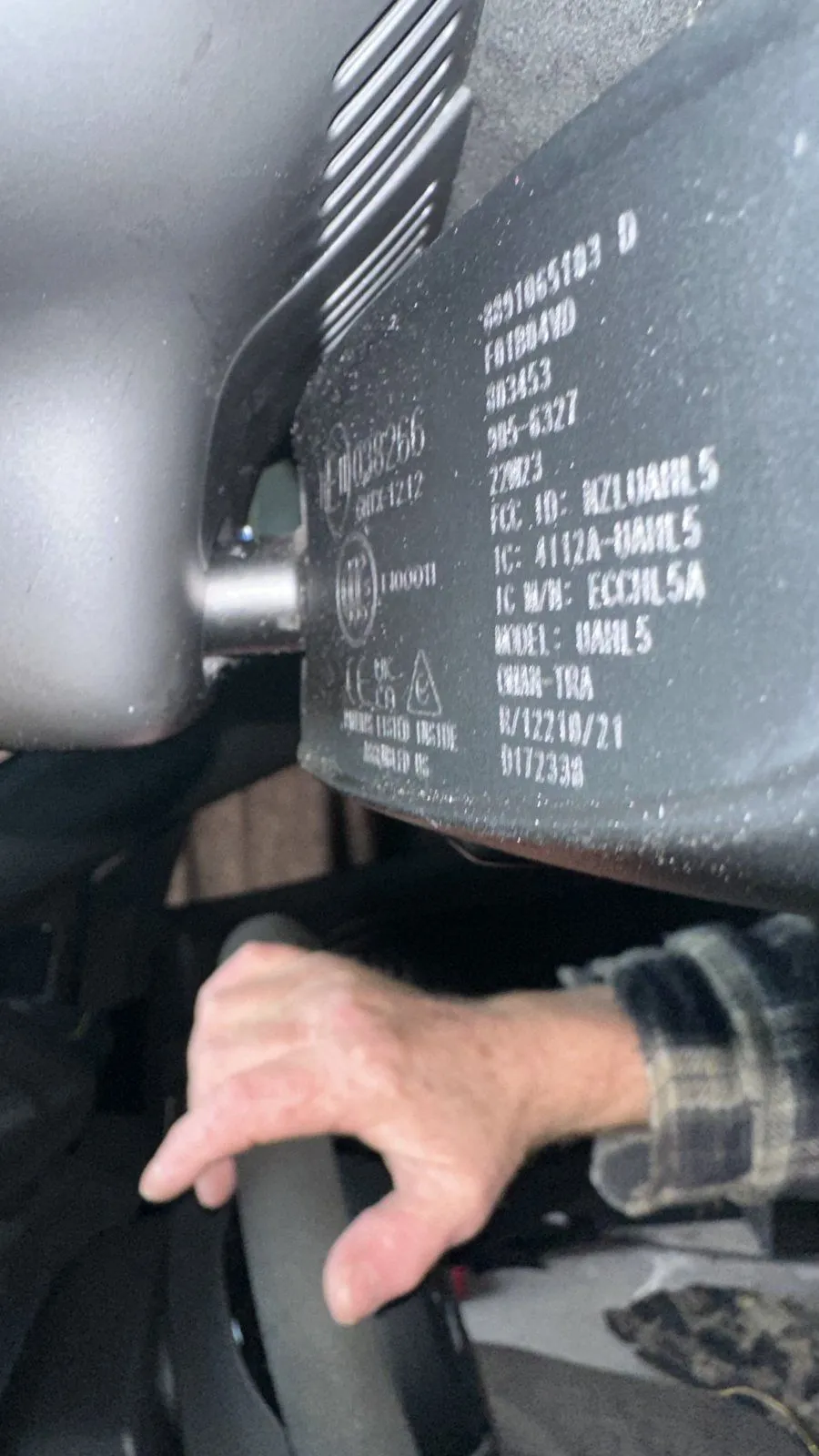

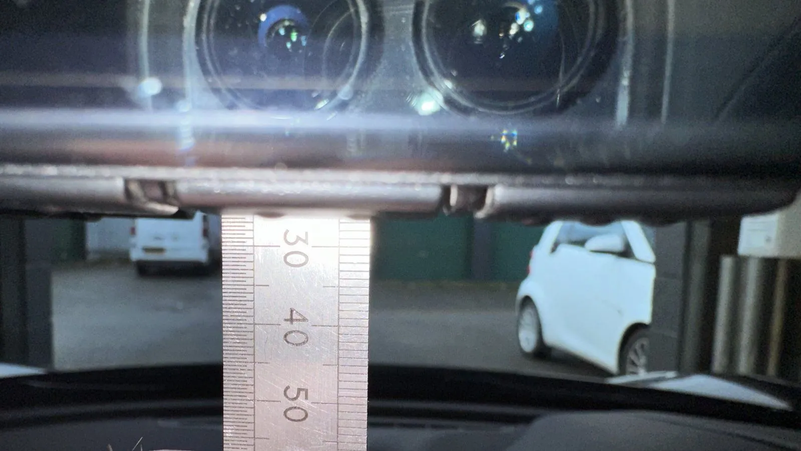

OK,
The stem, is 17mm diameter. The usable area of the stem that you could realistically clamp onto (whilst still being able to move the mirror) is only really about 10mm, 12 max, any more would foul the swivelling of the ball joint mount.
The distance from the bottom of the stem, to the bottom of the mirror, (or mirror buttons in my case, a I have the integrated homelink thing, that I cant get to work), as per your diagram, is 27mm.
Interestingly, on close inspection to measure this, I noticed that I have a couple of wires bulging out from the trim, so need to address this.

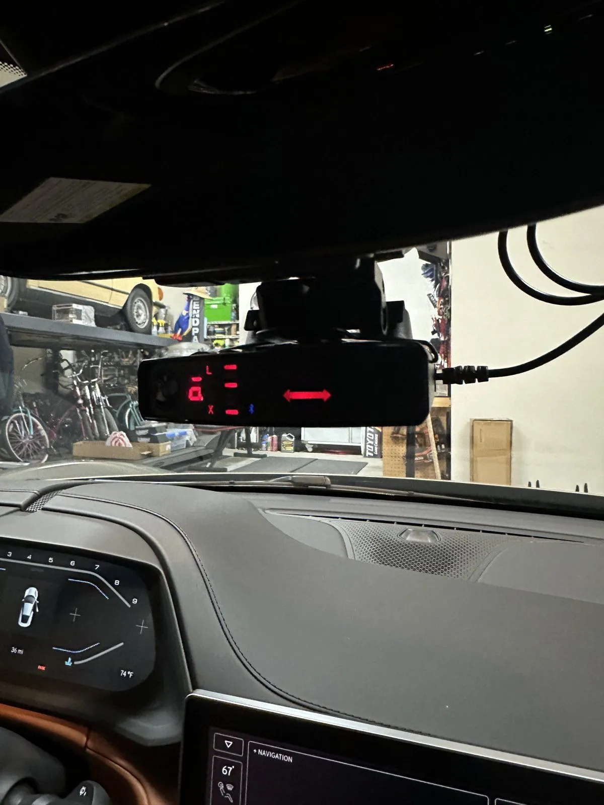

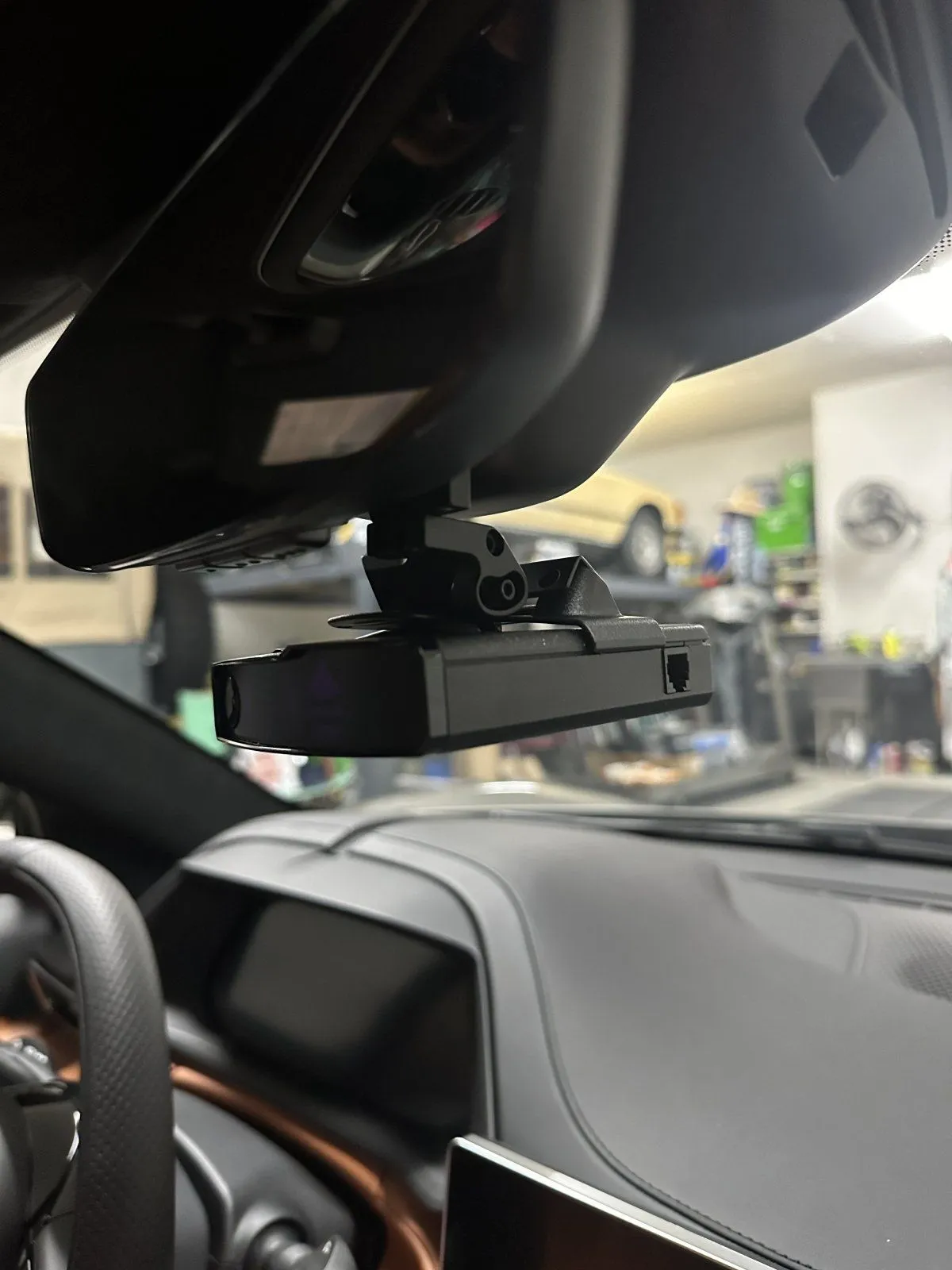

It works !!!
The v1 needs 12v so I think I’ll be forced to wire tap. A lot of the cables like the one posted have reviews of not providing sufficient power for the V1

It works !!!
My V1 2nd gen has no issue with the cable. Above your picture on the same side I see the usb hole it’s a straight shot and your not tapping into any cords.

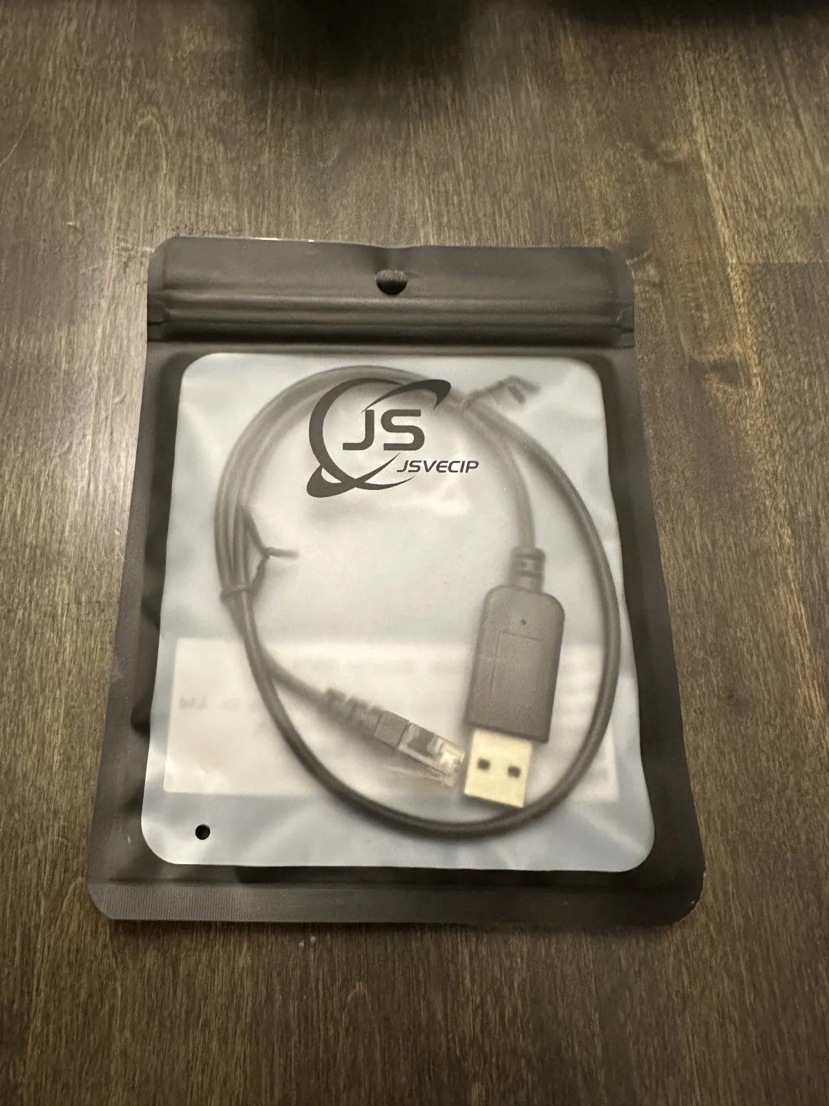

Ordered the cable , didn’t work for me
Radar didn’t get enough power

I tried to pull off the cover, to wire tap but luck too chicken to pull hard.
If someone figures out how to remove the cover please let me know
So strange, just powered my V1 2.0 and did the most resent update while plugged into usb without any issue. Do you have the one that works with 12V? Plus look for any that says Note: This USB RJ11 Radar Detector Cable is not suitable for Valentine One radar detector. Good luck. What blend mount model number. Try this one:
