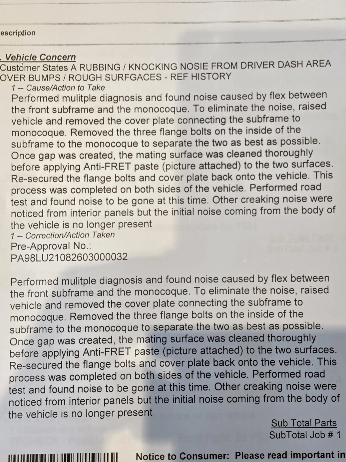

Got it booked in to have another look at this front end creaking that was happening this time last year. It only happens when it's hot enough. Car is now out of warranty but I reported the problem before it expired. Fingers crossed Lotus agree to cover it. Hopefully we can find the cause this time around. 🤞 Video for those who are curious is attached. I can feel it coming through the cabin.
This procedure totally fixed the creaking I was getting on my I4 and I’m pretty sure the front structure is identical to the V6. Sounded like it was coming from inside the dash, sort of to the right and left side, would hear it on bigger bumps. My car was 23 production, I’m pretty sure they all do this to some extent if nothing has been applied in that area.

Mine is in for its annual service and to investigate a clicking/creaking noise from the front (sounds like a dashboard creak). The creaking has been acknowledged , apparently it is coming from the front subframe. They have told me they will renew the subframe bolts and clean the threaded sections.

Sounds like pretty much what they did on mine. Please share the results, in the thread on the subject: https://www.emiraforum.com/threads/dash-chassis-creaking-sounds-fixed-by-galpin-dealer-tech.7802/

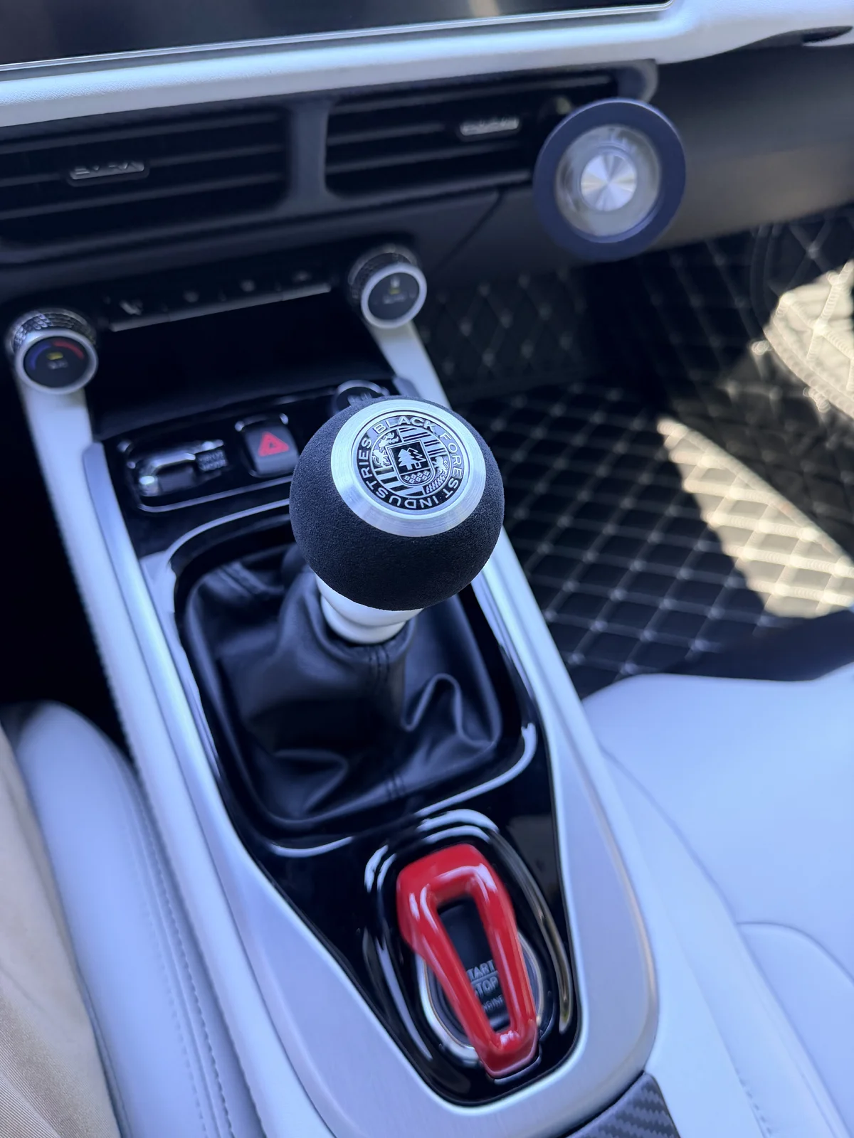

New BFI shifter knobs installed last week. Drove around with the new knob and really enjoyed this so far.

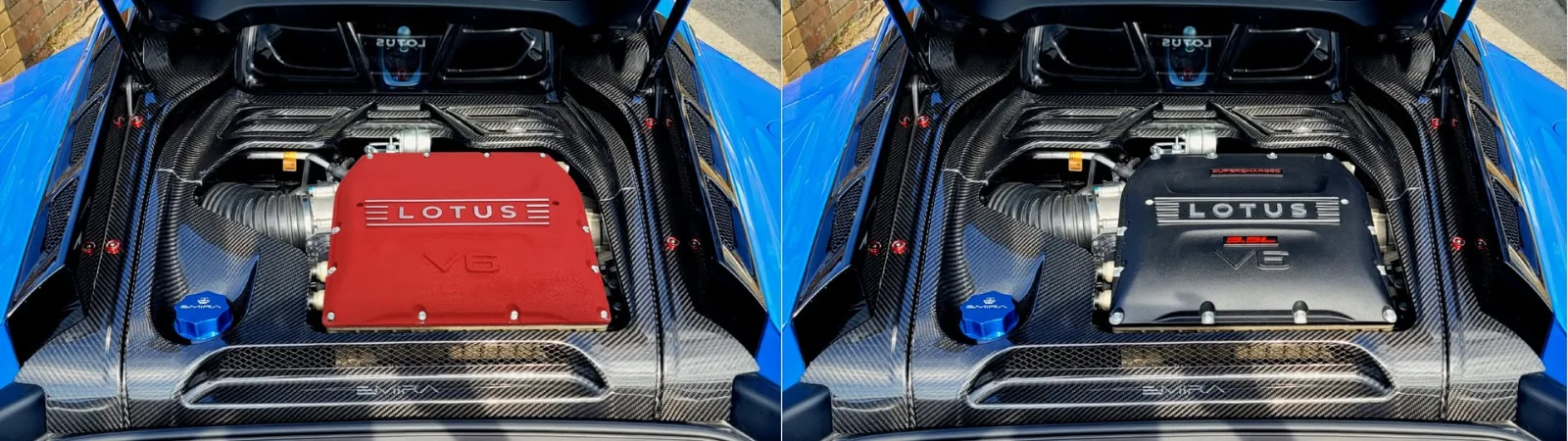

Thought I'd paint my supercharger in red crackle, but I don't think I like it. It's a spare one, so was just for a test. Maybe I'll gloss red instead, what do you all think
