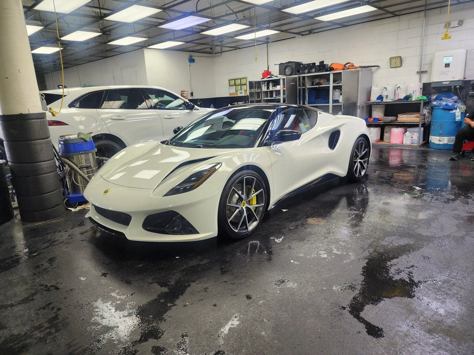

I was lucky enough to pick up my emira today and looking to PPF it on Monday. I found a place near Northridge called MAGIC WRAPZ. Yelp review looked great so I called and got quoted for $3800 full PPF with xpel. I don't know if this place is safe to give it a shot since the price is half of what others are quoted for. I haven't done PPF on any of my vehicles and curious what experienced lotus members would recommend. Please let me know what you think.

That’s an absurd good deal if done right. We would need several pics of close ups around the corners, bumpers and intricate areas
I’d be surprised if paint correction is included in that quote. I wouldn’t put PPF on without doing paint correction first.
My last 2 cars didn’t have any paint correction done before ppf and it looked great. I suppose it all depends on how good or bad the paint looks upon delivery. I’m very interested to hear how magic wrapz turns out as most other places will be double that. Also how much Elite clear and PFS are charging for their work. I haven’t looked this time around but years ago Xpel had a lot more installers in so cal than Stek. I personally will not use Xpel again. Hopefully there are a decent amount of installers familiar with its use as in the end the installer is just as important as the product itself.
