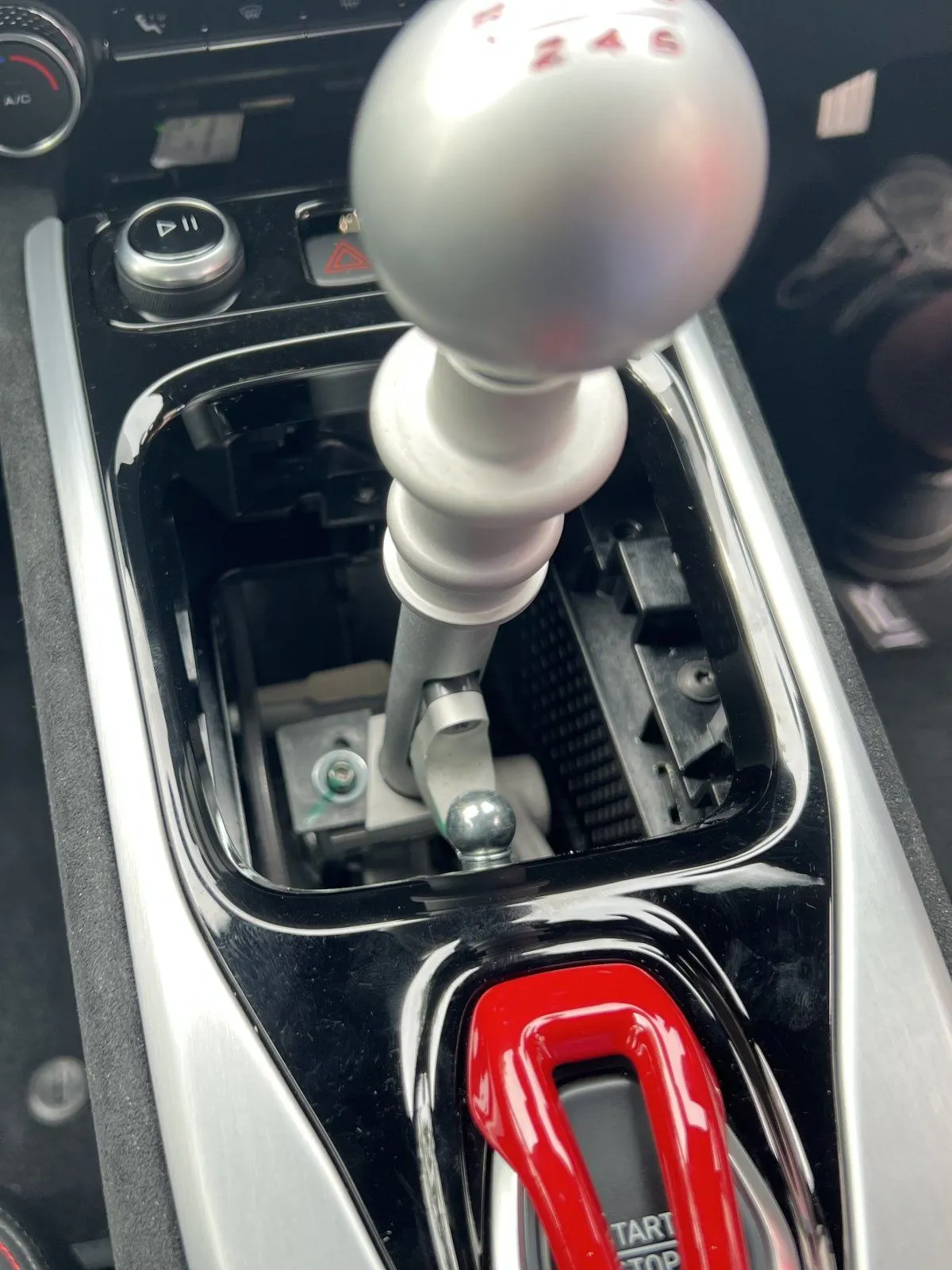

Do both plastic structure "rings" below the sill fit within the height of the Alcantara side trim? Trying to figure out whether the structure here is removable using the screws visible in your photo:
Hard to tell without starting to dismantle it.
The service notes suggest it’s not straightforward and I’m afraid the standard setup doesn’t offend me enough to start down that road.

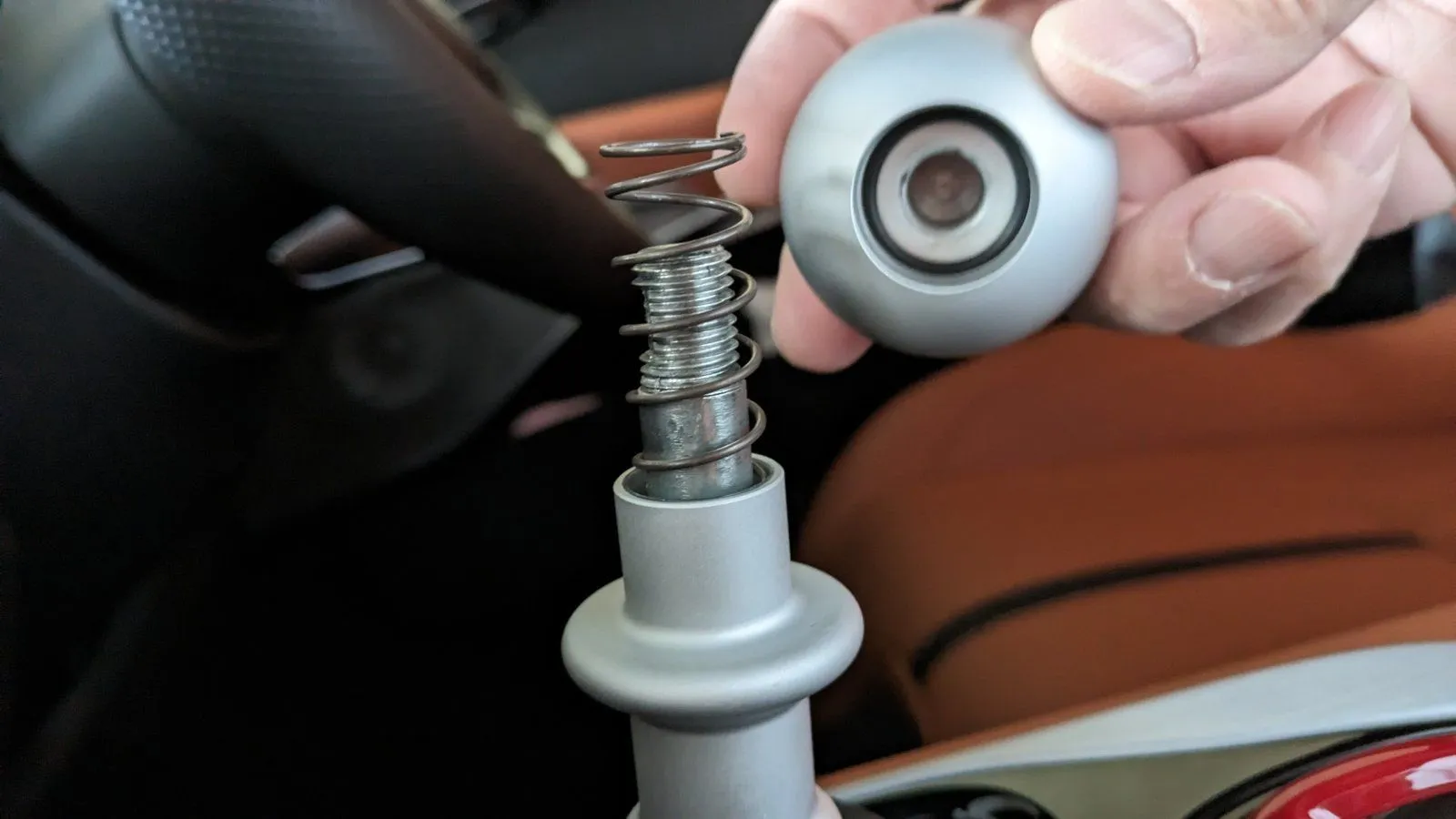

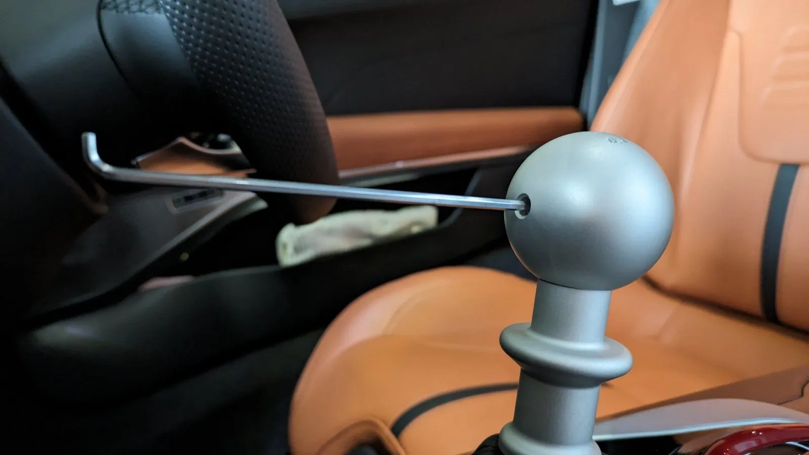

Pictures tell the story:
The knob is under tension from the spring, so don't let it get away from you as you unscrew it.

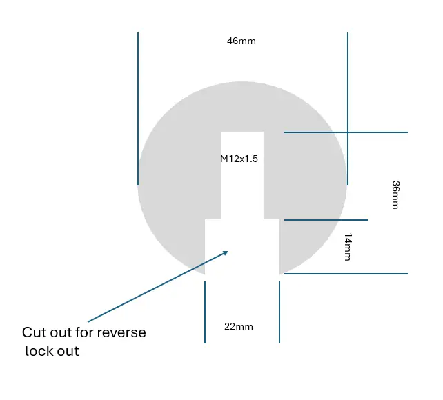

@B r I a n did you already take measurements of the knob with the relief on the underside? If not I will pop mine off and use my trusty calipers, and do a dimensional sketch.
I am considering having something made too.
Yes, please do. I've already been looking into making one, and there are pre-made machined inserts that you can buy that are already threaded. Just need the sizing and thread pitch.
Better to await Porter's sizing confirmation to be on the safe side, but I'm pretty confident that it's going to be 12mm 1.5 pitch. Equally important i think, will be to also match the knob's underside cavity in terms of diameter and depth to allow for proper operation of the pull up reverse lever.
That's what I mean for the dimensional sketch... the inset for the reverse lockout ring. I think it's already understood to be a 12x1.5 thread.

Cheesy Powerpoint sketch, but here are the numbers. 99.9% sure on the pitch of 1.5. i know it isn't 1.25
Good job and thanks for working on this. In your sketch, however, you didn't include the side lock-in grub screw, which I presume was intentional. Hopefully, that's only an additional, albeit unnecessary, securing feature of the OEM knob. Its deletion on the wood replacement knob would, of course, result in a more desirable an all-around smoother surface.
Got any information on the grub screw dimensions?
Unfortunately I don't have the spec for that grub screw, but I do seem to recall having reading somewhere that its removal was done with a 3mm allen wrench.
