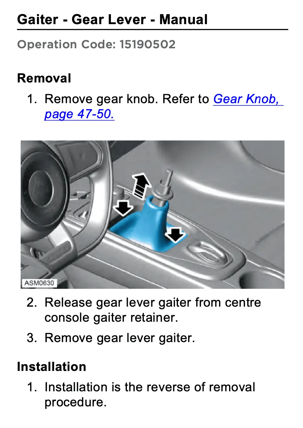

boys, does anyone have a clue how to remove the shifter boot? I want to replace it with alcantara cloth with yellow stitching. im not brave enough to go for a DIY try and error disassembly :rolleyes:
Not a whole lot of detail on how to "release gear lever gaiter from center console gaiter retainer". Sounds like you have to press down to unclip it then remove?
I can already hear the plastic clips breaking. 😬

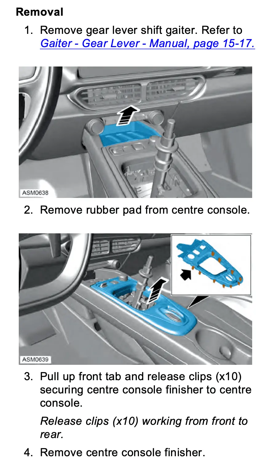

A better approach would be to maybe remove the shifter assembly cover and peak under there to see how it's clipped in. A simple plastic spudge tool should be all you need to unclip the 10 clips and take a look under the trim piece.
I think these procedures are written for Lotus mechanics. Simply stating to "Release clips (x10 working from front to rear is bound to result in frustration if clips start breaking. This is why I would add notes where necessary to factory service or owner's manuals.
Had a go at this today as @kitkat suggested, and found the gaiter is screwed on from below.
So don’t try to push it down from above.
The manual is misleading about this, as I’ve found about a few things while I’ve been fiddling around.
eg: the start button is installed from above the panel and not fixed below like suggested in the manual. Mine appears to have been bodged at build with a broken clip to make it fit.

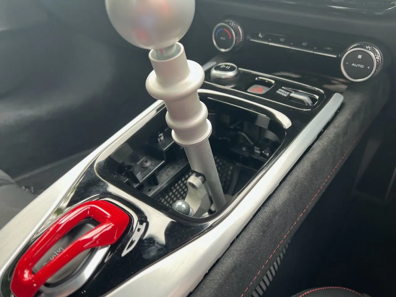

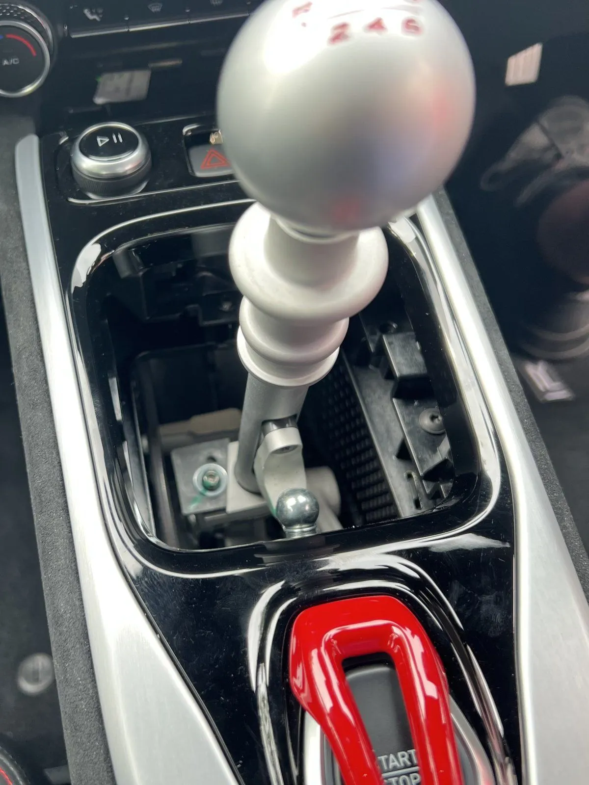

Had to take the gaiter off today as the leather had come loose from the cable tie (!) holding it on.
Here’s what it looks like removed. You can see quite a mess of stuff.
It would need something (3D printed?) to hide all that if you wanted to run without it.

Finally! We finally have a picture. After what, a year of these being in the road? Well done KJD, many thanks for this.
Re: a trim cover... maybe a leather ring similar to the boot would work? Could use the existing boot affixing locations and simply invert it, affixing with adhesive or double sided tape around the bottom of the plastic structure.
Is all of the plastic structure necessary? Or can the lower section be removed along with the mesh safety screens?
Would honestly look sort of silly as a big gaping hole even if finished.
I think it is unfortunately. It supports the Alcantara “flyover” bit.
