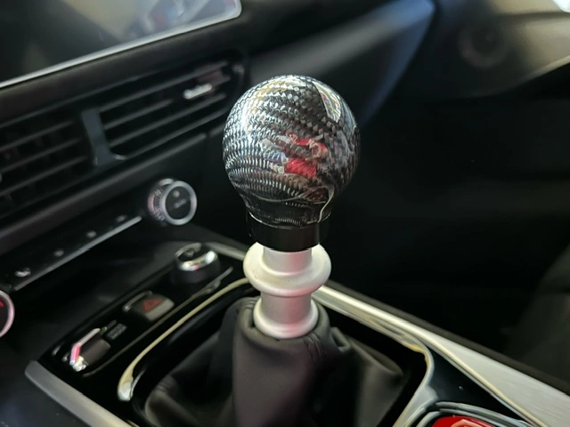

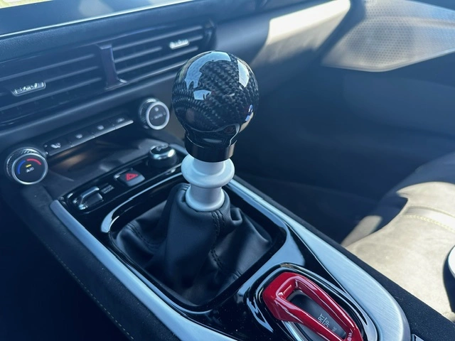

Ok, got this installed. In general, i like it. a little bigger than stock, a little heavier as well. I need to drop it down about 1/4-1/2" or so to be a little better height. this one does NOT have a grub or positioning screw. just threaded it all the way on.
the grub screw is only to keep the knob oriented with the shift pattern, so if you are going with a blank, it doesn't really matter. it's a 2mm head I believe.

How will you go about dropping it? Are you planing on cutting the reverse pull-up lever or drilling a deeper thread in to the knob?
Drilling into the knob to let the threads go deeper

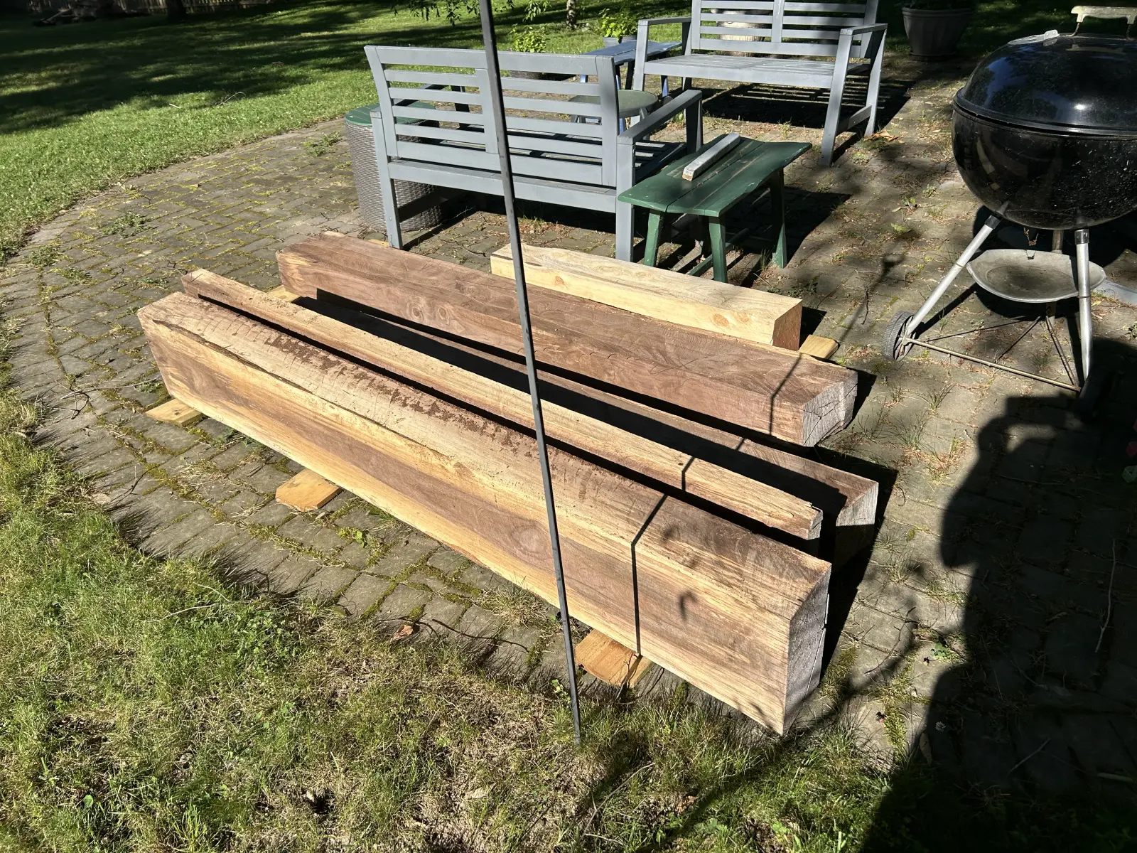

Step 1: complete - mill some wood.
OEM Knob is 1 - 3/4 inch diameter
I think I want to go 2 inch or 2-1/4 diameter
Step 2: Let wood dry out - then plane down

For anyone thinking of making their own from wood, unless you are already a woodturner, be prepared for a lot of swearing and firewood. Spheres are not easy.
A hard timber would be capable of being threaded directly without an insert. You just need a tap and tap wrench like you would for metal. I'm going to make an olive wood one in the Autumn (Fall) - I Had my own business for a few years until last year. I'll report back when I do one. I'll see if I can draw one in Fusion 360 before then.

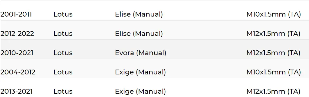

I checked out the link above and decided to reach out to them since I like one of their knobs.
This is the reply I received:
Unfortunately we do not offer products specific to the Emira platform, but that doesnt mean I can't help.
https://raceseng.com/products/shift-knob-adapter
You will need one of our adapters to run that shift knob. The link above will take you to our page. Also, these are the Lotus platforms we offer products for.
If you know the transmission is the same as one of the ones found above, then that may be the correct thread/pitch.

Have we already determined that the Emira is using the M12x1.5mm thread/Pitch? Same as the Evora?
