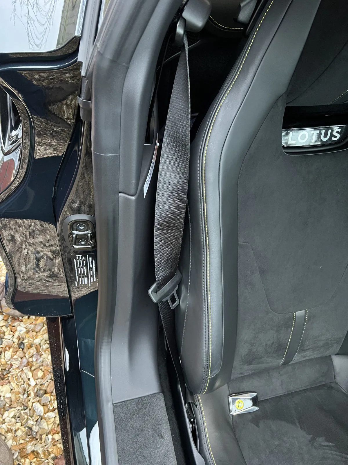

My only reason for raising was to this was to highlight that having a twisted belt appears to mean it is correctly installed. In my experience if the belt sits flush it is actually fitted on the wrong side of the car. Although that assumes the twists are the same as I have.
My previous assumption was that the seatbelt was installed correctly, and from your picture it doesn't appear that it is. If the end inside the B pillar has to be installed in the orientation in the photo, then that belt should be on the other side of the car. In order for the belt to lay properly in the photo, the top would have to be rotated 180° clockwise so the belt would lay flat across your body and not twist like that.
Lotus saying there's no way from visual inspection to tell which side they go on isn't true. You can tell by which direction the blade points. Coming up out of the B pillar and through the loop at the top, with the belt flat, the blade should be pointing inward towards the middle of the car. You shouldn't have to twist it around like it is in your photo.

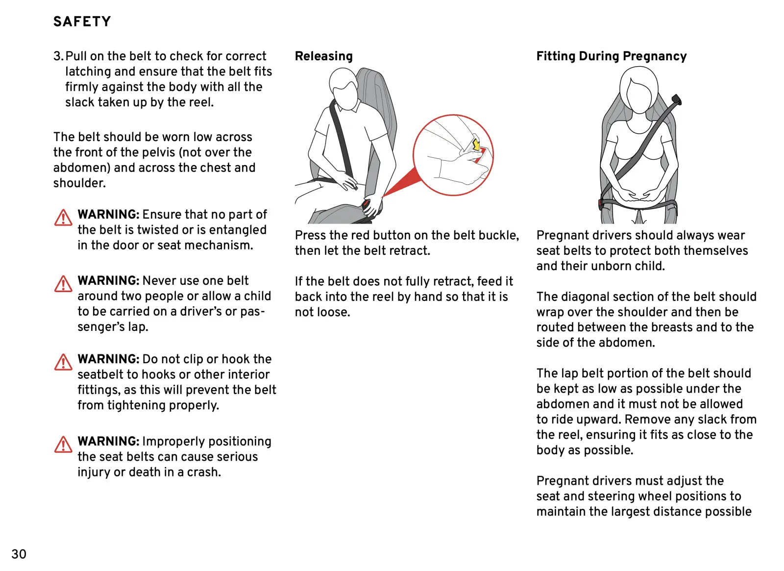

On page 30 of their own manual, it shows the way the belt is supposed to lay across the drawing of the woman, and it also clearly states in the first warning that the belt is not supposed to be twisted.

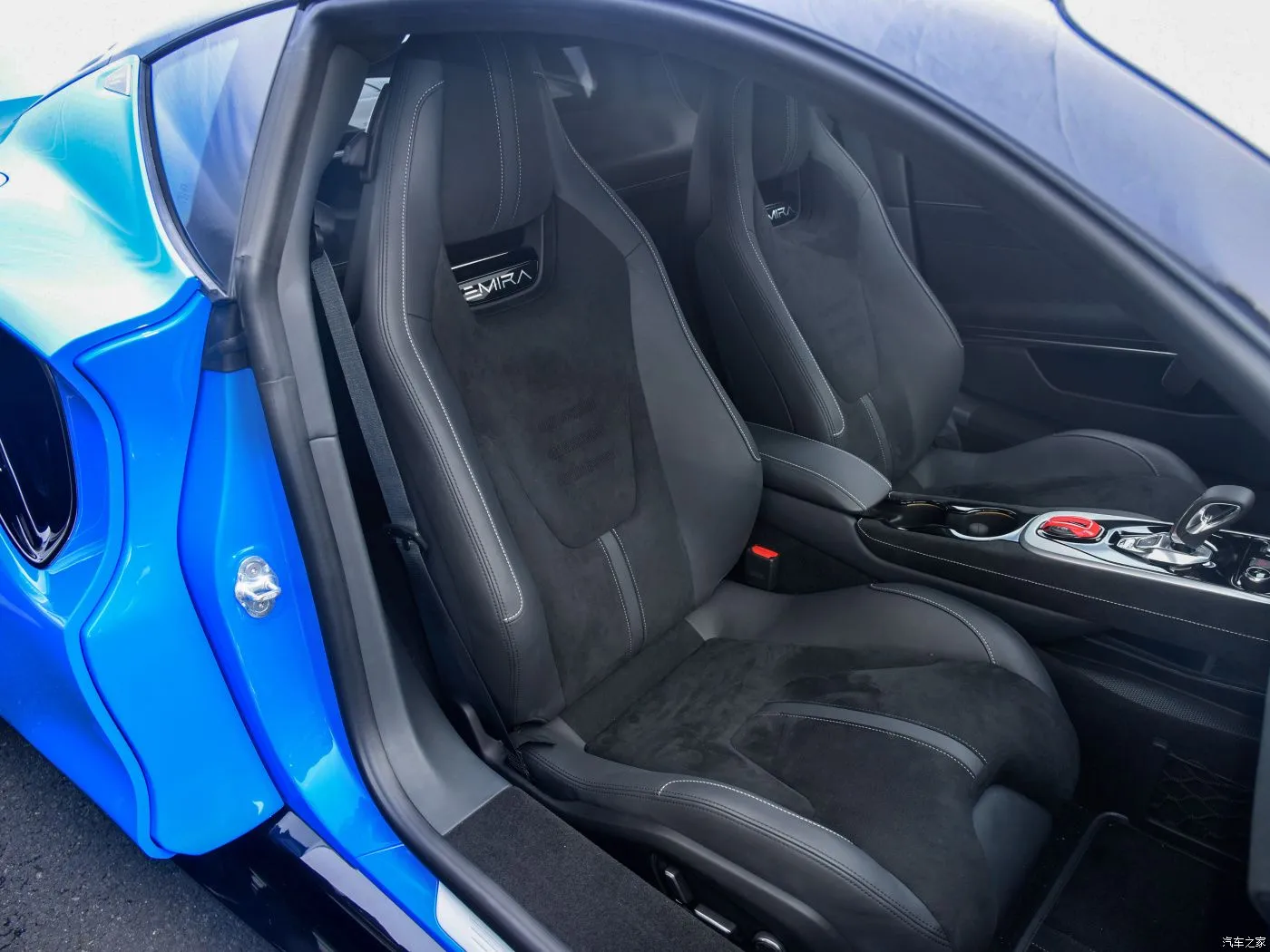

Here's another very clear picture of the full belt correctly installed on the correct side of the car. Flat coming up out of the B Pillar, flat all the way down to the seat, and the blade pointing towards the seat.

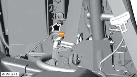

The twist vs. non twist thing has nothing to do with the side of the car the belt is installed on. In both cases it's coming down flat from a top pivot and bolts directly to the side of the seat frame.

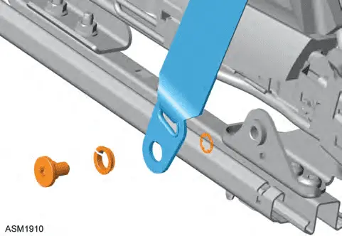

The twist is an installation issue in the factory, and it has nothing to do with the Left vs Right side. The metal mounting tab at the bottom of the belt is not "handed" left or right. See:
The issue that @duff is experiencing is a different one, related to the tensioning mechanism, and could very well be a left-vs-right install issue for the retracting/tensioning unit, but it almost certainly doesn't have anything to do with the seat belt webbing being twisted out past the upper B-pillar bracket. Seat belt tensioner function simply doesn't depend on the belt laying in a certain orientation at the fastener end.

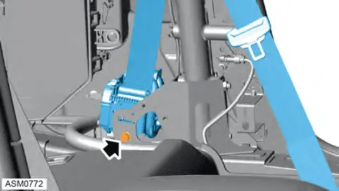

Here's how the tensioner mechanism mounts to the car:
What might be at play for @duff is an issue with the wiring harness connector where it plugs into the tensioner mechanism. I don't know what the failure mode is for the belt operation if electrical fails (or is unplugged)... it could be "ratchet retract and hold". Or it could be some other kind of electrical gremlin.

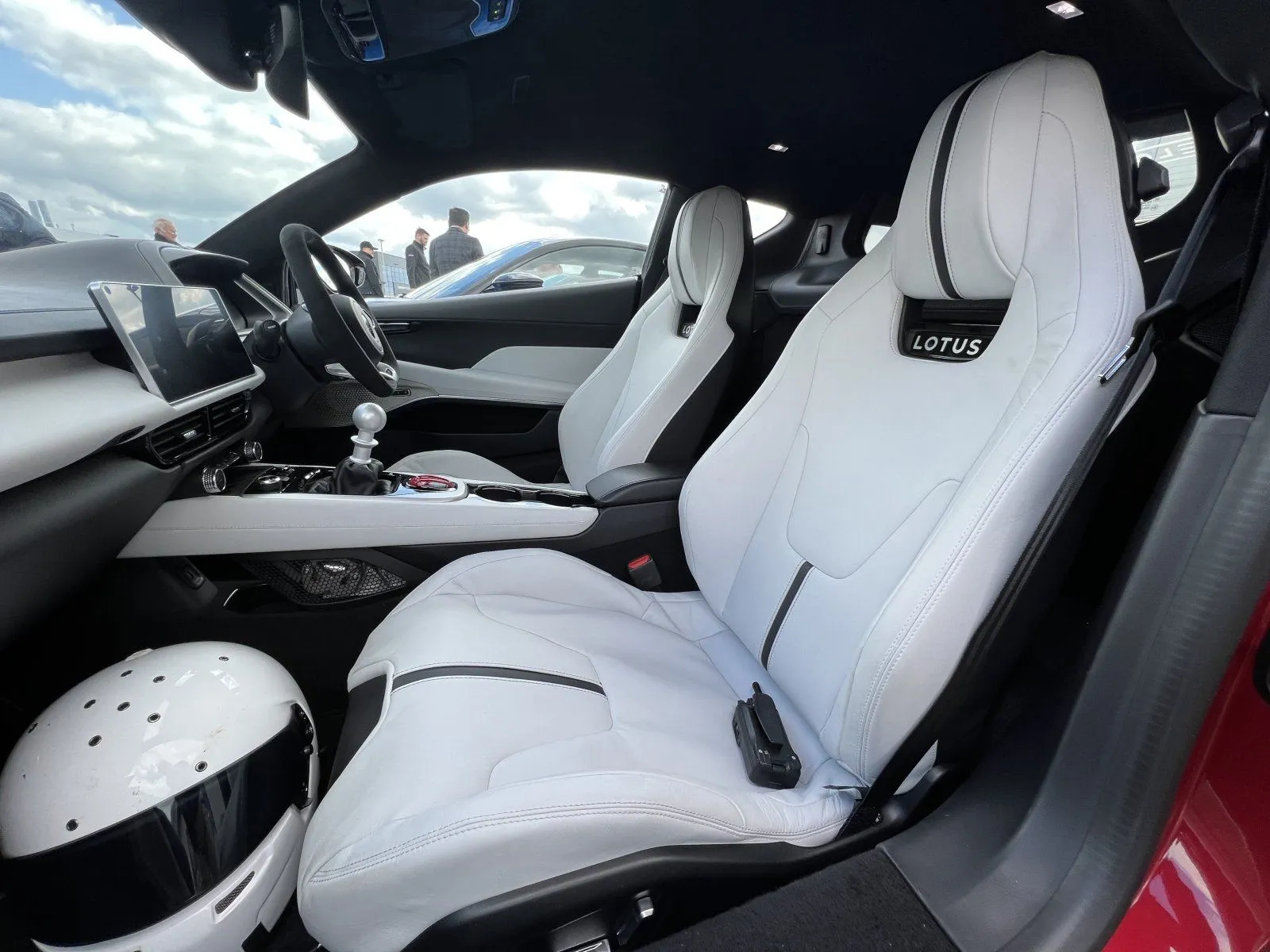

On the photo of the Seneca car I posted, you can see a short tab that is on the belt at the point where it connects to the seat, and that tab is on the seat side. This would probably be helpful for the people on assembly to know which direction the bottom of the belt goes against the seat, while checking to make sure the belt isn't twisted before bolting it to the seat frame.
