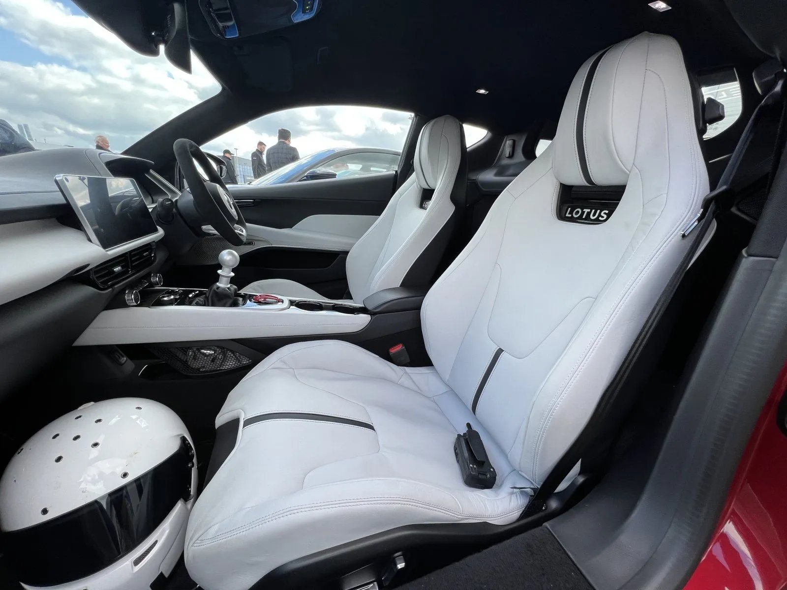

My previous assumption was that the seatbelt was installed correctly, and from your picture it doesn't appear that it is. If the end inside the B pillar has to be installed in the orientation in the photo, then that belt should be on the other side of the car. In order for the belt to lay properly in the photo, the top would have to be rotated 180° clockwise so the belt would lay flat across your body and not twist like that.
Lotus saying there's no way from visual inspection to tell which side they go on isn't true. You can tell by which direction the blade points. Coming up out of the B pillar and through the loop at the top, with the belt flat, the blade should be pointing inward towards the middle of the car. You shouldn't have to twist it around like it is in your photo.
Look at the photo below. On the right side of the photo, the belt coming up out of the B pillar is flat, and note the direction the blade is pointing. This belt is installed correctly on the correct side.

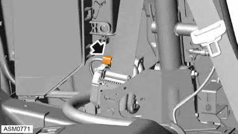

Here's how the tensioner mechanism mounts to the car:
What might be at play for @duff is an issue with the wiring harness connector where it plugs into the tensioner mechanism. I don't know what the failure mode is for the belt operation if electrical fails (or is unplugged)... it could be "ratchet retract and hold". Or it could be some other kind of electrical gremlin.

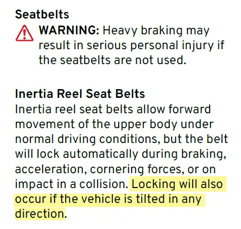

The Owner Handbook does indicate that the system will lock if the vehicle is tilted, on pg 29.
Note: for those not in the flow of this conversation, I'm not saying that this is expected operation. I'm just pointing out something in the Handbook as a data point. So put down your pitchforks.
