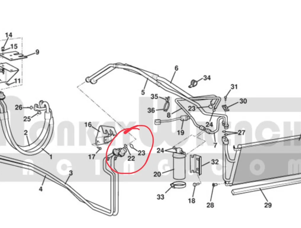

Does anyone have a diagram of where all the AC lines run from the front to the rear? I would like to be able to picture what route the AC lines take through the interior to the compressor.
Thanks!

I was told yesterday they found a leak in the line that connects with an O-ring that is located in the wheel well .
They we able to access the line by removing the inner liner.
I am hopeful this is the cause of my AC Failure. I know it was a slow leak as I had the car for about 3 months before the AC failed.
After a month in the shop the leak is fixed. Of course, I will keep monitoring since the last leak took 3 months to fail.
They found that the lines in the right wheel well leaked and needed to replace the o-rings.

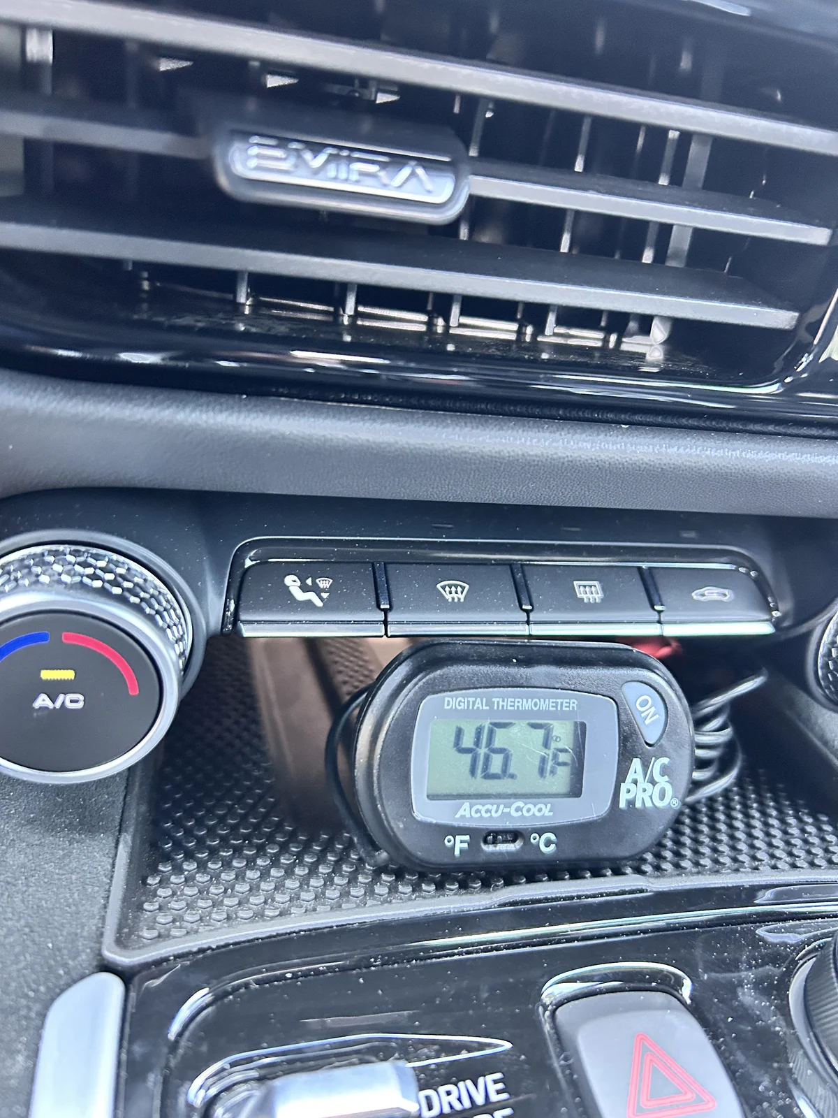

I had a AC vent temp gauge hanging around so I drove the 3 hours home from the dealer. The lowest temp out of the vent was 46.7 F. It seemed to vary between 46.7F and 55F. About 2.5 hours into my 3 hour drive the vent temp reached 59F. I assume it was due to the sun not blasting in the windows and the car was nice and cool/cold.
Also, the outside temp was about 95F and not 100F as the Dash indicted. I see the dash indicator always shows 5-10 degrees high.
