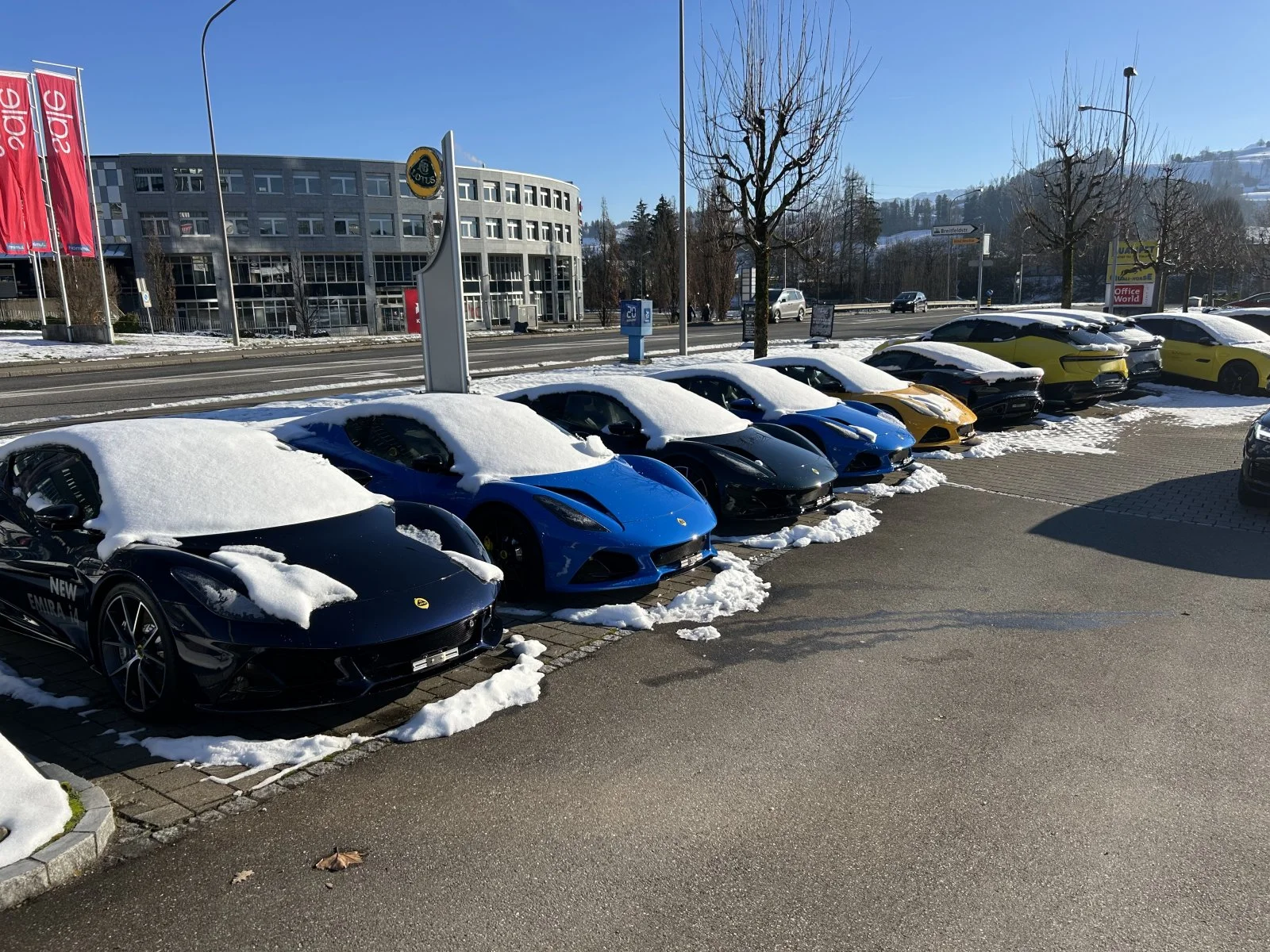

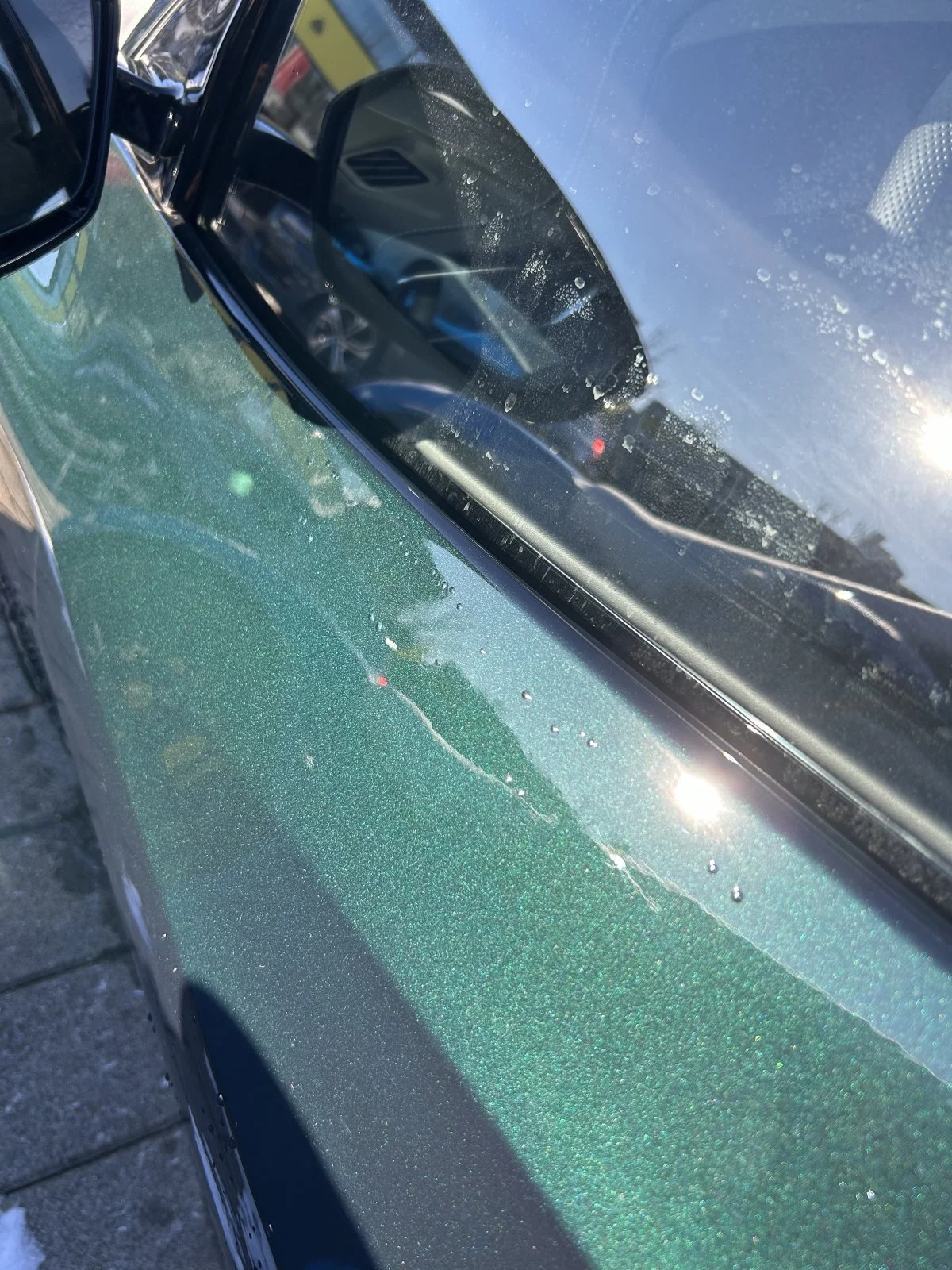

So today I checked out all the emiras which where sitting on the lot of my close Lotus dealer (4mins drive from my home). There were about 10 Emiras sitting outside of which about 5 had paint blisterings on either one or two doors. I checked them not very carefully and they were also covered in snow so there is a good chance that more than 5 cars of the 10 were affected. There were i4s and V6, didnt make any difference.

Doesn’t feel like the best storage condition. But yes I hear you on the paint blistering issue and questioning whether it is truly fixed or not.
Sadly it appears to be the best way to store them whilst still under warranty.
