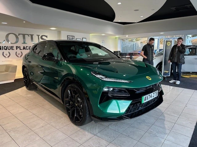

Update on my paint blistering. Took the car to the main dealers when I was picking up my Eletre. The salesman told me that the paint blistering is pretty much an issue on all first edition V6 models that they have seen back at the centre. The most common place to check for it is on the lip at the top of the door next to the window rubber. I hadn't noticed it on my drivers door (he pointed it out to me), so both of my doors will need to be replaced (the passenger door has blistering below the handle) and they will re apply PPF afterwards. This is turning out to be a really expensive issue for Lotus.
On another note, I love the new Eletre. Super luxurious and drives very well for such a big car. Makes a superb contrast to the Emira in many ways, not least Dark Verdant vs Calloway Green. I'll post a side by side shot when I get the Emira back!

As for the Eletre, I had the R version for a couple of days 😱😱😱 Quick
