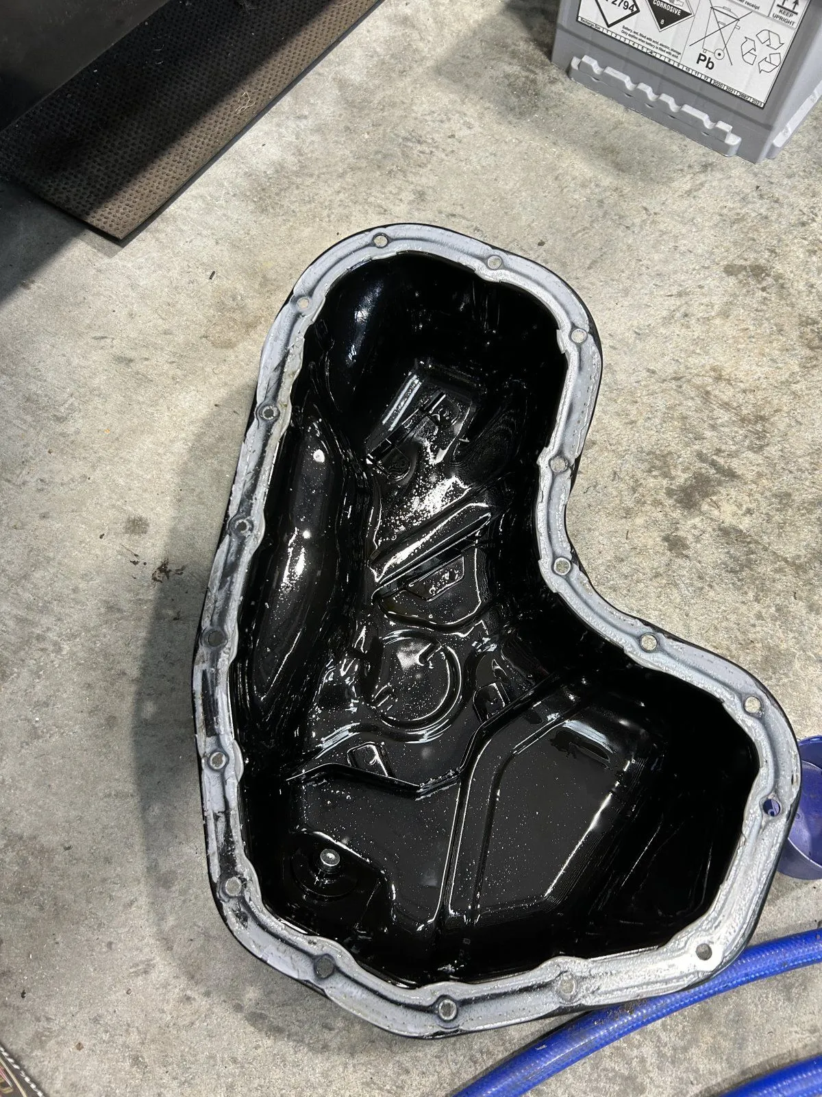

In this use case the baffled sump makes more sense, it’s more cost effective, it solves any issues of oil starvation in standard/mild modded Emiras on track rubber, and it’s a lot simpler when it comes to install.Is there a reason why owners prefer baffled pans to dry sumps?
If you intend on going full GT race car conversion on slicks then 100% the sensible choice would be dry sump.
I just do not feel the Emira as it is out the box comes anywhere near requiring a dry sump and the complications that come with fitment.
