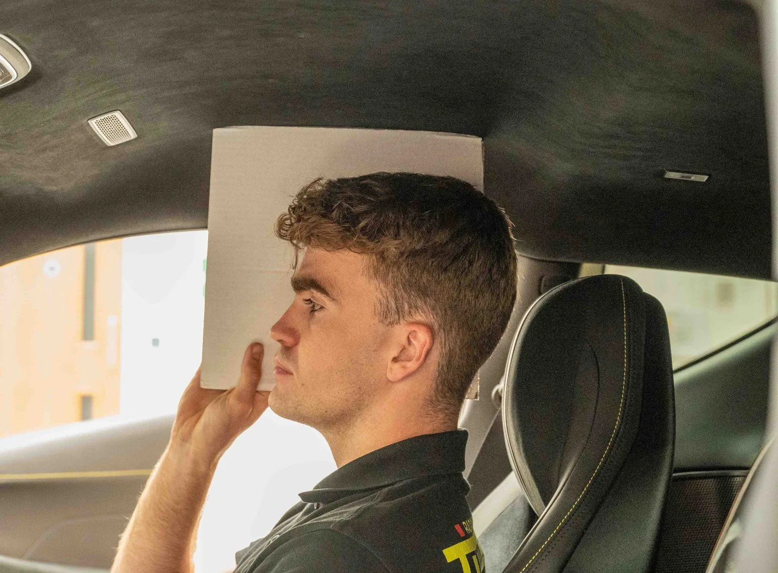

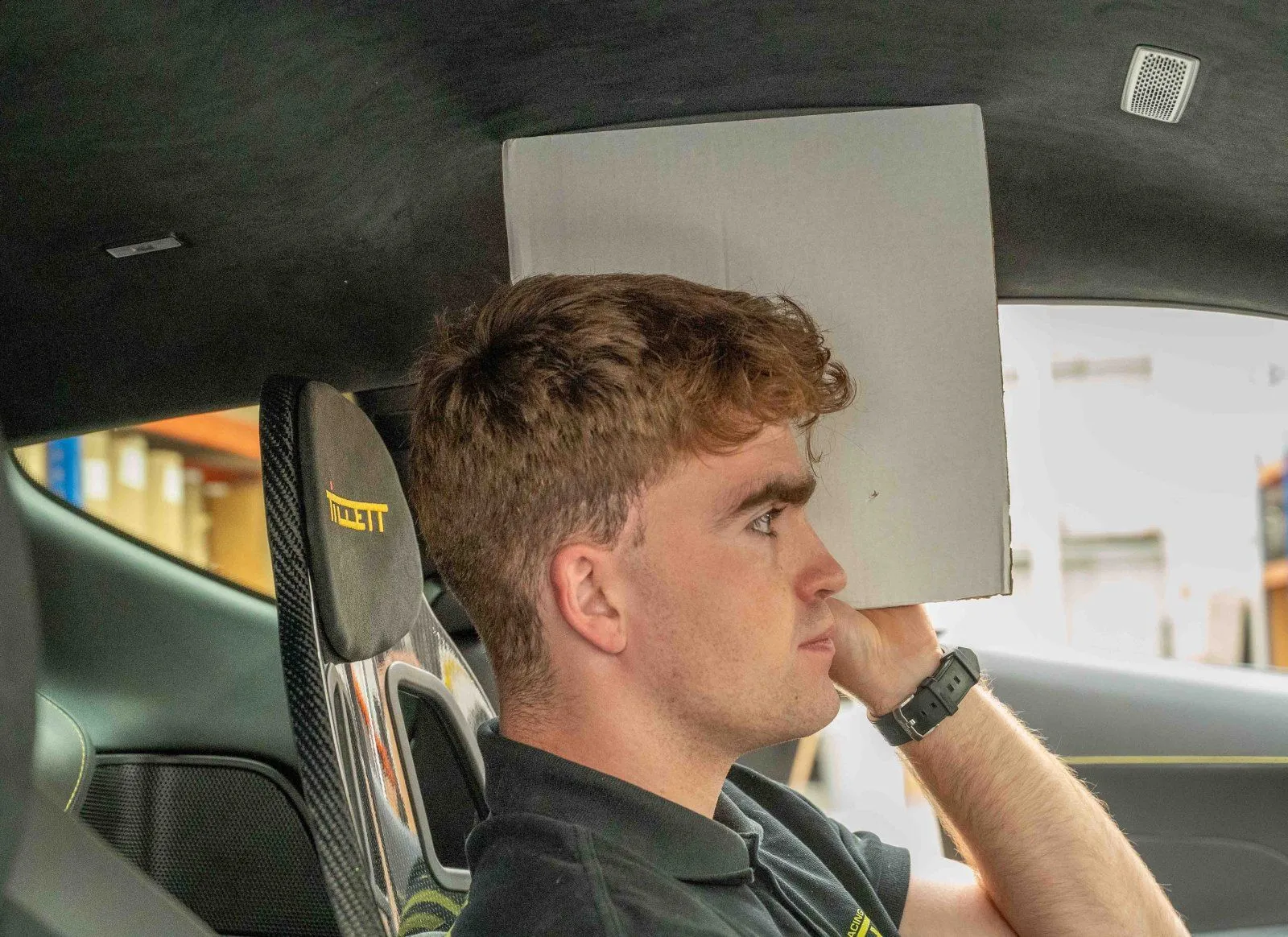

Lowering the original seat will be nearly impossible.
We did this early test to see what could be achieved with our seats.
Using a 6ft driver the Emira seat was sat in the lowest possible position and you can see the gap in the first photo with a 6ft driver.
With our B5 at the position shown in the second photo, it still had a 25mm gap which we could have used to lower it further.
Due to a straight upright back the B5 is also not as low as the curved B10XL, which we finally decided was the best match.

I did some investigation on it and dont see a way to lower the factory seat at all either.
With the adjustment in the lowest position thelinkage it right upagainst the floor.
So the only way to make them lower would be to eliminate all the power stuff and fixed mount them which I dont really see anyone wanting to do.
Bummer for sure as the stock seats are pretty comfortable but sit up a bit high for my liking being taller. They dont seem as bad as the Evora seats though.

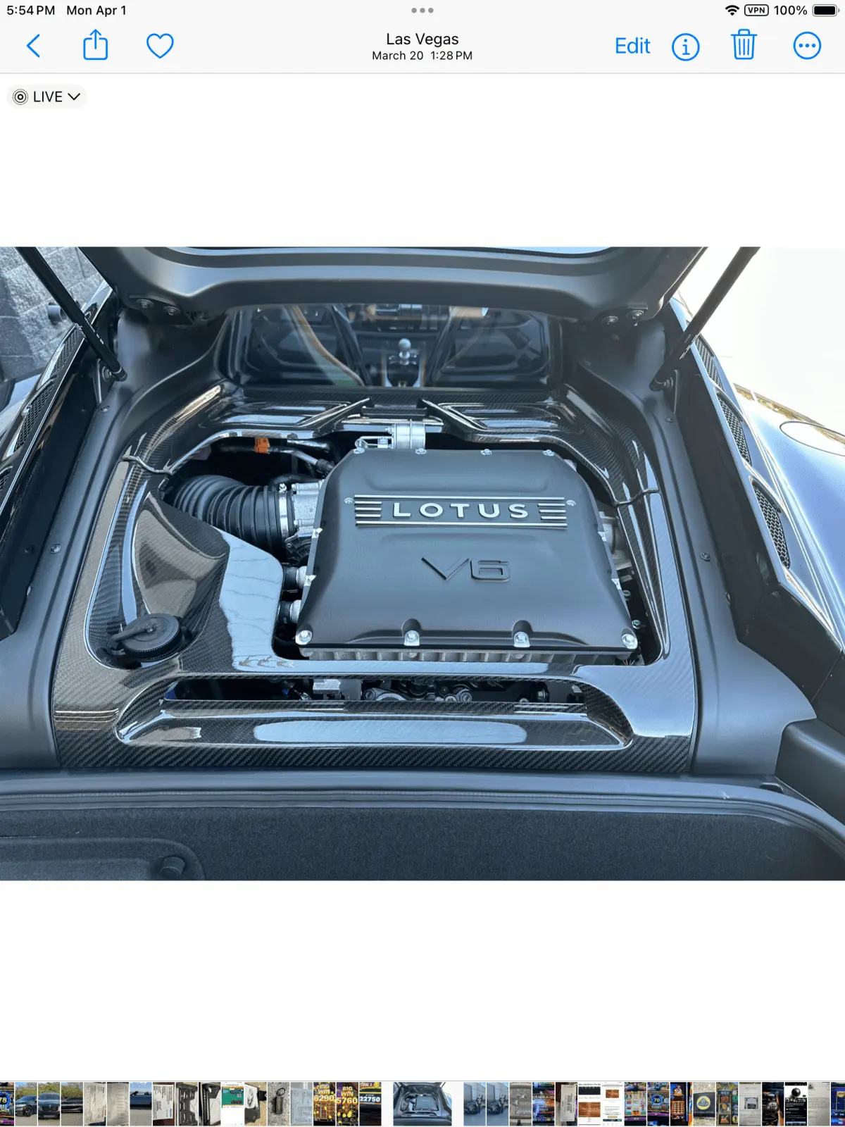

I bought that and it looks much better.
It does indeed. Question for you:
Is this the whole engine cover that came like this or have you not installed yet right and left CF pieces?
