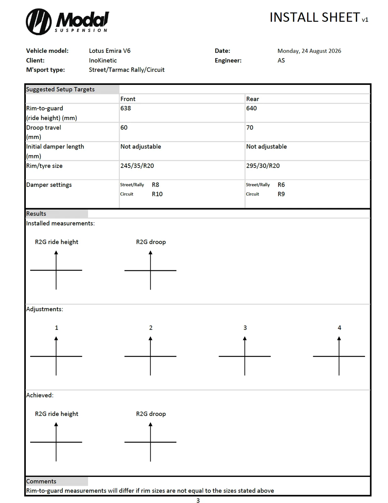

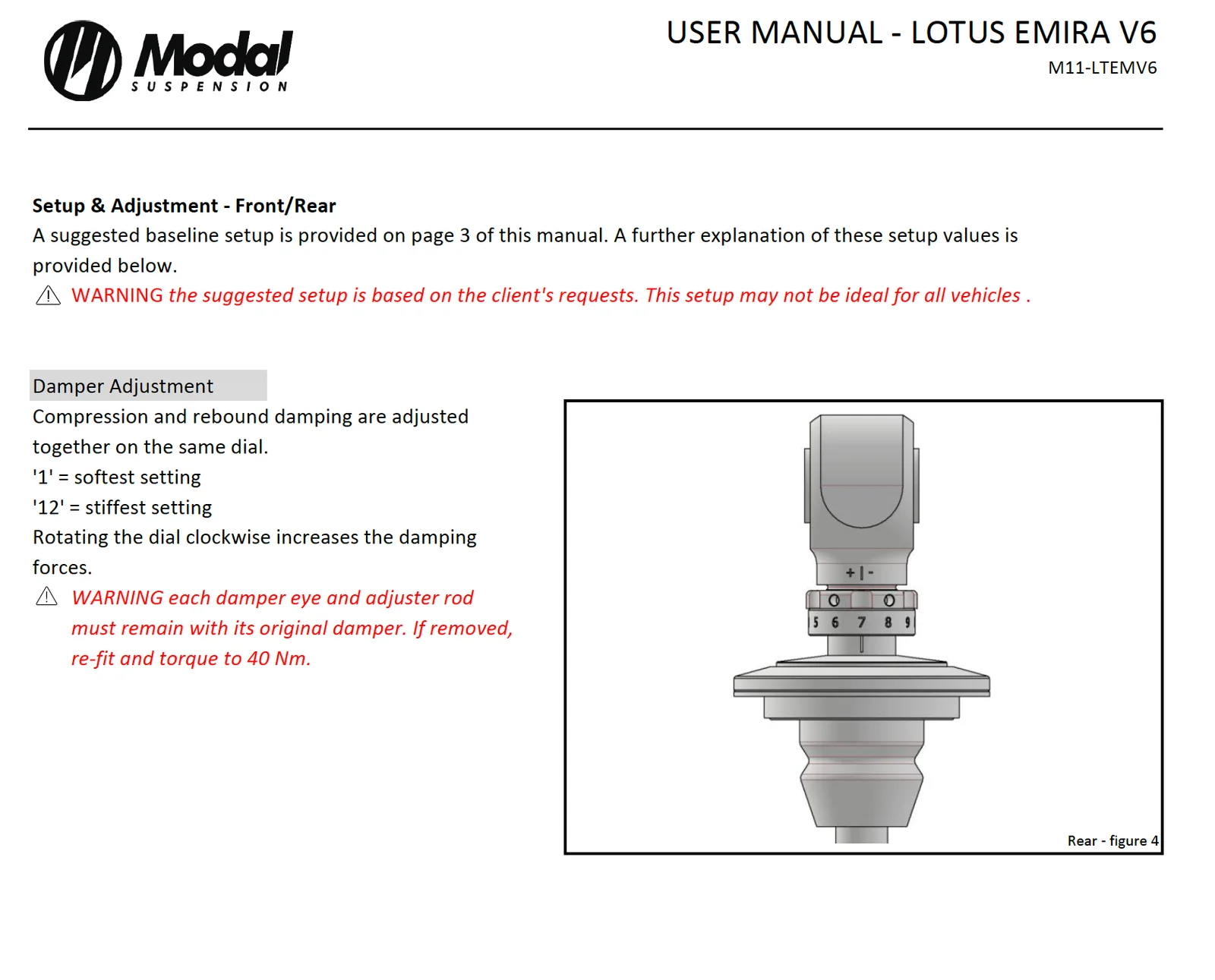

David, my Modal M1s will be arriving soon from Inokinetic. The spring rates are basically the same as Nitron's R1 fast roads spring rates. How are you liking the ride on your Modals? What ride height are you at currently? How about your soft/firm settings...at what numbers are you running them?

8 front, 6 rear(12 is full hard). Can’t tell u the ride hight exactly. But it’s around 15mm(you have to convert that to imperial). Feels nice and firm(without bumping around). And going fast through a roundabout(straight through) bites very hard at the front with no sloppy lean in and out. The way it should have been from the factory. Lotus were hunting Porsche cayman/ boxer(718) buyers. So they probably required soft and sloppy to get them across.

Thank you. I received the same recommendations from Modal/Shinoo...see the document Shinoo sent me on these specific dampers. I plan on going a bit lower than the 638 and 640mm. I measured yesterday and I'm currently at 654mm front and 660mm rear. To get to the suggested height, it's a 15mm drop in front and 20mm drop in rear. I want to go 20mm in the front and 25mm in the rear, at least to start. We shall see.
