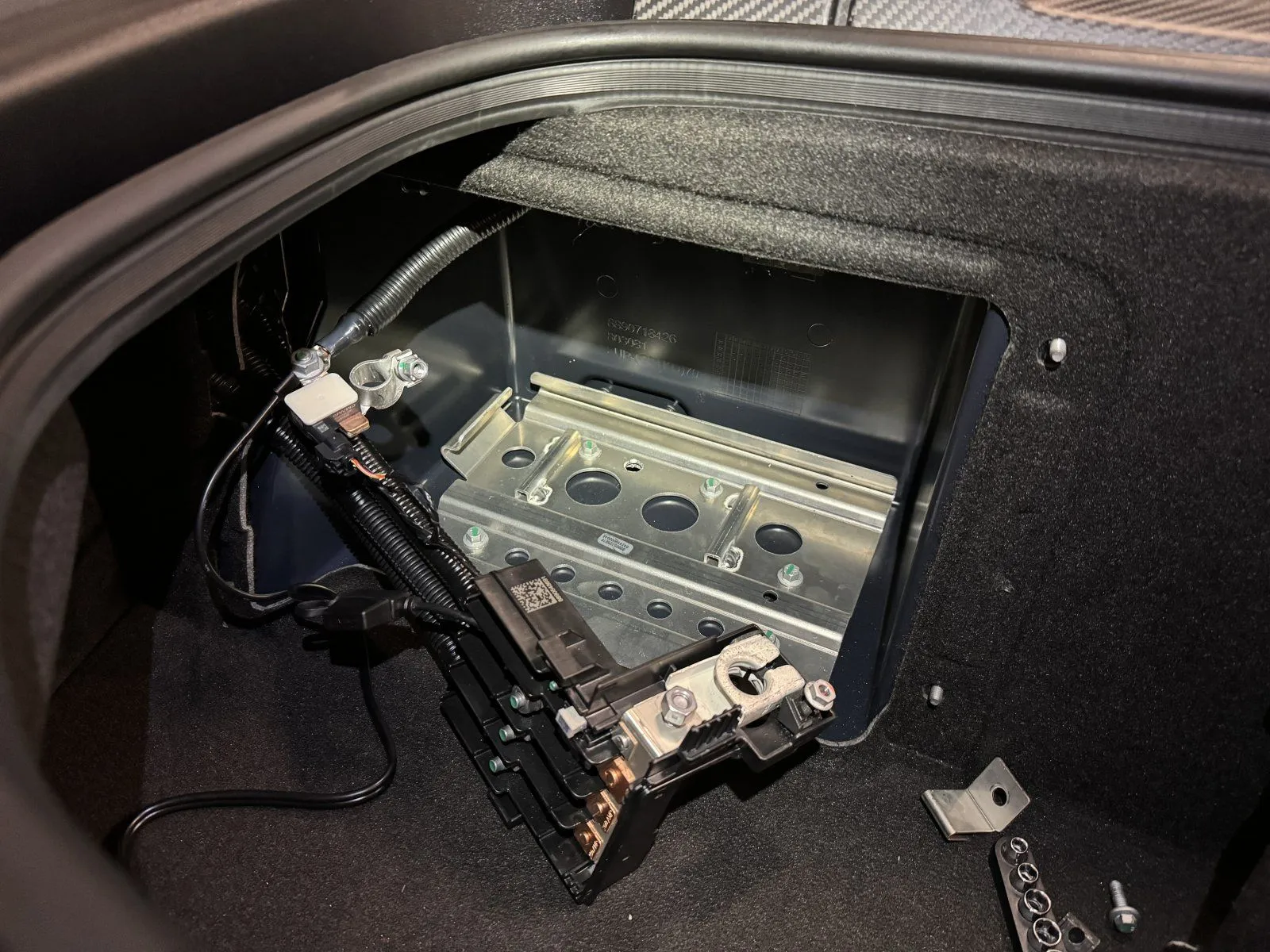

Swapped in my Antigravity battery today with only 54 miles on the odometer. It was easier than expected, taking about 20 minutes. I also added their "battery tracker plus" bluetooth module that's fun/helpful for data nerds. It graphs your voltage, cranking amps, temp, GPS if you forget where you park your car, etc.
My Emira is now ~30lbs lighter and my wallet $880 lighter :ROFLMAO: but I feel good knowing this will perform much more reliably than the OEM battery and probably last 10 years or more. Plus it has a reserve jump start capability which is huge if I forget to unplug my dash cam with parking mode running for a few days.
Did you install the screws on top or no?

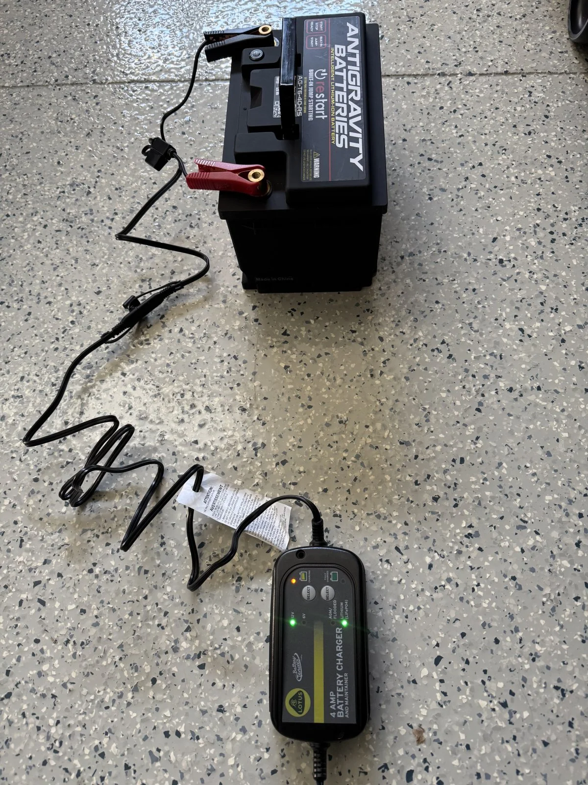

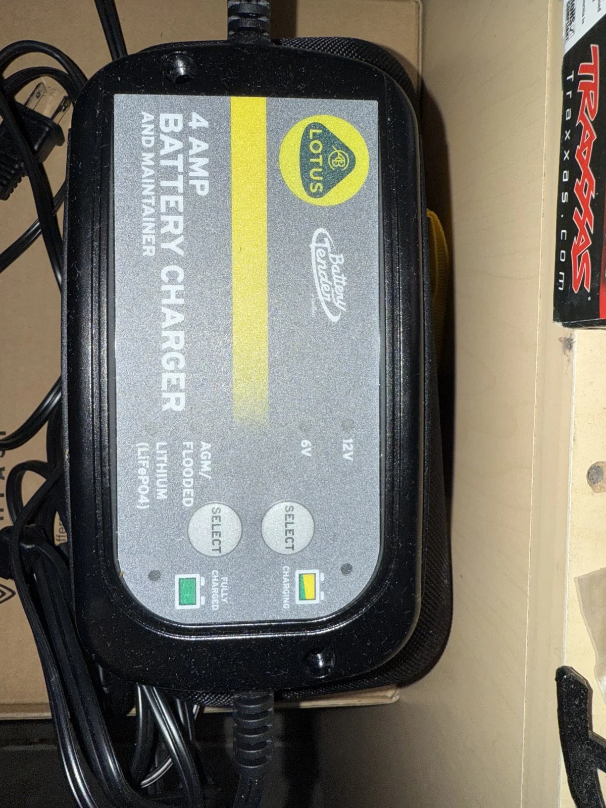

It’s got 2 options 12v vs 6v and AGM/flooded vs Lithium LiFePO4
So I selected 12v and Lithium LiFePO4

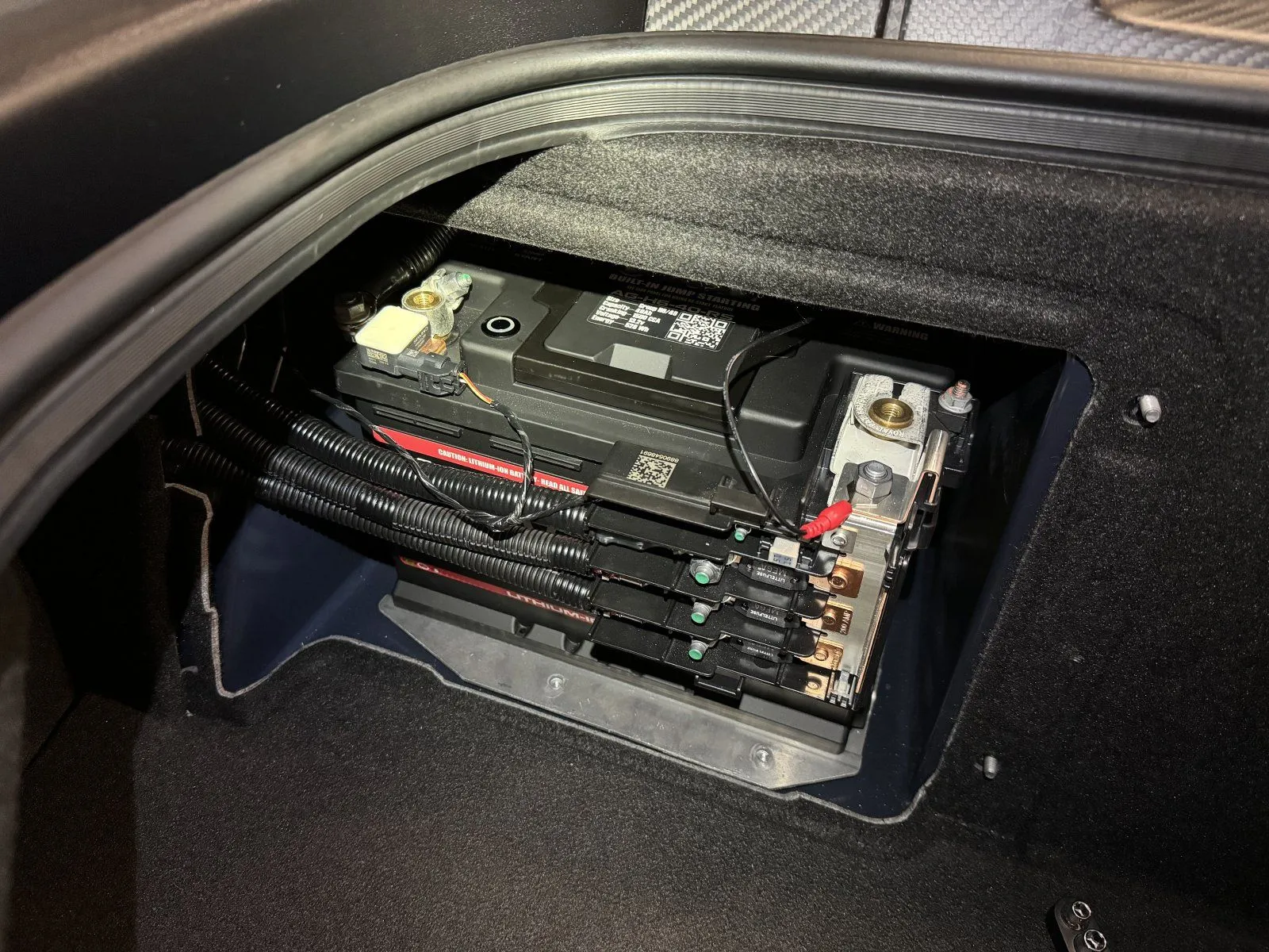

For those that have installed it have you noticed small movement laterally? If I push it hard it moves slightly, wondering if this is a problem during lateral force when turning.

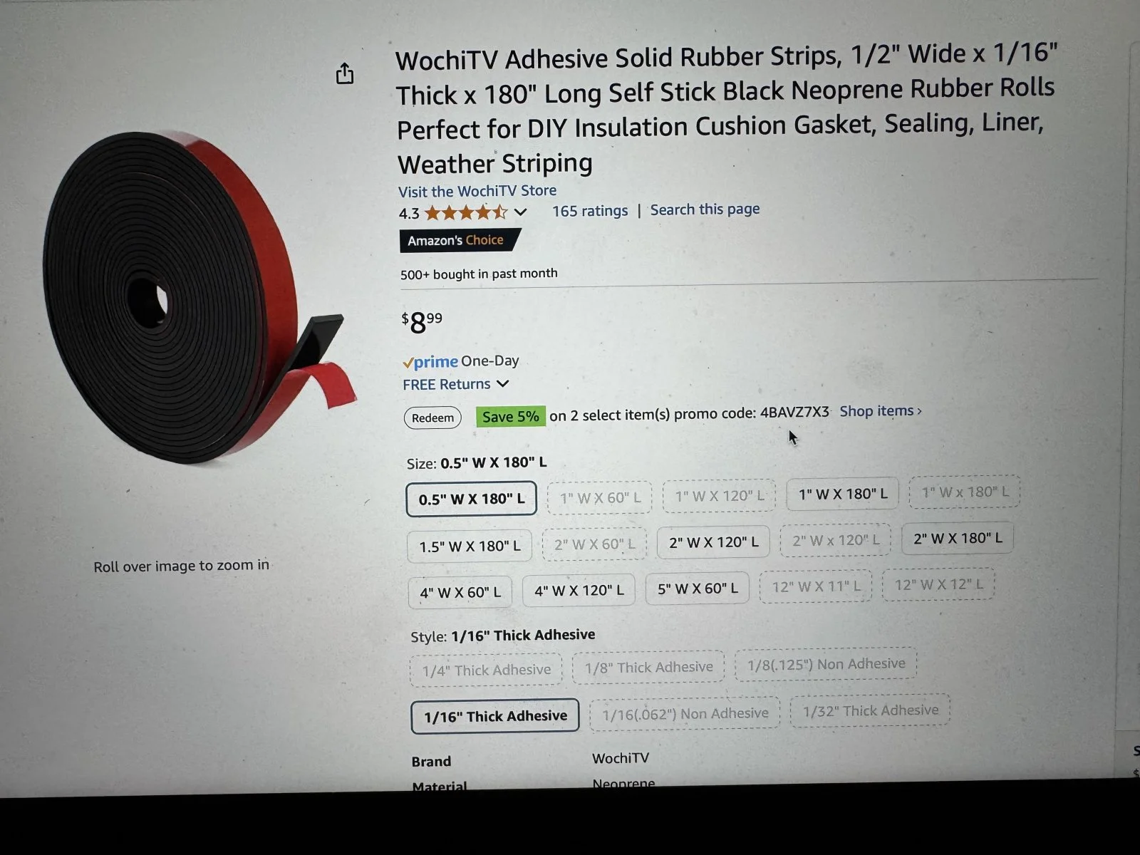

Yeah, I noticed that also on my first attempt at tightening the bracket, so I figured the Antigravity battery's lower lip is a bit smaller than the OEM lip. I placed a thin strip of self adhesive rubber (not foam) on the inner slanted section of the bracket and that secured the battery firmly in place. Hope this helps.
You think heavy duty double sided tape would work too? Idk what’s safe to put by a battery lol I know it’s only the bottom.
It probably would work, but do you really want to have the aluminum bracket glued to the battery lip, instead of just glued to the aluminum bracket? Also, depends on the type of double sided tape you plan to use. I don't think it's a matter of the battery's safeness, as they are well insulated, but the Emira's trunk does get very hot and, over time, the frequent exposure to the heat, could deteriorate the foam type, thus my suggestion to avoid it and opt for a rubber type trim instead.

Yeah I ordered some other rubber 1 sided sticky and the other grippy.
