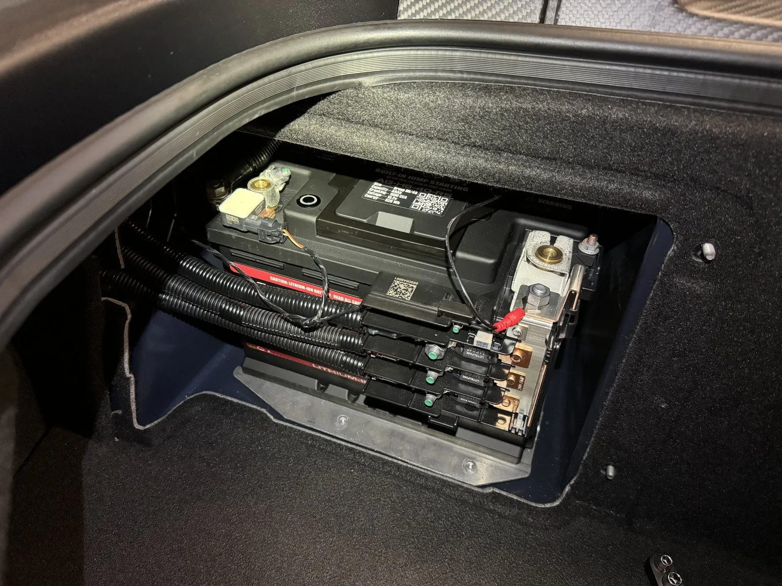

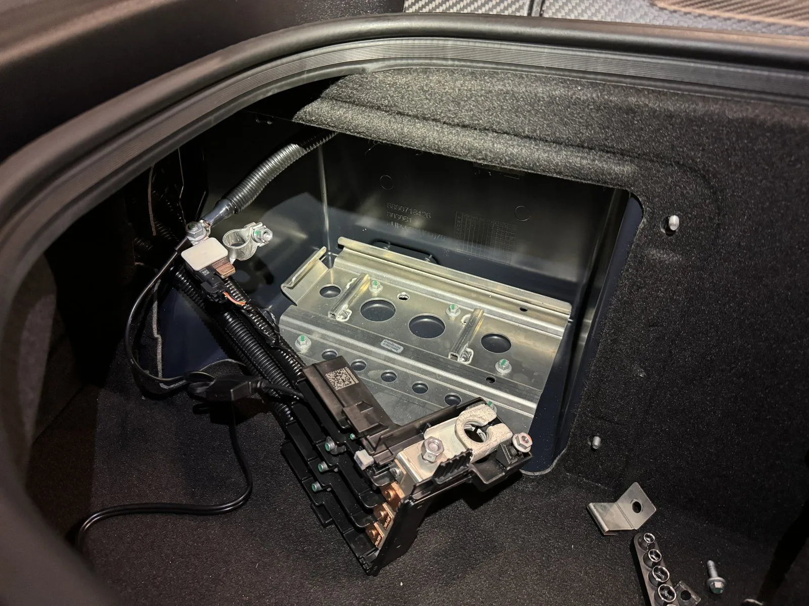

Swapped in my Antigravity battery today with only 54 miles on the odometer. It was easier than expected, taking about 20 minutes. I also added their "battery tracker plus" bluetooth module that's fun/helpful for data nerds. It graphs your voltage, cranking amps, temp, GPS if you forget where you park your car, etc.
My Emira is now ~30lbs lighter and my wallet $880 lighter :ROFLMAO: but I feel good knowing this will perform much more reliably than the OEM battery and probably last 10 years or more. Plus it has a reserve jump start capability which is huge if I forget to unplug my dash cam with parking mode running for a few days.

Very cool. FYI - For the little black plastic cover, you can trim ever so slightly to fit the pig tails of the tracker etc.

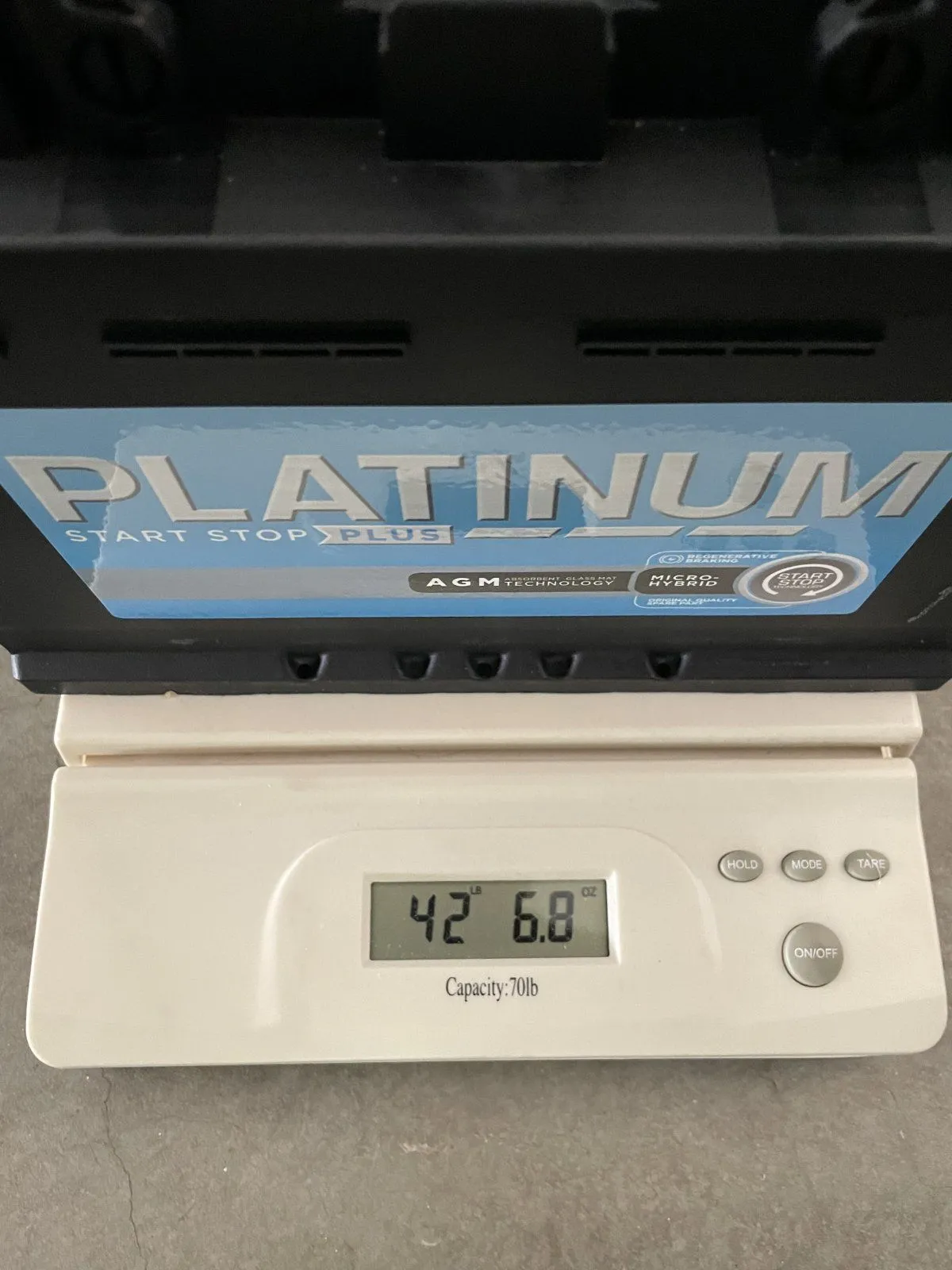

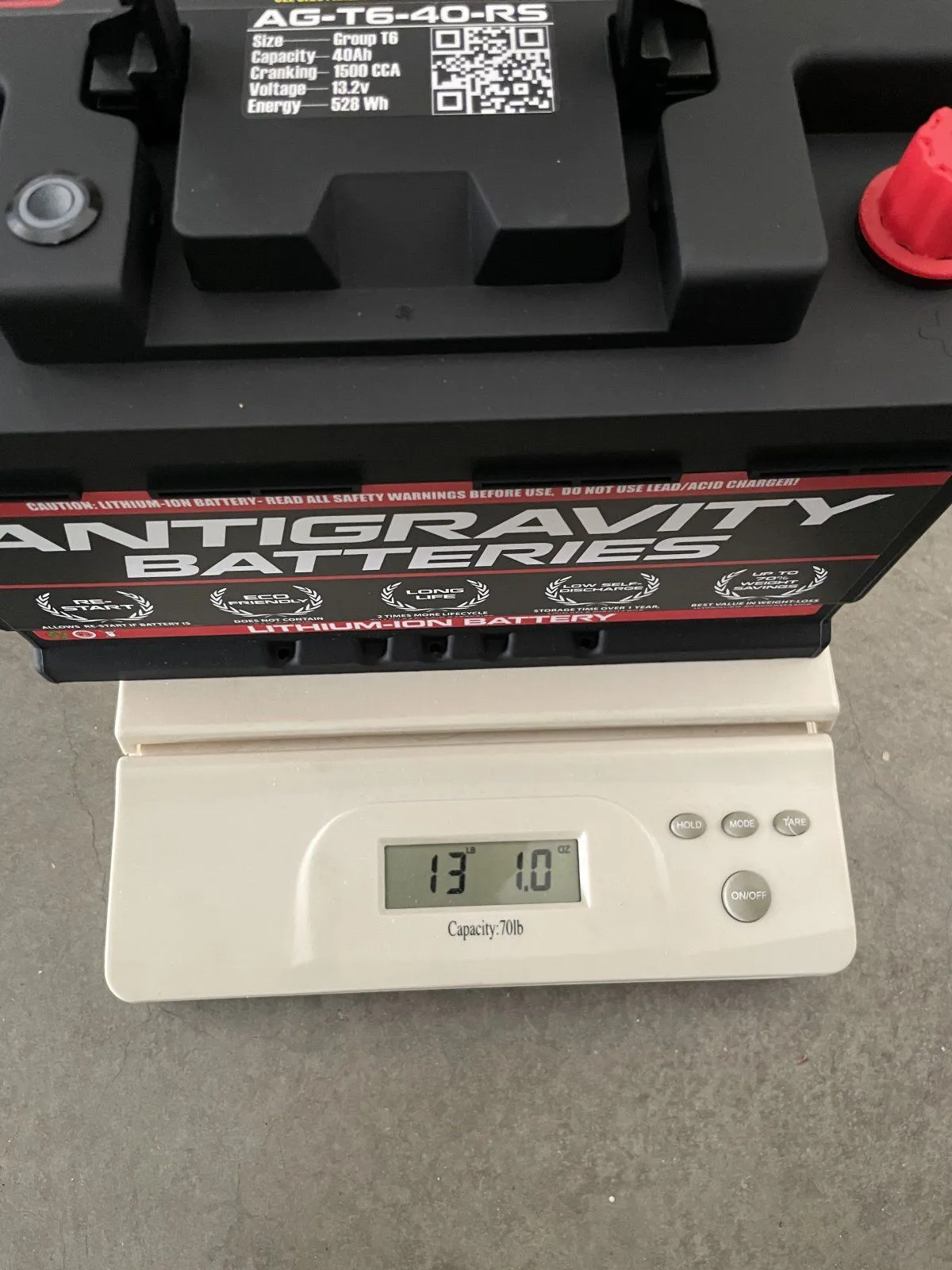

Took the time to get my LiOn Antigravity battery installed. You don't appreciate how light it is until you have to lift out the factory battery. Weighed both. The factory battery weighs 42 lbs. 6.8 oz. The 40Ah Antigravity weighs 13 lbs. 1 oz. About 29 1/2 lbs lighter.
