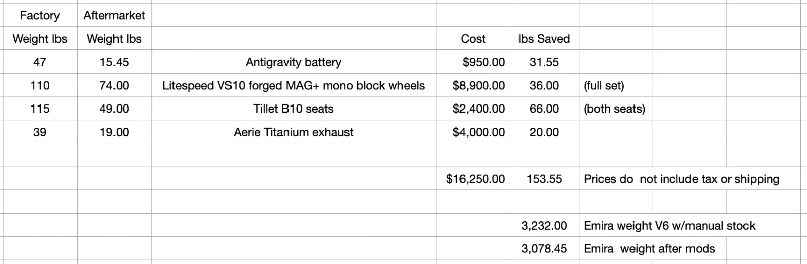

I've been running a lot of what-if's on a spreadsheet for all kinds of possibilities, and I don't see any realistic way to get the Emira (V6/manual) down to 3,000 lbs unless you want to go hardcore which is really going to be expensive. You can get it down to just under 3,100 lbs, but even at that it's still going to be expensive. Depending on how dedicated you are to your weight reduction goal, and how much money you want to spend, here's a small snapshot of just a few items that get you down just under 3,100 lbs.
The above list assumes you're doing all your own wrenching.
I don't know what the final price is going to be on the Tillet seats once they have the brackets priced, so it could be more than the above which is approximate. You can save about $6k by going with the Aerie wheels instead of the Litespeed, but the Aerie wheels are 14 lbs heavier. That's still a $10k+ mod list.
You can of course also start throwing money at carbon fiber body parts, but that gets pricey real fast for typically small gains per piece. I suppose if you want to throw $20k-$30k at mods you could get down to 3,000 lbs, but that's a lot of money. Power to weight ratio stock is 3,232/400=8.08. If you get the weight down as above to 3,078, that's a ratio of 3,078/400=7.70.
Supposedly the Aerie exhaust adds about 20 hp according to them (we'll have to wait and see what the actual dyno results are) so that would change things. If you do that first (which of course voids your warranty) your power to weight ratio just with that mod alone, is 3,212/420=7.64. Add everything else above and it's 3,078/420=7.32. An Alfa Romeo Giulia QV with a twin-turbo V6 putting out 505 hp, has a power to weight ratio of 7.54 just as a comparison, so with all the above mods you'll out-perform a QV. A new 2024 QV starts at $82k (0-60 is 3.8 secs), so if you buy an Emira FE at $105k, and add another approx. $20k (including the above mods, shipping, tax, labor), for only $125k you can beat an $82k QV. Such a deal lol. Even if you go with the Aerie wheels and got the original FE 1.0 pricing, you're still going to be over $100k with mods. It'll look gorgeous and surprise a lot of people though.
You can play around with all kinds of combinations on a spreadsheet, but the one thing that's clear is it's going to cost to make an appreciable reduction in weight that you would feel on the street. Depends on what you want to spend and how far you want to go. Now if you're going for a track build, that's a different story.

I had the Emira curb weight at ~3,170lbs as opposed to your 3232lbs, so I guess we'll have wait to get our cars for a true measurement, otherwise I agree. It will likely be around $10k-$12k from my napkin math, but many of the weight saving mods will bring gains in other areas that I wanted to do anyways. I don't think I'll go with Tillet seats as I don't do any modifications to my street cars that make tradeoffs in other areas (safety and comfort in this case). My planned list will add 20-40hp and remove 150-180lbs, which will be noticeable together, particularly since a third of that weight removal will be from rotating mass.

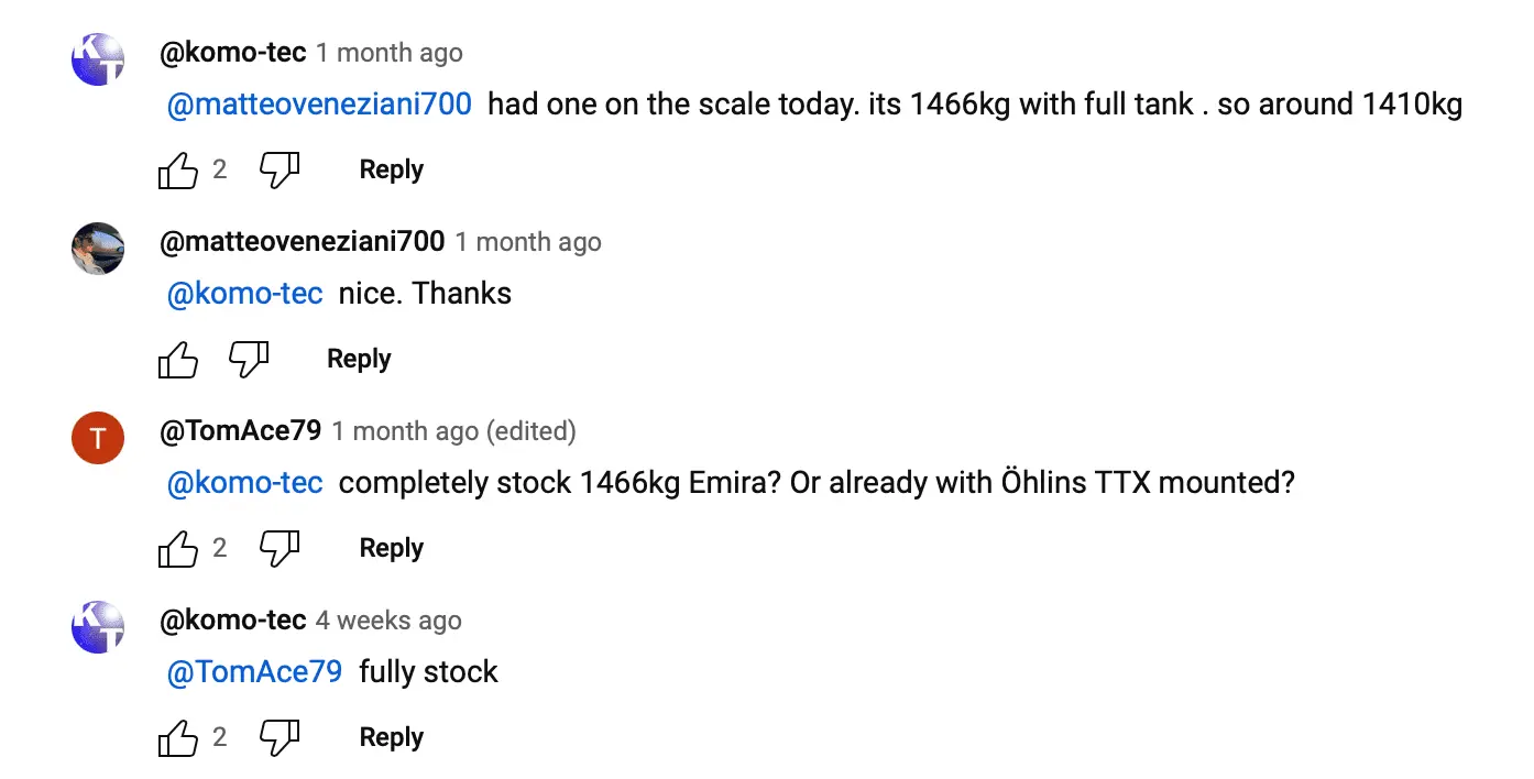

I got the weight from a post by Komo Tec where they weighed a car and it was 1466 kg. That converts to 3,232 lbs.

Great spreadsheet. Did you get the exact weight back on the Lightweight wheel or that the ‘from’ weight because I’m still waiting for a reply from them?
Also I read wheels and all spinning items should be calibrated at 3.8 x the weight reduction to give the equivalent overall weight of the car. Not sure if that is accurate but I have see the calculation higher.

No. I don't think they'll have an exact weight unless they make the actual wheels. Best we get is an estimate at this point.
Yes reducing unsprung rotating weight (URW) has a greater benefit than just removing static weight, but I've seen claims of anywhere from 4 to 10 times the benefit of removing static weight. I haven't found any actual verified data sheets that show what the real benefit ratio is, but I know from experience that you can feel the difference if you remove at least 5 lbs per wheel corner. That can include wheels, lug nuts/bolts, brake rotors and bearings.
You will get the most benefit, and notice it the most the farther from the rotating center you can remove the weight. This is why wheels and tires have the most impact. Lugs, bearings and brake rotors are close to the rotating center, especially lugs and bearings, so they don't have as much of an impact, although it all adds up. There's an additional benefit of removing the URW at the wheel corner, in that it lightens the load the springs and shocks (dampers) have to manage, so the wheels respond to surface elevation changes quicker.
