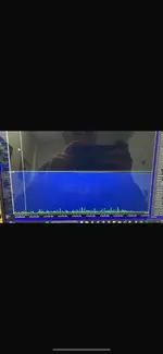

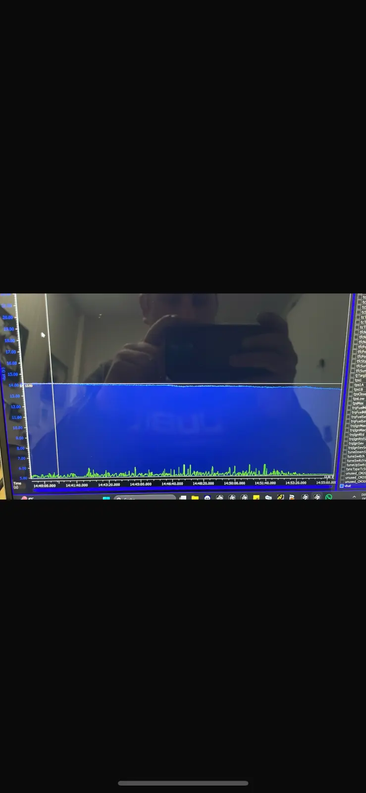

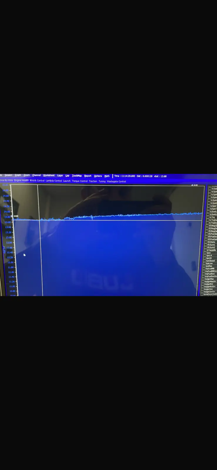

So weird, this is my OEM battery vs Anti 40AH and the 40AH is losing power from start of the drive to the end.
Has anyone gotten this detailed on their battery? Is this a 40 not powerful enough or is this a bad battery
Have you reached out to the antigravity or where you got it from? I’ve had the antigravity 40ah on both my lotus cars including my Emira and it’s been great with no issues

Where did you see that blue screen? Are you using the Bluetooth battery tracker to check the levels of the battery?
That was from JUBU remote session I had and he saw that and let me know. I’m glad thou bc I wouldn’t have noticed it unless he told me.
Overtime I’m sure I would have but maybe it’s not taking a charge from the alternator while driving idk. Antigravity will do some diagnostics on it bc my OEM was good and normal.

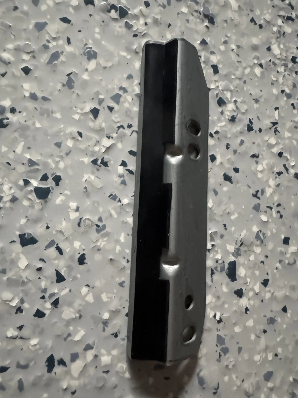

Installed the T6/L2 40AH about 6 months ago. Despite initially being left a little loose after tightening the bracket, it was secured firmly by wedging a small strip of rubber trim on the inner section of the bracket. No issues, so far, it has worked flawlessly.

I've had the 40ah battery installed in my Emira for about 4 months without any issues. The considerable weight savings is what prompted me to make the purchase but I also like the much higher CCA rating compared to the factory battery and the built in ability to jump start. The battery is fully compatible with the Lotus battery tender as well. If you install the battery with the factory clamp, there will likely be some movement as others have reported but not enough for the battery to move away from the clamp. Adding some rubber stripping is a good idea. if you find that to be the case.

I did do the strip of rubber here is a picture and it was very snug.
