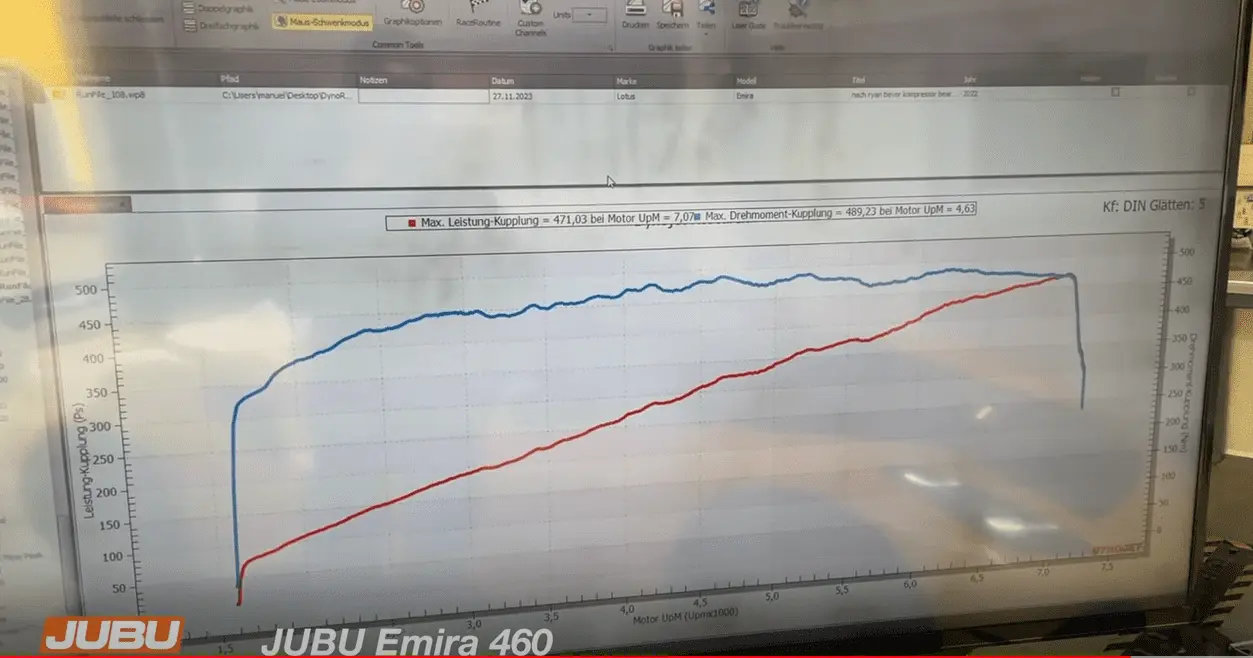

I note watching the video of the JUBU 460 Emira on the rolling road (with aftermarket ECU) when it touches the limiter, that sounds softer, and more traditional, just a stammer, rather than total cut.
Also looks like they have it revving to 7200-ish rpm, according to their charts.. Sounds nice.
See it here:

Yeah good call on the 7.2K RPM. It does appear that's what they rev it out to. Also notice where the peak power is in the below translated numbers from the following screenshot (hint: it's materially beyond the factory cut-off):
7,200 RPM redline
464hp @ 7,070rpm
360ft lb torque @ 4,630rpm
I have to think with this kit the Emira should be well under 4.0 secs to 60 despite the slow shift into 2nd. It is essentially a 15% increase in HP and roughly 16% in torque AND more time to use both based on the dyno results.
Unless I just love the power as is, this will be hard to resist come warranty expiration time. In my view, this would tip the Emira into it legitimately being fast enough in a straight line to support its supercar looks. It's probably very unnecessary on the road but I'm sure it would increase the fun factor by a decent margin.

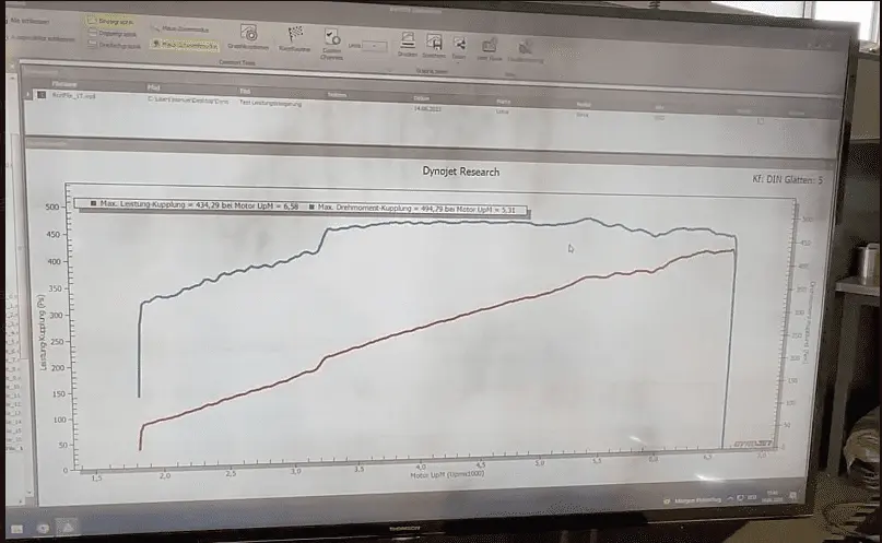

EDIT: I did also notice their 435 version does NOT seem to have the higher redline and has much less low-end torque (between around 2-3.5K RPMs) compared to the 460:
That's odd. According to the charts you show, the 435 actually makes more peak torque than the 460, but just doesn't rev as high.
Is this a product of running the stock cast exhaust manifolds and pre-cats?? Or am I missing something? Confused of Shepperton.
That's beyond my area of expertise in terms of the peak torque throughput as it seems puzzling to me. Based on the charts, though, the freer-breathing manifolds and cats in the 460 definitely appear to give it much more oomph at low RPMs. I think that will make it FEEL quite a bit faster than it probably is in terms of straight-line speed.
