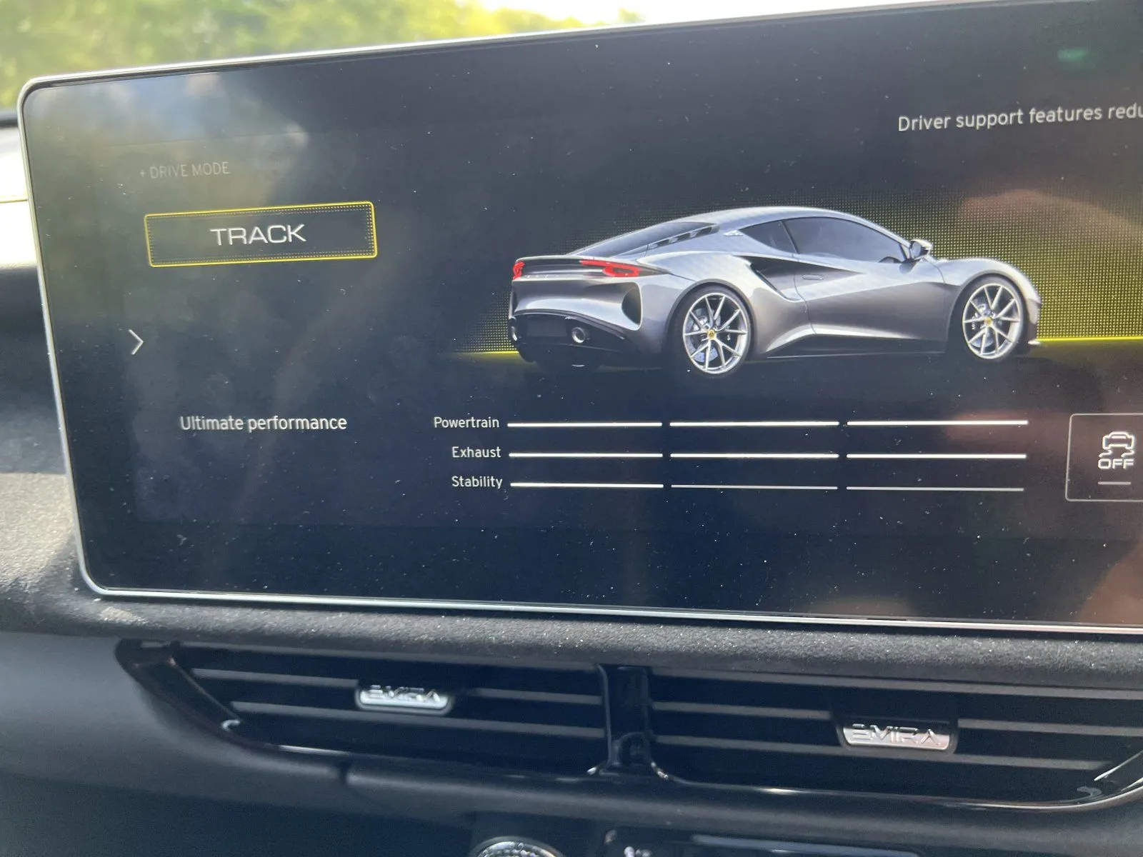

Update (edit): after a drive have home (2h) + a stop for dinner for an hour and a half when I came back the light was gone :) won’t trouble with going to the dealer probably will wait for the service in 2months.
