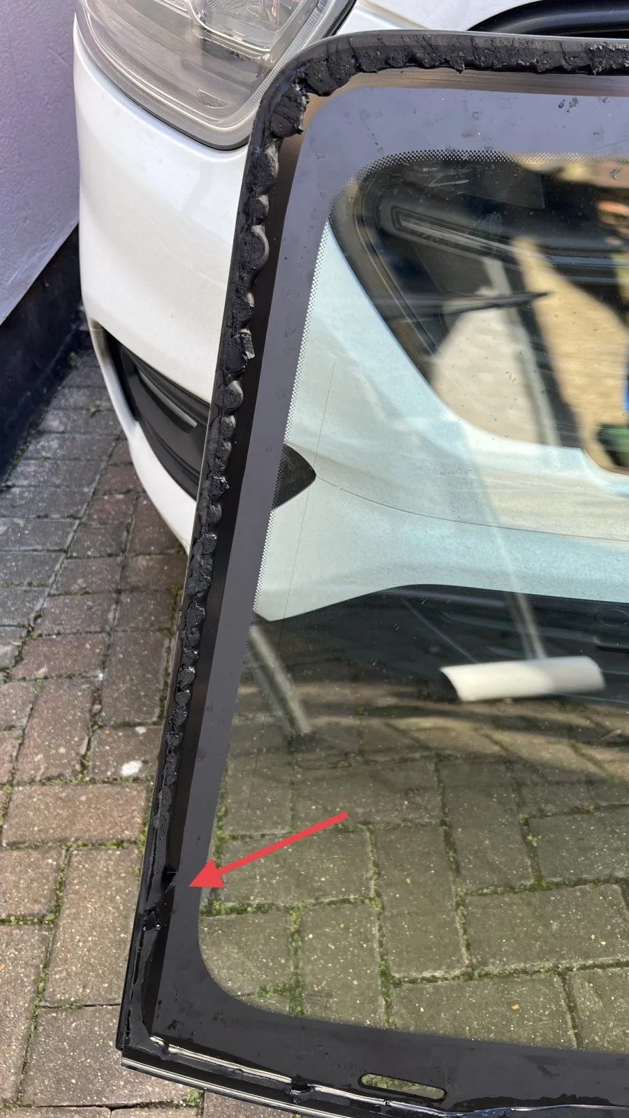

While we’re on the subject of windscreens, having had a crack in mine was actually a blessing in disguise.
The original factory fitted screen was so badly fitted it was leaking.
I had noticed some water in the vin window that I had put down to condensation but it actually was water leaking through a gap in the adhesive.
Also note the crappy blobs of adhesive, not a proper bead.
I would have assumed they were machine fitted at build, but apparently not.
The back of my dashboard would have been slowly filling with water (with predictable consequences) if that stone hadn’t hit me.
Every cloud, etc…

What the actual F Lotus?!? I expect better than this.
