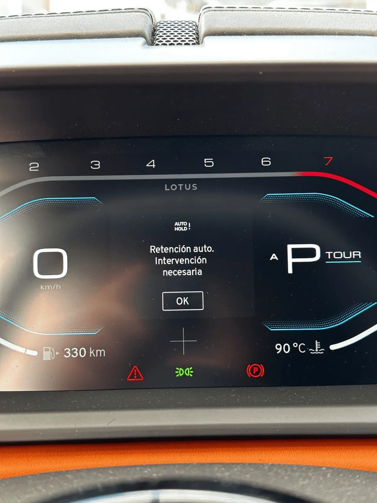

In mine I am having the "Auto hold" warning intermittently

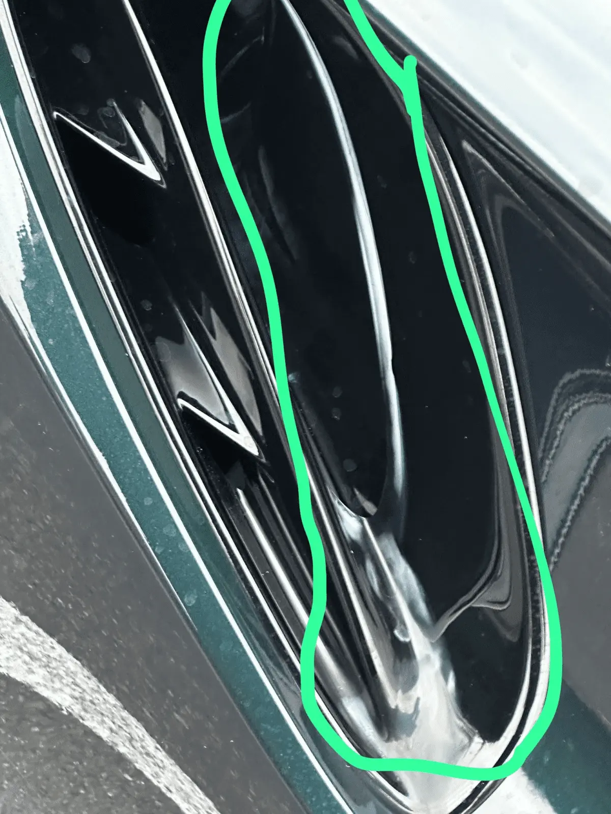

and also some white spots on the plastic piece next to the door, as if the plastic had deteriorated
The plastic is a new one for me. Any chance you could upload a video of the plastic? From a still image it's hard to tell what's just a reflection.
At the moment I don't have it, I'm doing the ppf and the ceramic coating, when it's finished and I have it, I'll upload a video but it's really what that white trail of burned plastic looks like in the photo
What is this? Isn't the "Hold" a feature to keep the brake on for a few seconds on an incline to prevent you from rolling backwards?
It says something like "Auto hold. Intervention required"
I only get it every once in a while, my dealer has told me they will notify me for a software update that is supposed to fix this.

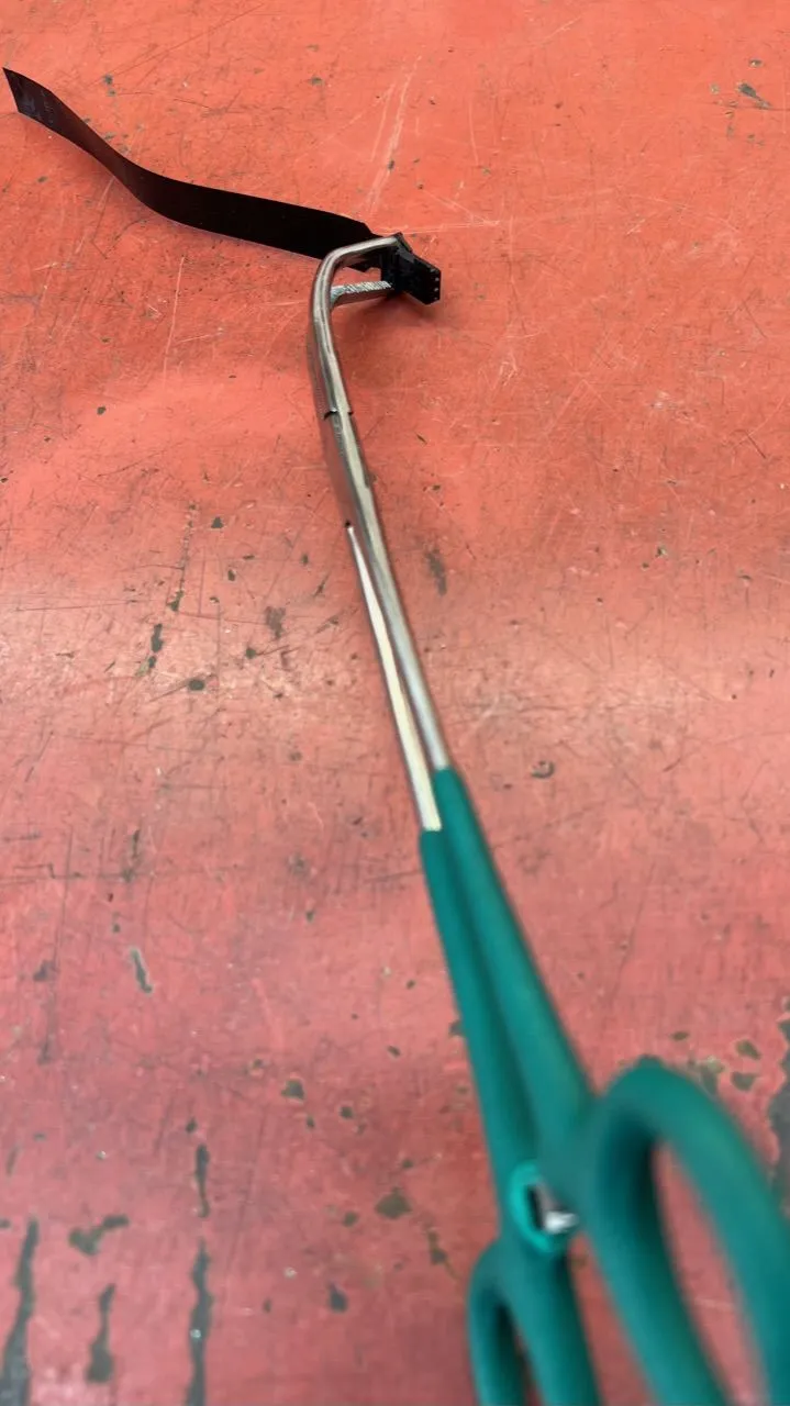

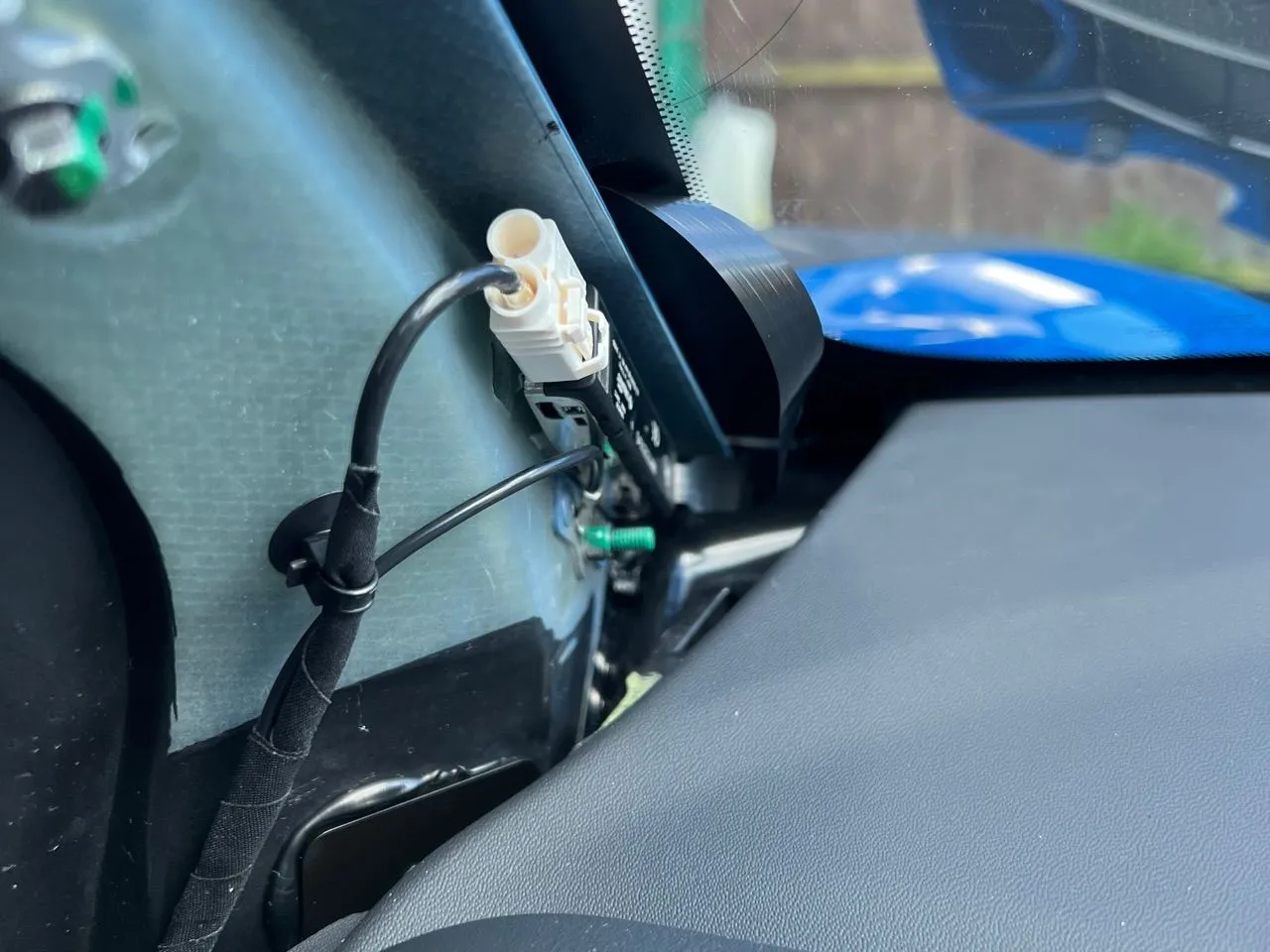

Helpful hint - be very careful with the aerial connectors. FM on the left, DAB on the right. They plug in right at the very front corner of the a-pillar and are bloody fiddly to get in.
DAB is particularly awkward. The ribbon cable is thicker and more springy and the steering wheel is in the way. The connector can easily rip off the end of the ribbon cable if you’re rough with it.
The correct tool is very recommended - long locking forceps:
