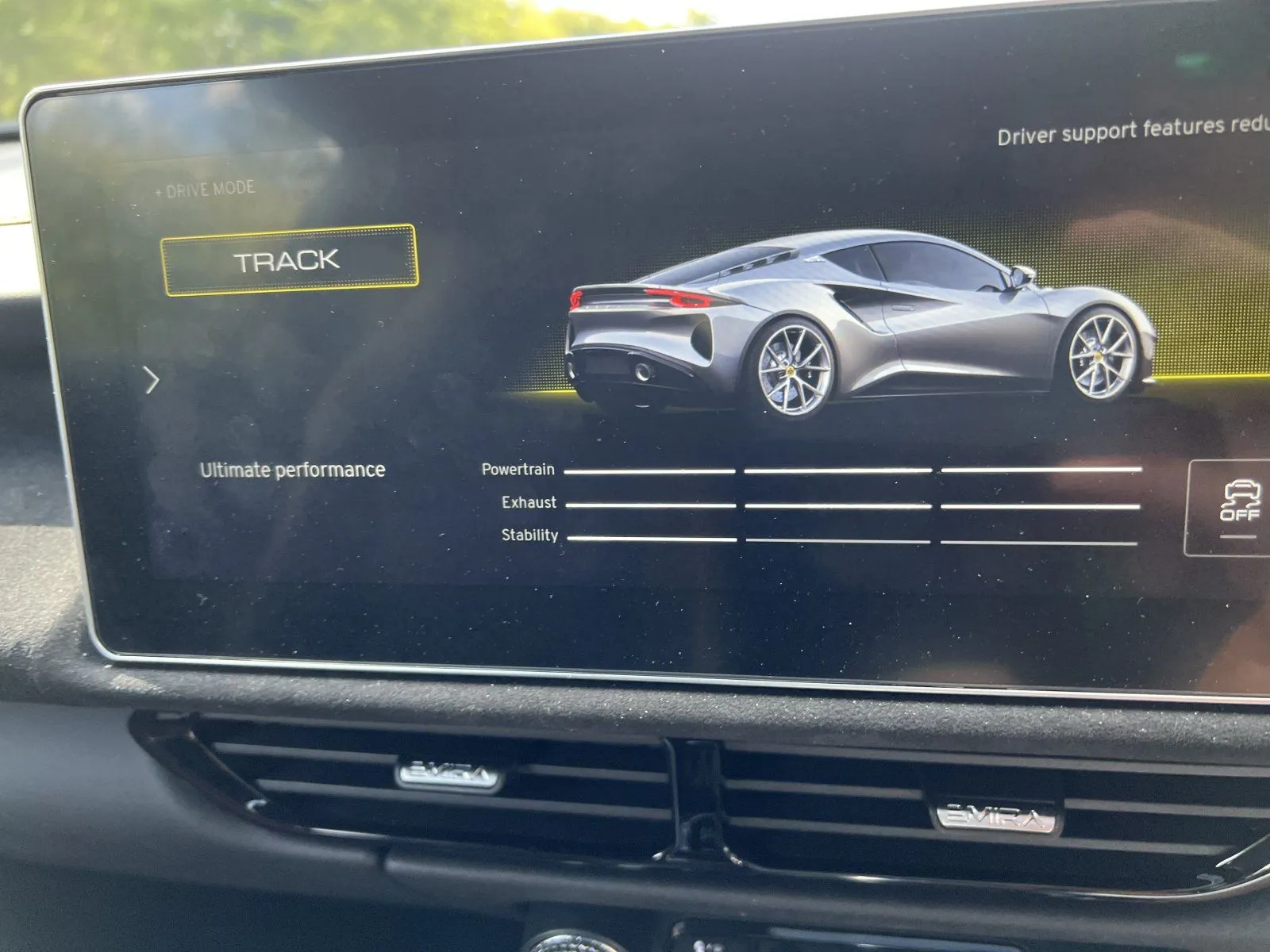

Temporarily lost access to Tour and Sport modes on Saturday. Odd. Not seen that reported anywhere @TomE. Turn on , Turn off, fixed...
Temporarily lost access to Tour and Sport modes on Saturday. Odd. Not seen that reported anywhere @TomE. Turn on , Turn off, fixed... View attachment 29709
Interesting... Probably just a screen software hiccup. Did you try to cycle through the modes anyway? Wondering if you could hear the exhaust note and driver display change as expected... 🤔
Neither the toggle switch or the screen made any difference, stuck in track mode. I'd set off off in tour ( as you do) and went to toggle to sport and somehow ended up stuck in Track!
