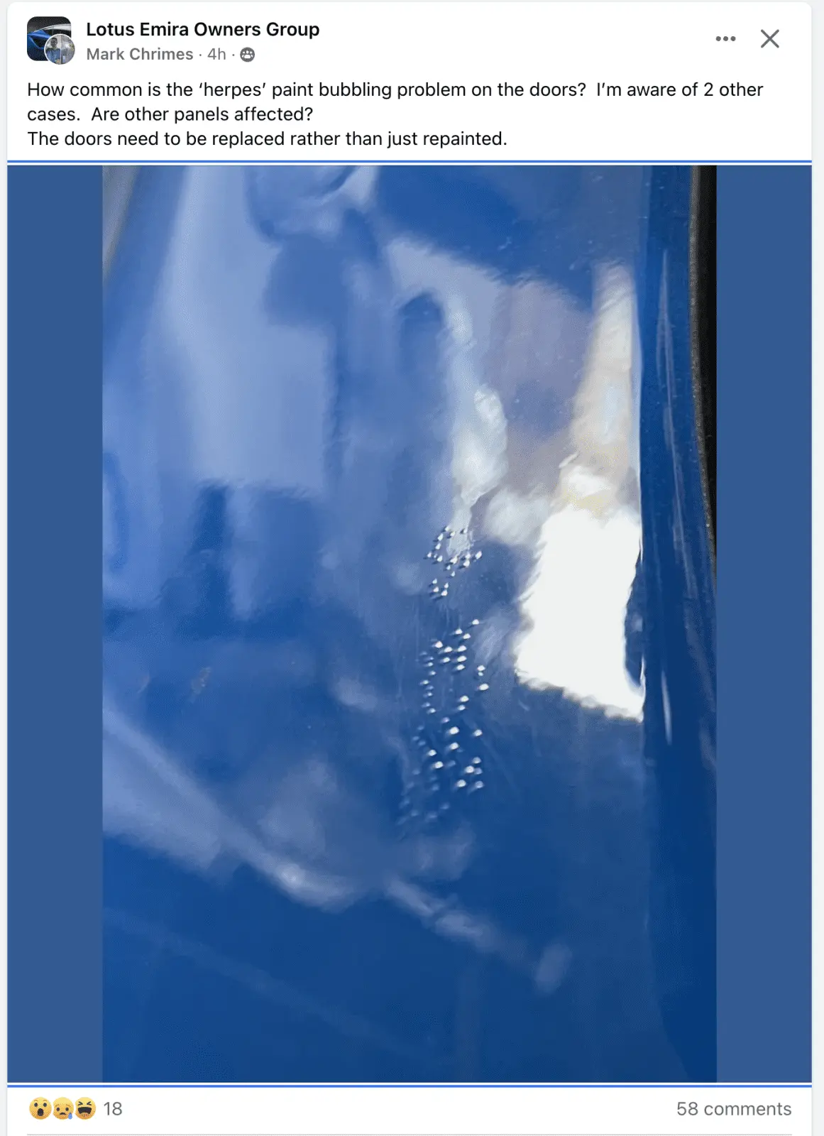

Copied from my "Scoates' Magma Red Emira" thread:
I have also noticed a more concerning issue. There is paint beginning to bubble up on the passenger door. Just noticed today and can't think of anything to have caused it. I've not put any coatings on it, there has been nothing left on the paint to etch in, and only washed with a plain shampoo from Autoglym. Will definitely be getting in touch with customer care ASAP about this one!
Visible in the last image if you zoom in around where the shadow from the wing mirror is. Also some orange peel visible too...

Some information about the issue: https://www.makewoodgood.co.uk/causes-of-osmosis-blistering-grp/
Fixing involves either replacing the panel or a lot of labor to sand down, reseal, and repaint. Simply repainting doesn’t seem to be possible so anyone just being sent back to the body shop won’t get the issue fixed.

Seems that this GRP blistering only happens below the waterline on boats.
Haven’t done much research on this for older Lotuses — if that’s the case I’m guessing there’s a higher prevalence of this in the UK and less so in dry environments like California.
