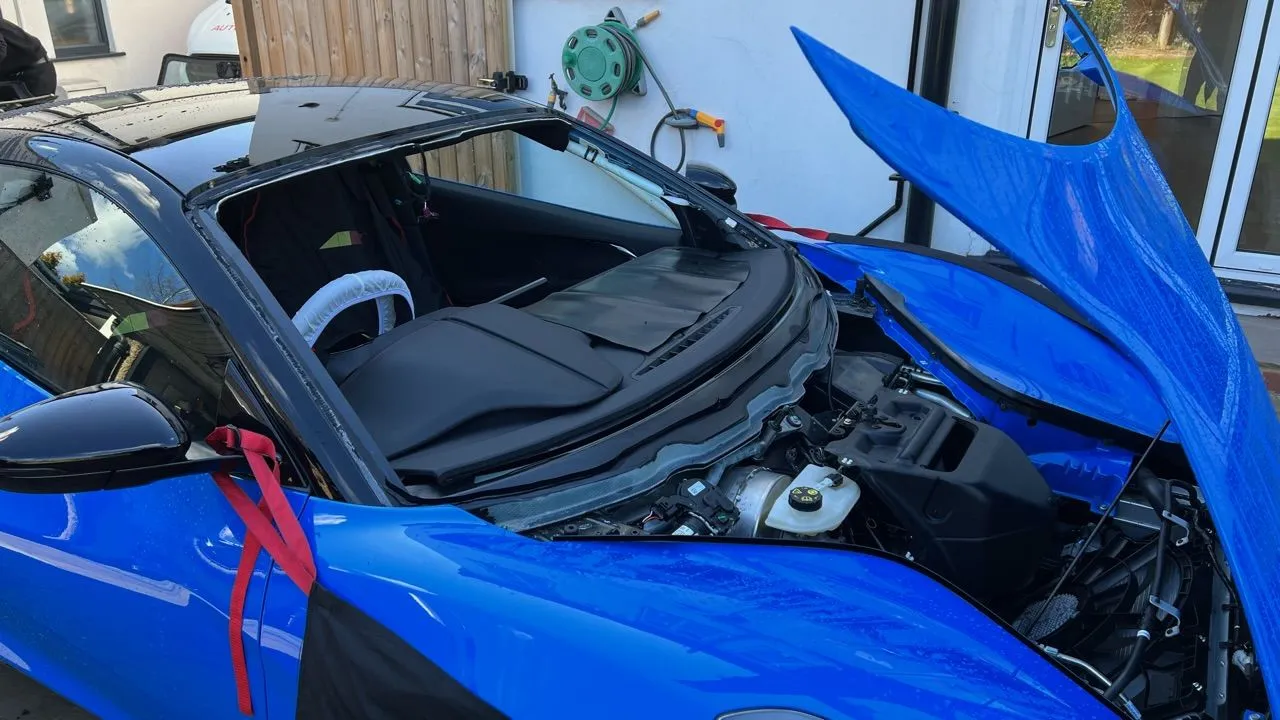

Yup. Cracked by a stone.
But it’s turning into a big adventure.
Screen #3 will be fitted soon, hopefully.
I’ll file a report when the story concludes.

Wow what’s the availability of the windscreen from places like autoglass. Are they always in stock? Or did you have to wait weeks? Lotus or aftermarket windscreen?
I’m using Autoglass through my insurance.
There’s no aftermarket alternatives yet (unsurprisingly) so they (eventually) ordered an OEM one from Lotus.
They fitted it very well. Until they broke the DAB aerial connector.
Hence #3. The glass is £2k a pop. Expensive little connector (for them).

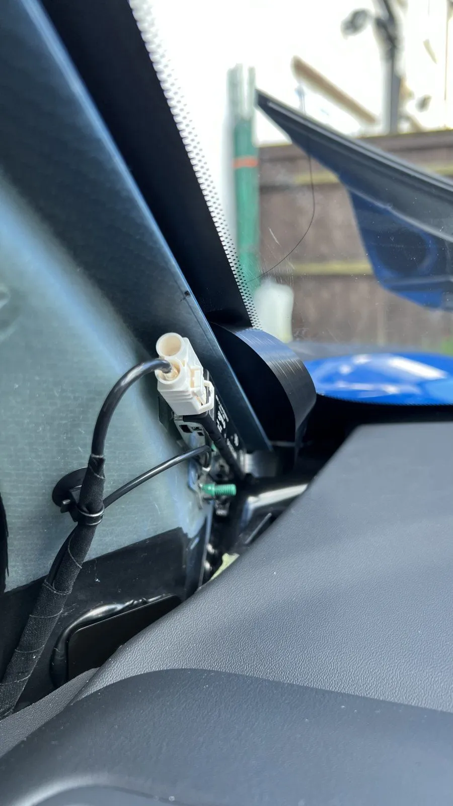

FYI, the DAB aerial is in the RHS of the screen. You can see the two dipole wires going up and down at the side.
Here’s a pic of the FM connector, on the LHS. Didn’t focus on the relevant bit but you can see the ribbon cable coming off the screen looping into the box on the A-pillar.
The DAB setup is a mirror image on the RHS.
