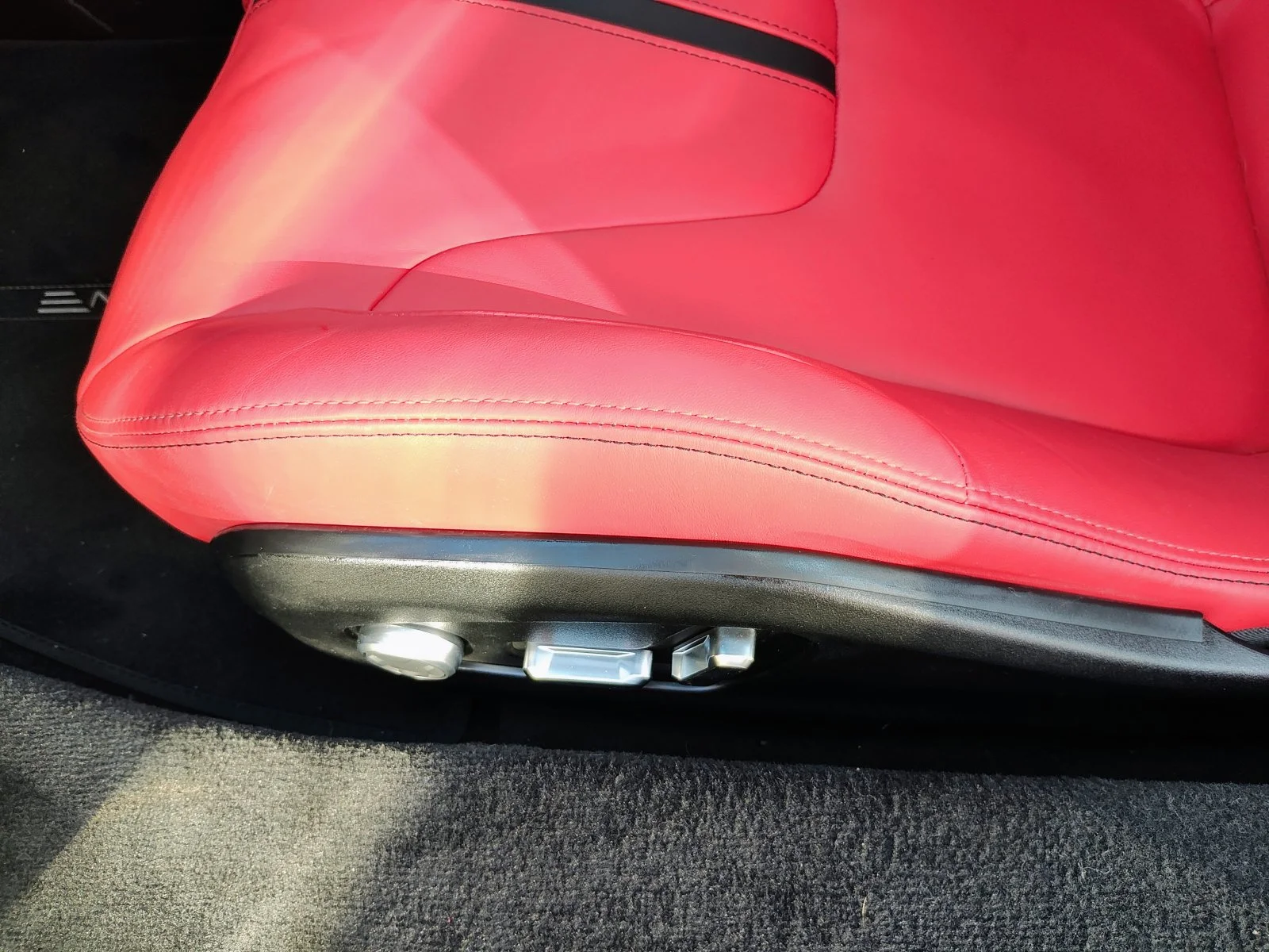

Driver seat issue
That's my worry. The odds of the material being a one off defect is pretty slim. Real leather shouldn't do that.

It's a Bridge Of Weir leather so it should have been OK. We have used this in the past with no problems. It's more likely the sharp plastic edge and over soft foam. At the end of the day the surface of leather is just a paint.
So damn fragile that it was already scarred from the factory......WOW! Any reports of this kind of thing from other markets where the Emira has been on sale longer?

Saw a test drive being done in England on you tube, looked about a year old ( don’t remember the title). As the driver opened the door you could clearly see the damaged side of the seat before he got in. This isn’t a new event…
And like I mentioned, I looked at the sample seats in the factory and at a car coming off the line and the seat trim is super sharp. Like it was cut or molded that way and never deburred or smoothed. You could probably take the seat apart and use a small torch or deburr tool to round it off instead of doing so with trim, but it shouldn't be happening.

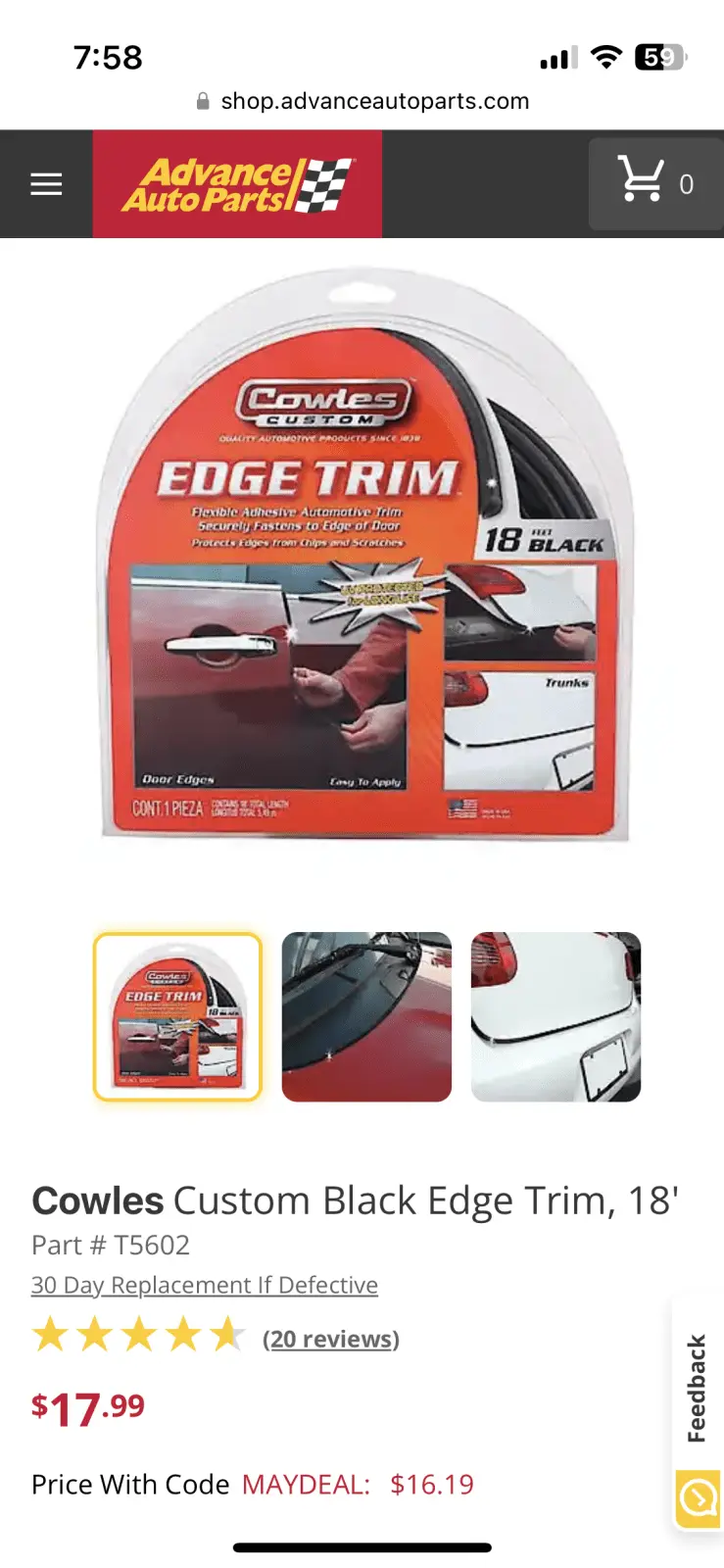

That’s the one I bought
Just purchased the same.......who knew my first accessory for my future Emira would be to address a factory defect LOL!
Much obliged to @Tobiasz17azs and everyone else on this thread. Cracking seats in a brand new six figure car would have been quite terrible to deal with!

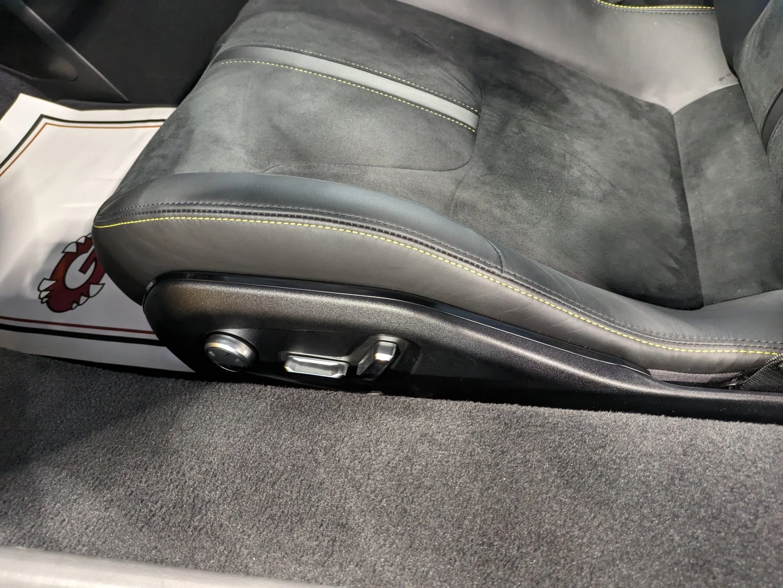

After reading this thread I took note to check that area out next time I was in the car. Sure enough, there is some minor wear at only 100 miles. I ran my finger between the upholstery and plastic trim and a sharp plastic mold line can be felt on the entire length of the edge.
I purchased the linked Amazon edge trim, will be here tomorrow. Thanks for this thread and the solution

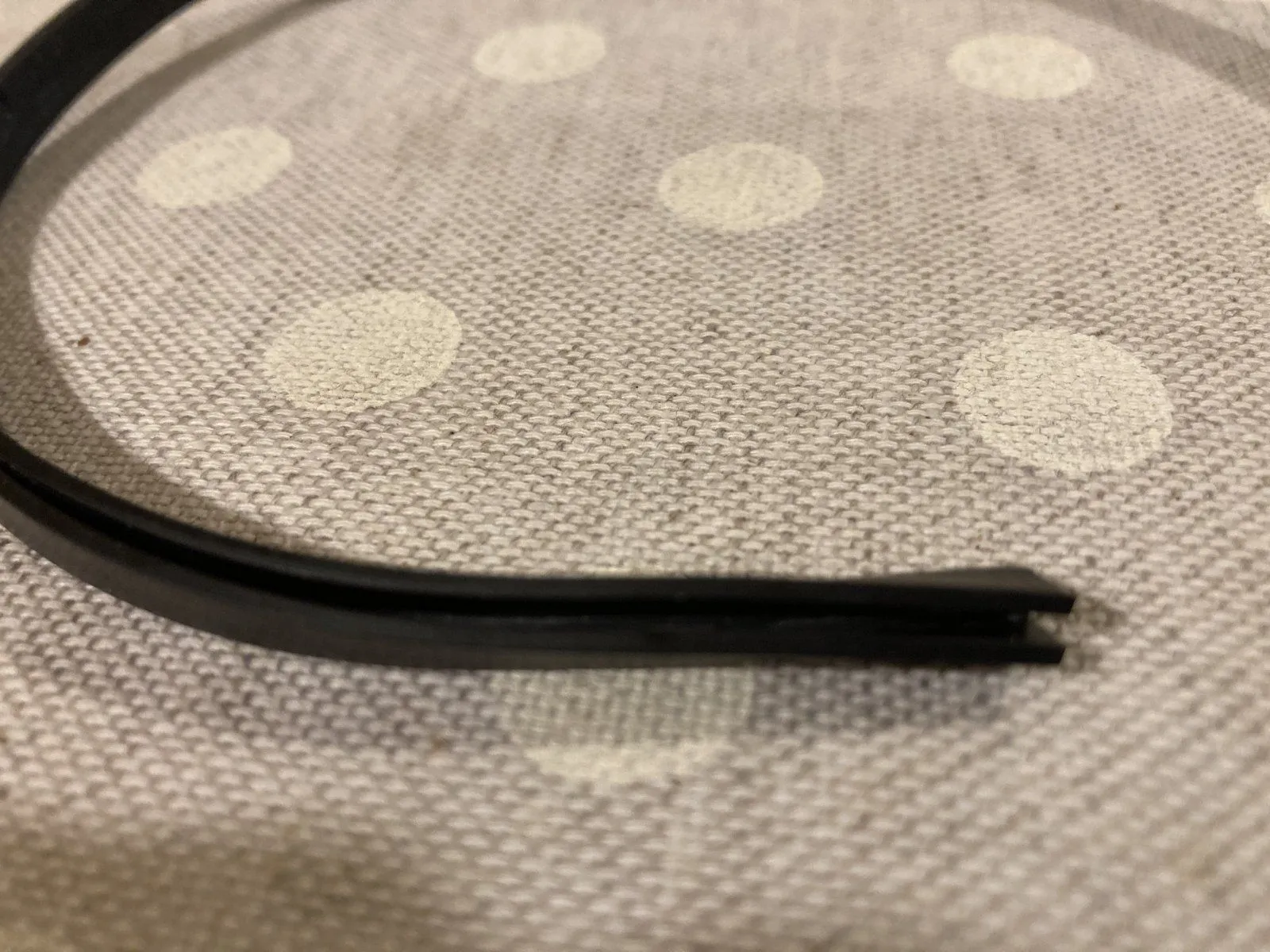

I have a simple solution to this problem. After reading this thread I remembered I had some rubber edge trim I have used before to protect panel edges. Works really well, not particularly visible and took 5 mins to do both seats.View attachment 43500View attachment 43501
Thanks Steve, I bought the same trim and it makes a really neat job. For anyone doing the same fix and struggling to get the trim in place, I found that flattening the trim and feeding one edge into the gap made it fairly easy.
I picked up my Emira Friday and had bought and brought some of this edge trim with me. It took all of 5 minutes to apply it to the seat at the dealership and now I have peace of mind. The car only had 8 miles on it and the seat was undamaged, so now it will remain so!
