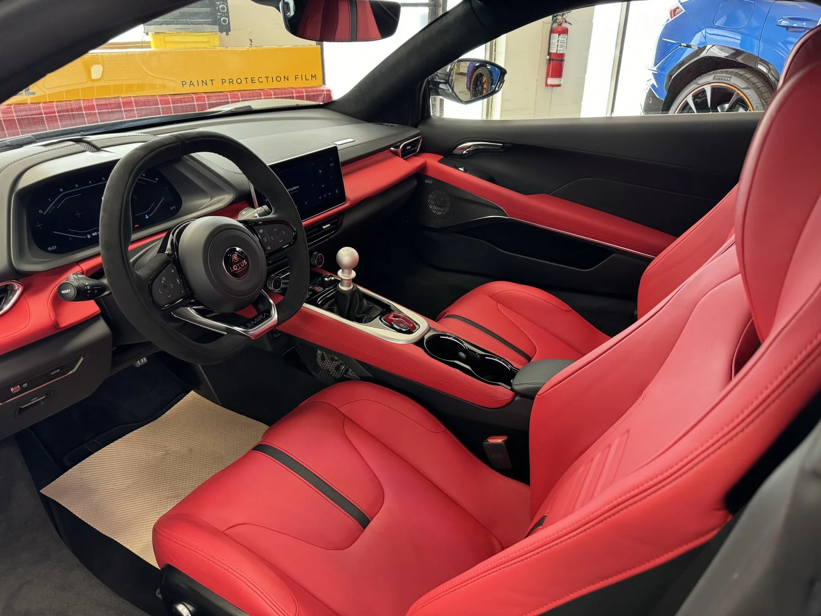

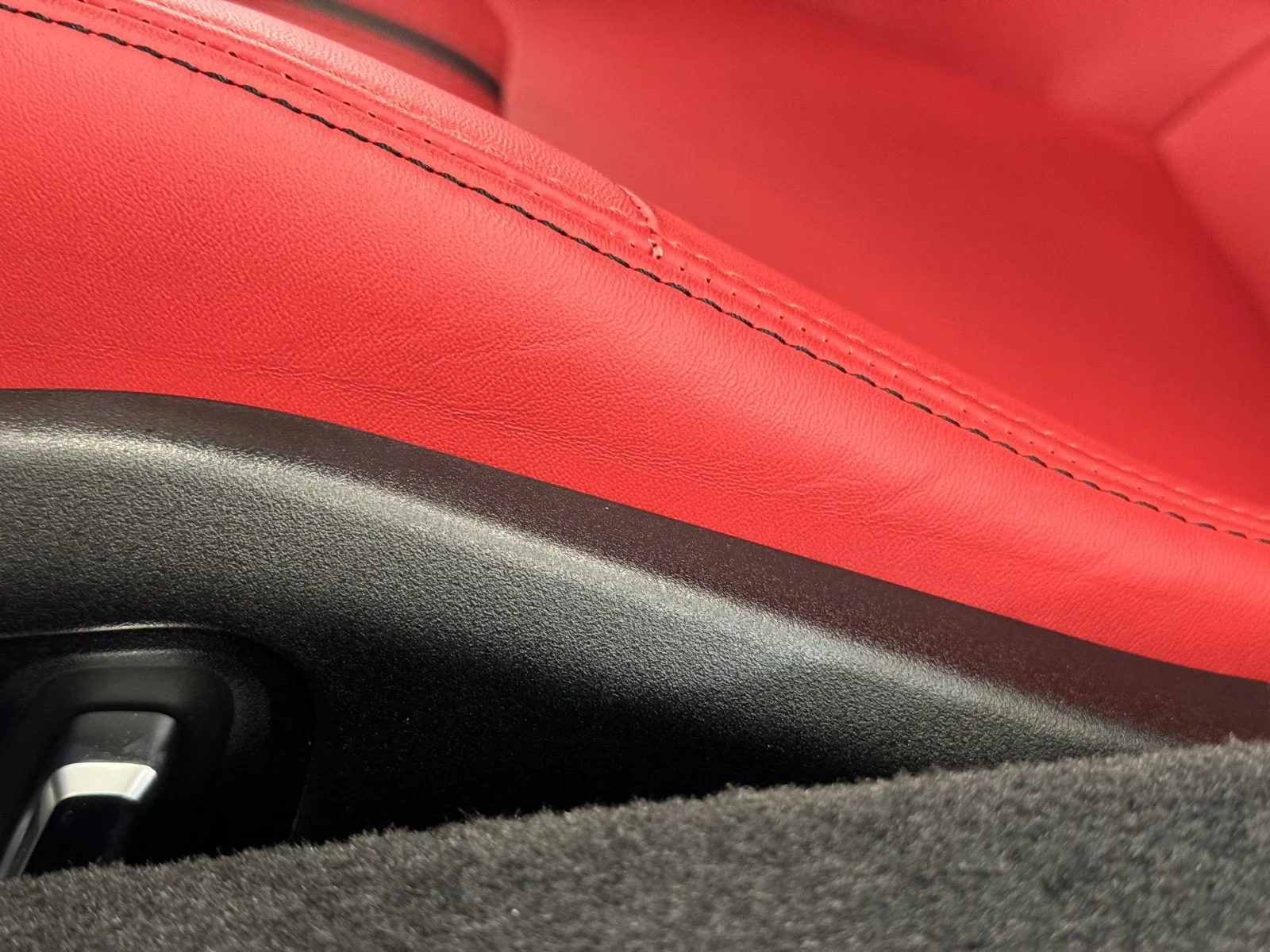

Thought I’d share my experience with everyone following this thread now that I got to see my car this week. The condition of the seats look way worse than I thought they’d be and this is before I sat in my car once. Even the side bolsters look like they have some wear from inconsiderate clowns getting in and out. Pointed this out to the gentleman handling my delivery but they basically said there’s nothing they can do and recommended I start a case with Lotus customer care or something….unacceptable frankly.

Those seats look normal. The distress lines in the leather that are visible in the photo are characteristic of any good leather and are part of the appeal.

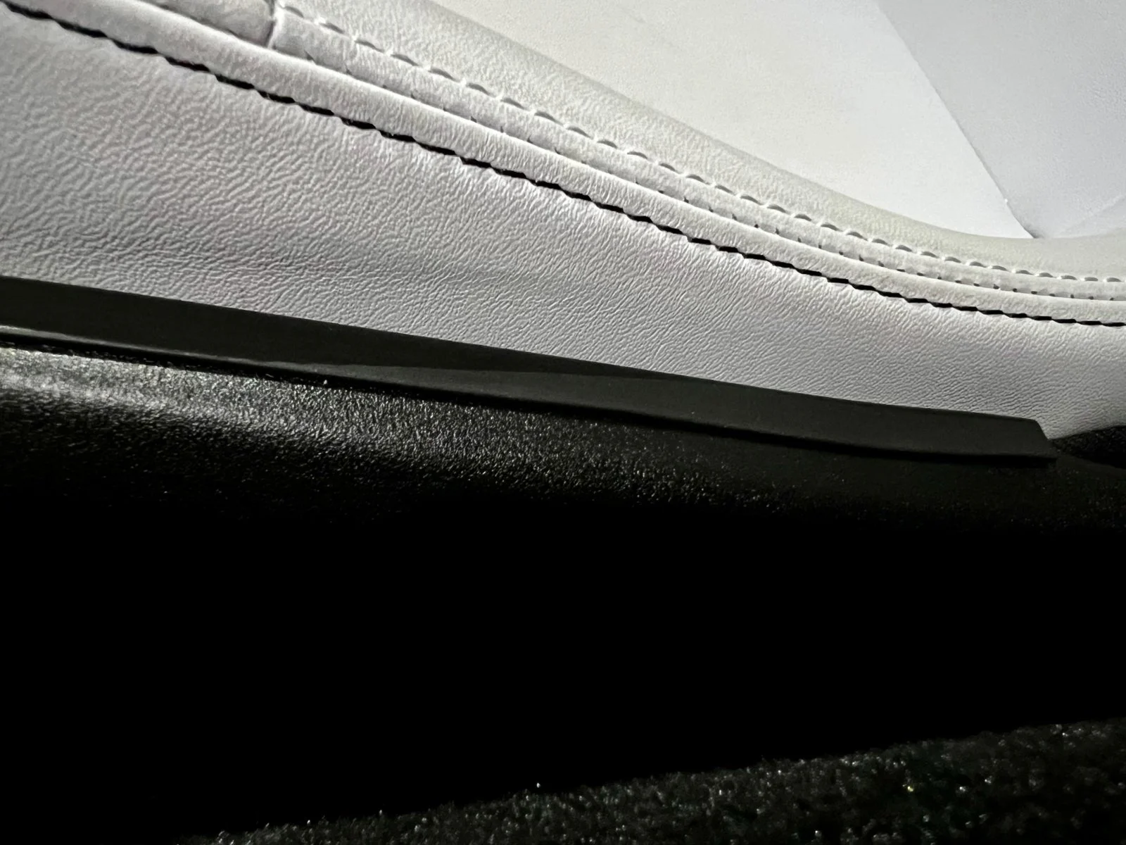

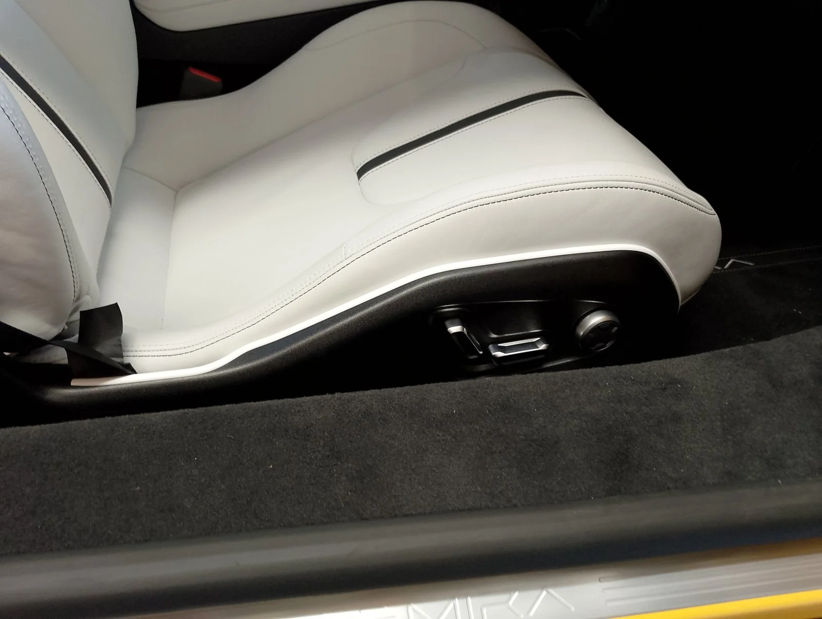

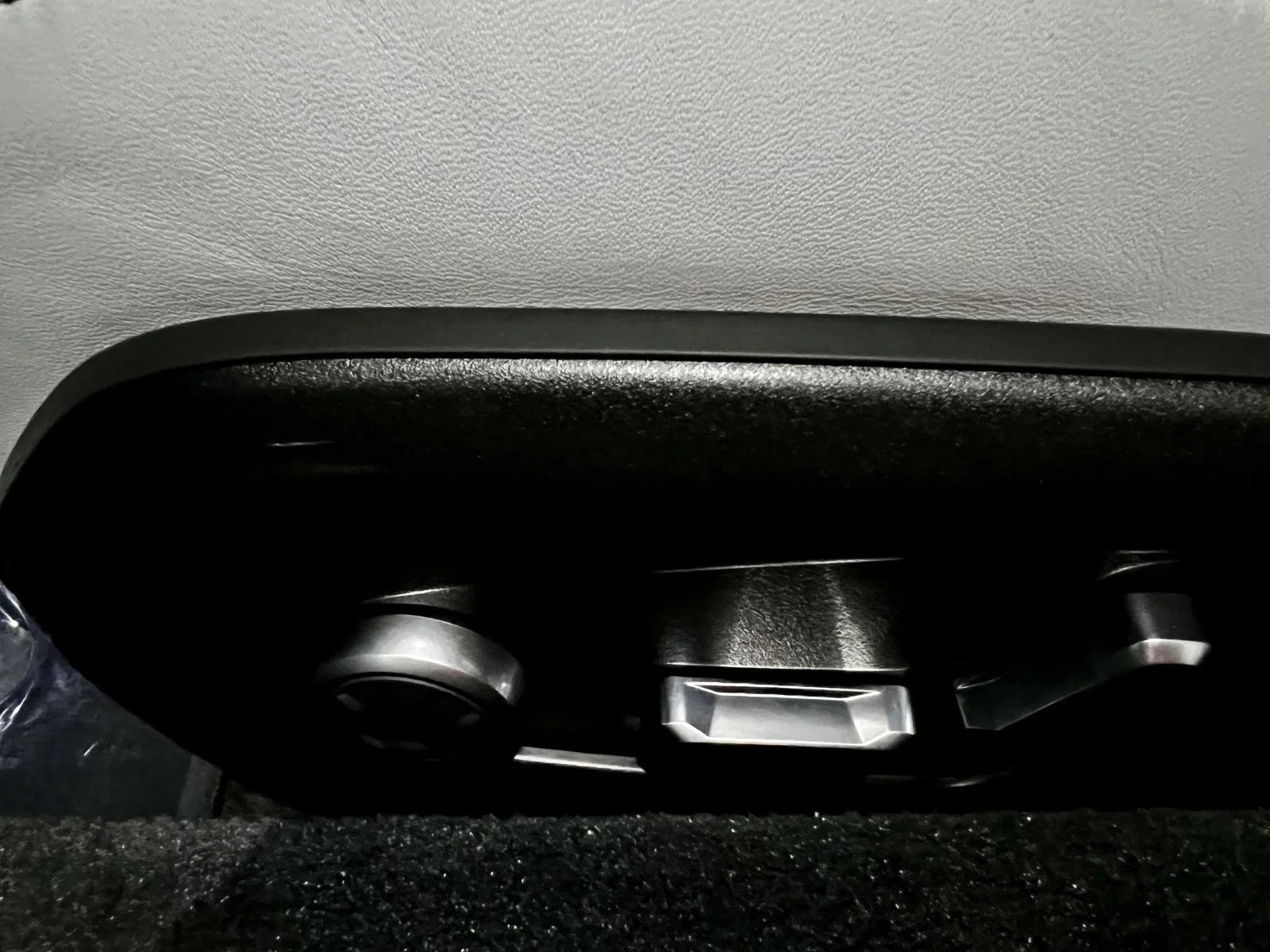

I had some of this white round edging strip so I thought I would see what it looked like and it seems to go with my ice grey seats ok.

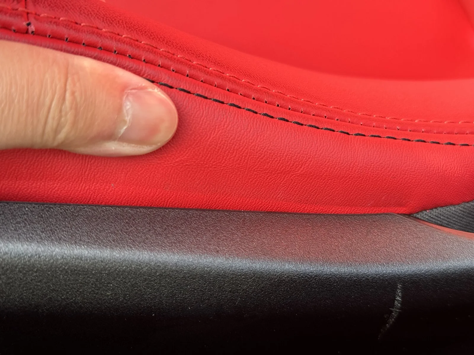

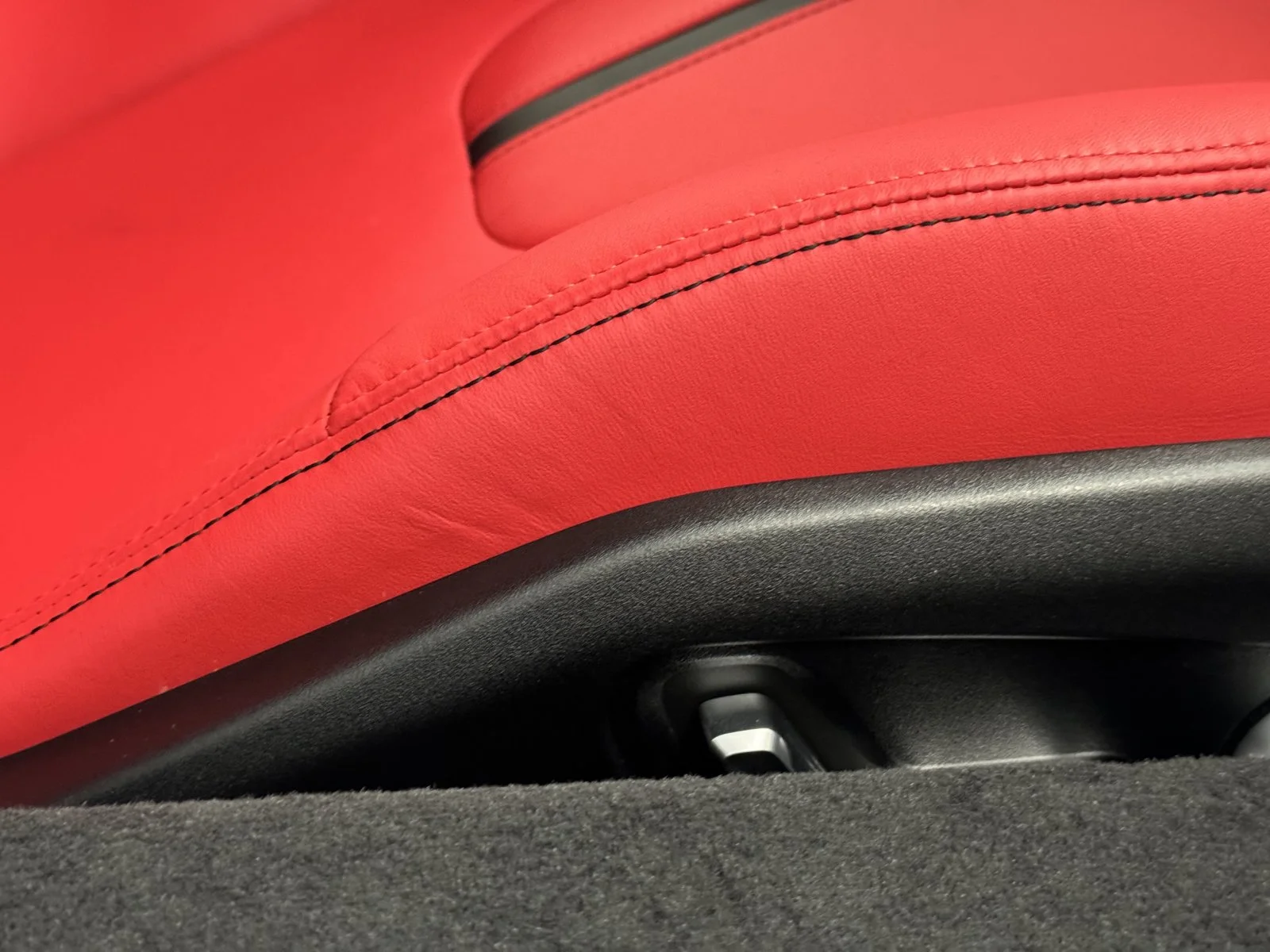

I think this new photo is closer to what everyone else is experiencing. I received the car today and took a closer look. Sure enough, a straight line crease running along the plastic is forming. I’ve ordered the lovely door trim that the brilliant people on this thread suggested!
Picked up my car earlier today and have now added the rubber strip to my seats. FWIW, the ridge of the plastic really did not feel sharp at all, but hey better safe than sorry I suppose.

I have been lazy, I bought what is needed and already put 200+ miles with no issues. Ran my finger through these areas, and no sharp edges. Will still add the mod just to be safe, but have barley seen a crease at this area in my car.

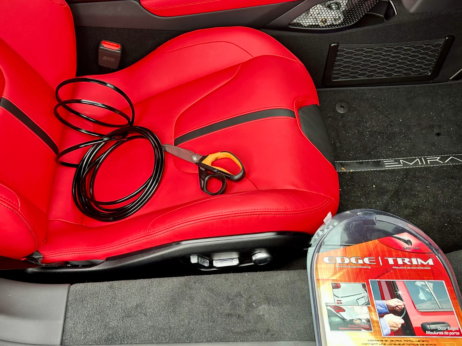

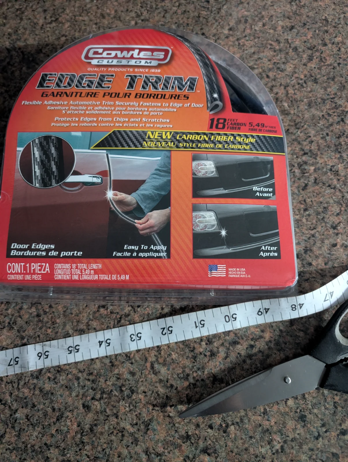

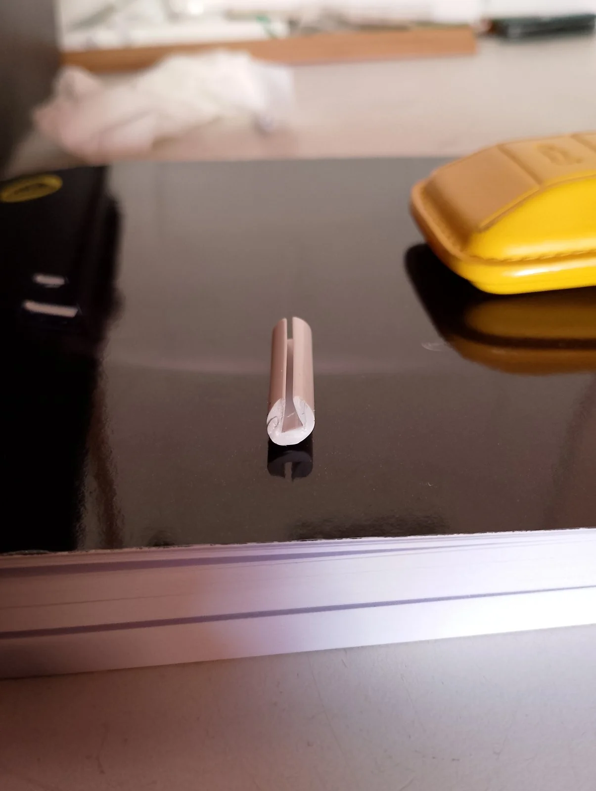

I have a simple solution to this problem. After reading this thread I remembered I had some rubber edge trim I have used before to protect panel edges. Works really well, not particularly visible and took 5 mins to do both seats.View attachment 43500View attachment 43501
I just did mine today. Got the stripping from Canadian Tire. But you can buy it online as everyone said. Easy to do. Fortunately I had no wear at this point.

Yup, I actually installed something like this at the dealership while picking up my Emira...I had a long trip home and didn't want to start off by damaging the seat permanently. I've had the car 18mos now and this has worked like a charm. Mentioned in this documentary...
I will check out your documentary. You are much smarter than I am. I should have done it at the dealership as I had already bought the weather stripping. Fortunately with 400 miles on the car I did not have any wear yet.
