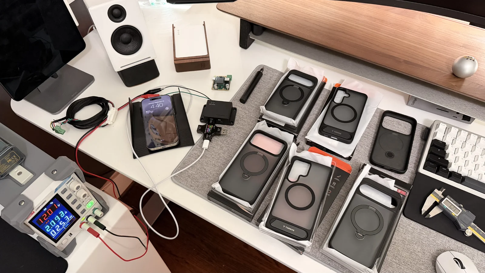

Alright good news. Printed a new universal tray yesterday and ordered a bunch of cases from Amazon to test fitment. The new tray will fit:
- All iPhones with MagSafe (12-17, Air)
- Pixel 8-10 including XL models. Pixel 9-10 including XL models
- Samsung S23-25 normal and Plus (See below for Ultra models.)
The S2X Ultra phones are just too large to fit in the universal tray. They hit the back of the cubby and stick out the front. So like @NicolasB mentioned, the phone will charge (probably at a slower rate) but the magnets won’t hold it.
New Universal tray will fit all 3 S25 sizes.
BUT, I do have a version that will fit those phones. It repositions the magnetic charger pad lower so the phone doesn’t hit the back of the cubby hole. It is also thicker so the bottom of phone clears the center console lip in front of the cubby. Didn’t want to apply those compromises to the universal tray so I’ll just offer this one as a standalone.
*Just a reminder for folks with phones like the Pixel8/9 and Samsung Galaxy. Those phones don't have built it magnets, so you will either need to add a stick on magnet ring (included in the kit) or you will need a case that has built in magnets.*
And one last thing. I’ve had 2 forum members in Europe (Spain and Switzerland) report that their cars did not have the connector behind the glove box. Both V6 first editions. One manual one auto. Because of this I will include a fuse tap kit in case your car doesn’t have the connector, you know, for Lotus reasons lol.
Functionality is the same so you guys can pick if you want to remove the glovebox or fight the fuse access panel!

S25 Plus fits the universal case as well 💪 I've updated the first post with all this new info.
I will reach out with payment info once we get to 10 people
