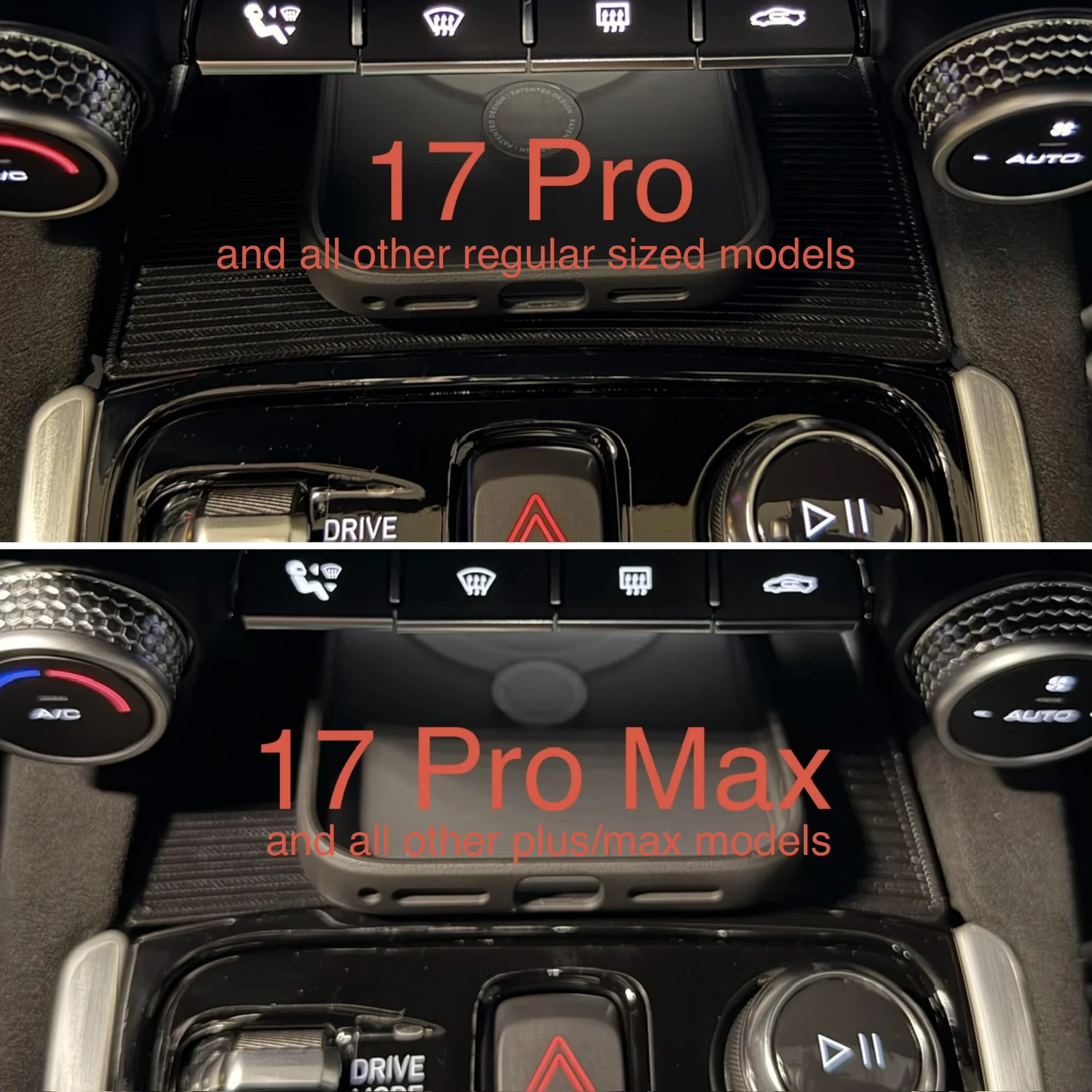

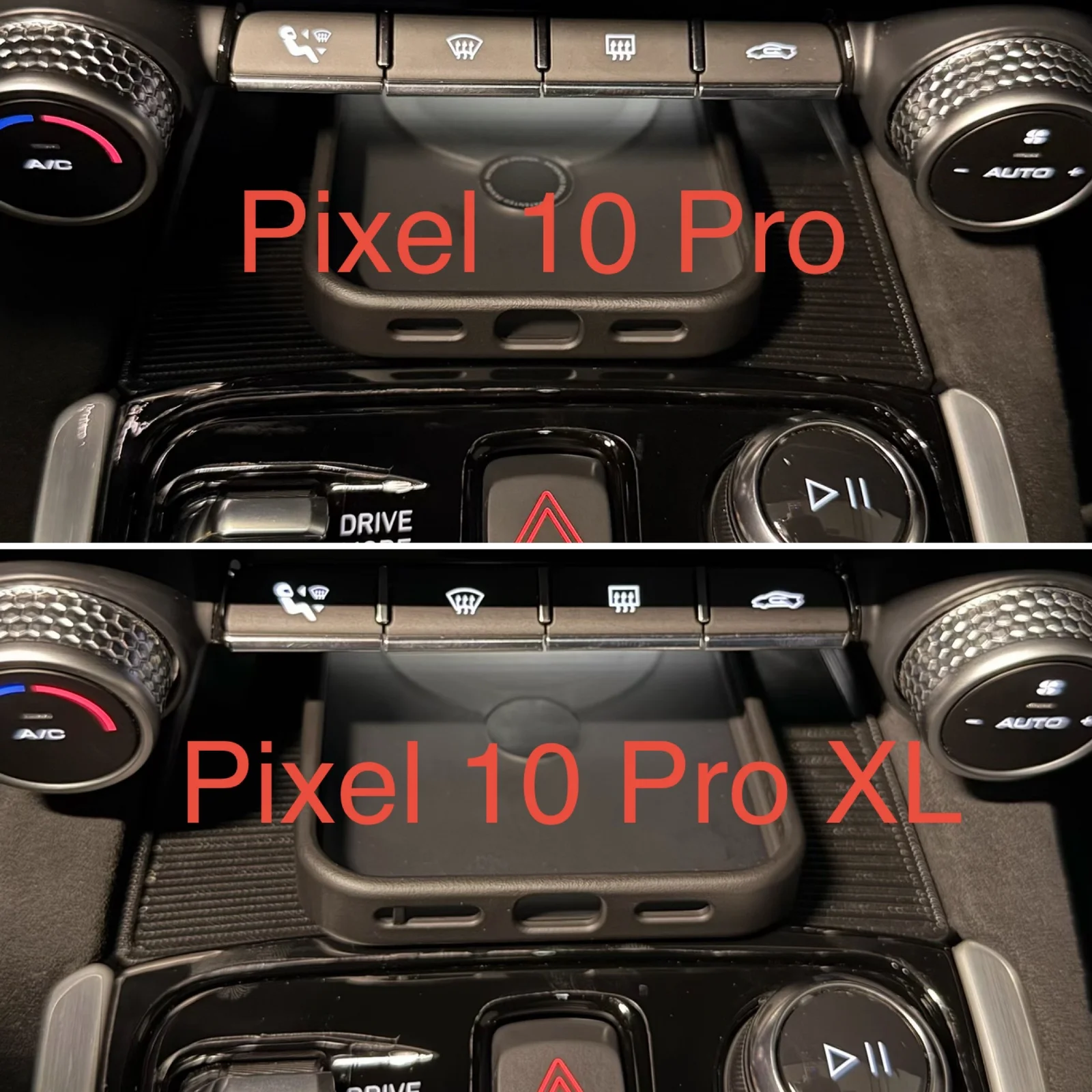

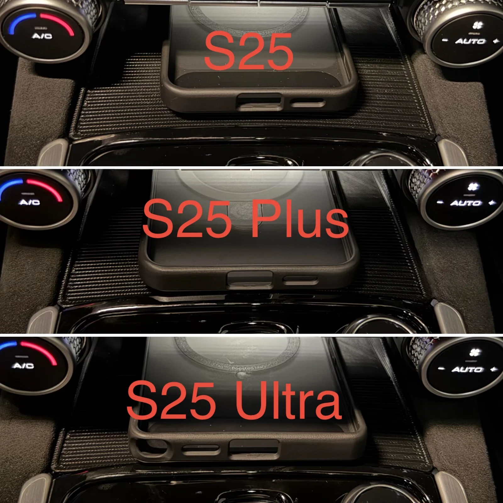

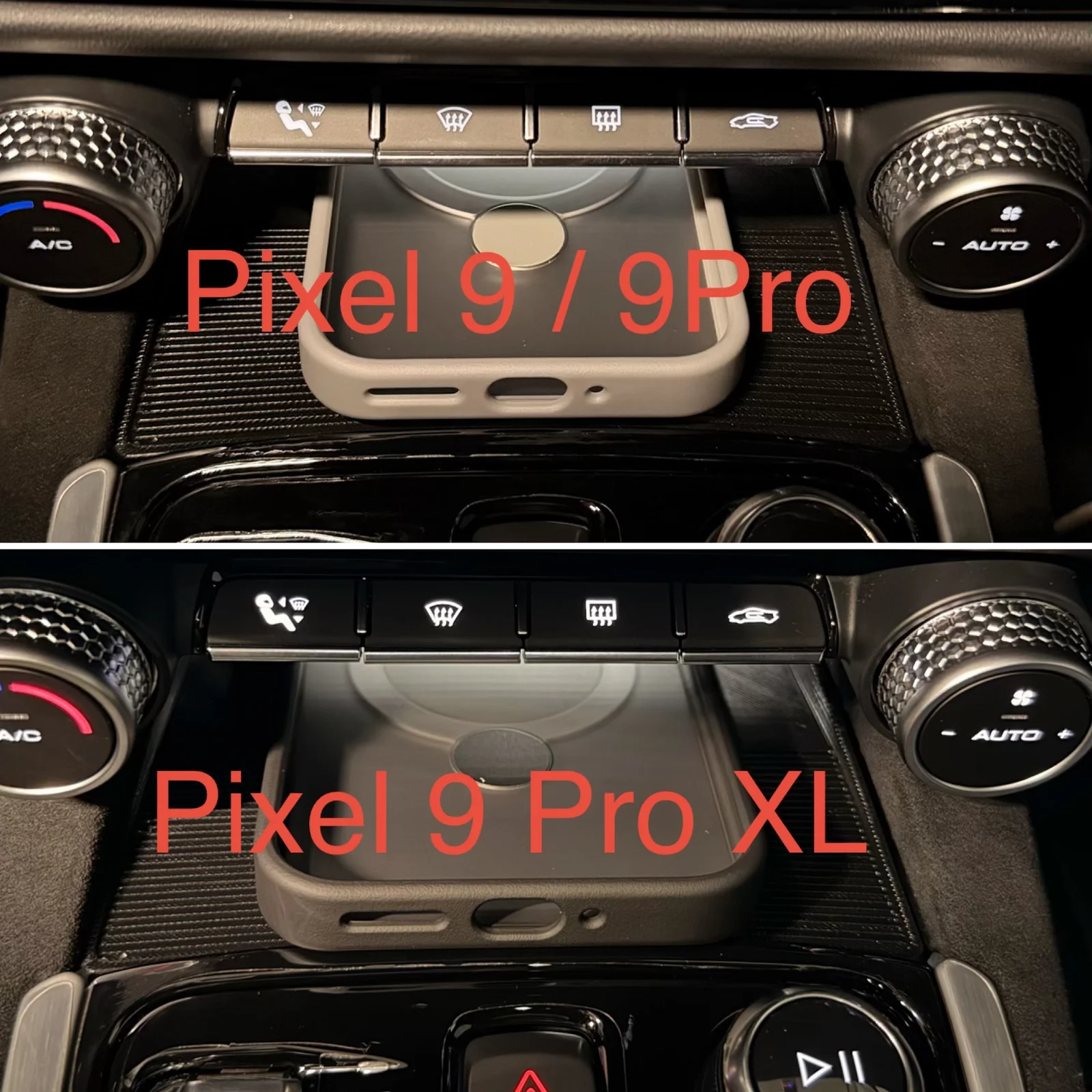

One last update. Spent some time tweaking the universal tray enough so that it fits the S25 Ultra without compromising the other phones too much. The difference wasn’t as bad as I thought.
Here is how they all fit:

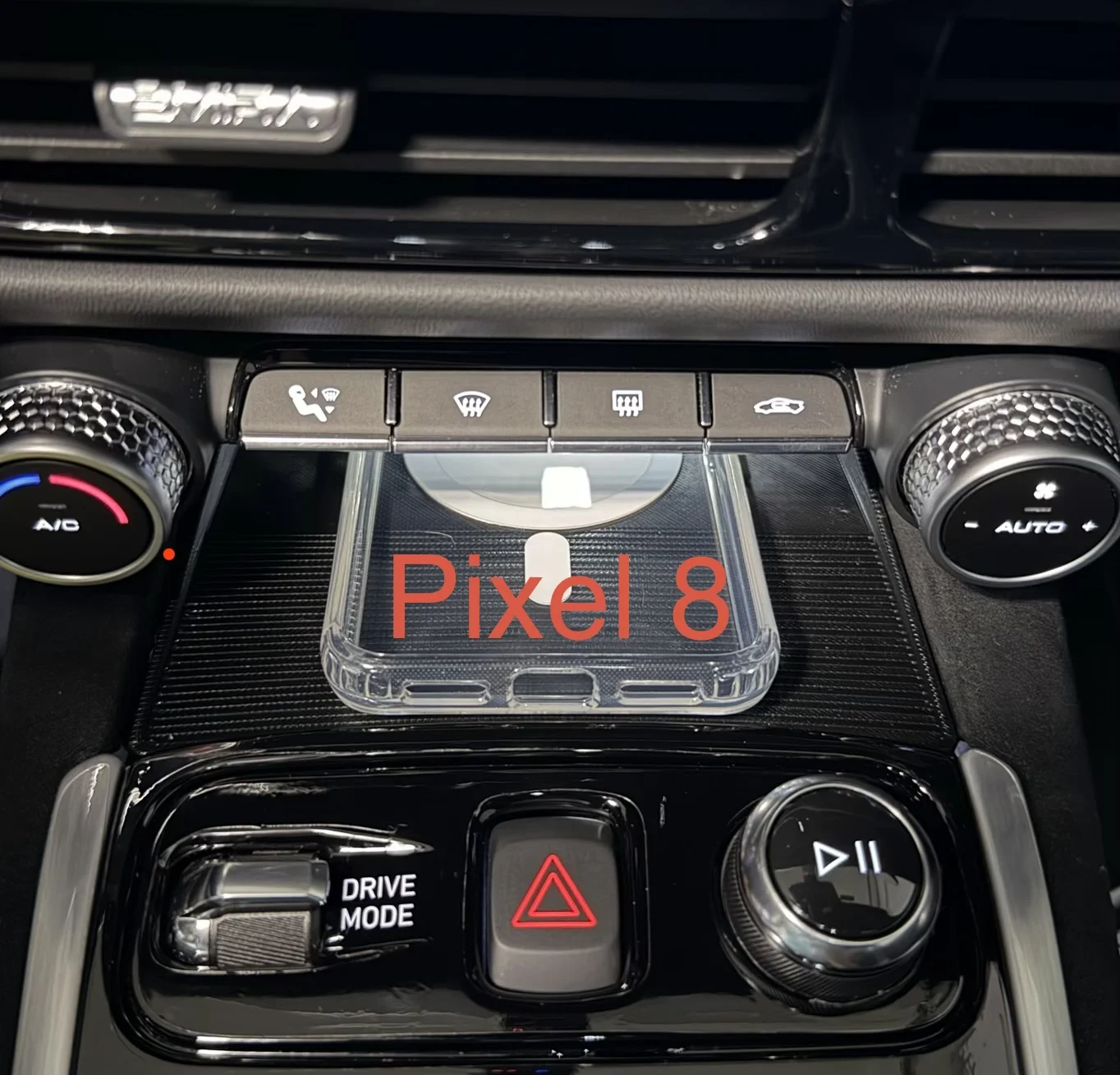

BUT, in the process I discovered/remembered another caveat... The Pixel 8 PRO phones have a very offset charging coil. This means I need to lower the charging pad location quite a bit which in turn results in all other phones sticking out the bottom an extra 7mm or so. This puts them very close to the volume knob.
So while the S25 Ultra will now fit the universal tray, the Pixel 8 PRO needs a tray of its own. Again, said tray will fit other phones but they will stick out more than necessary.
@ross7alex that means that your combination of 8 Pro with 9 Pro XL is not possible unless you’re ok with the 9 Pro XL sticking out.
@Lynxz_ this also applies to you. Just a heads up in case you were planning on using this with other phones too.
@silent cilantro in that case I'll go with the universal tray, since that seems to fit the pixel 9 pro xl perfectly well, thanks! (and my work phone is an iphone, and my wife has an s25 ultra, so it would be great if they're all cross compatible anyway)

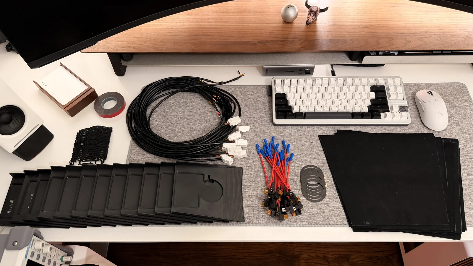

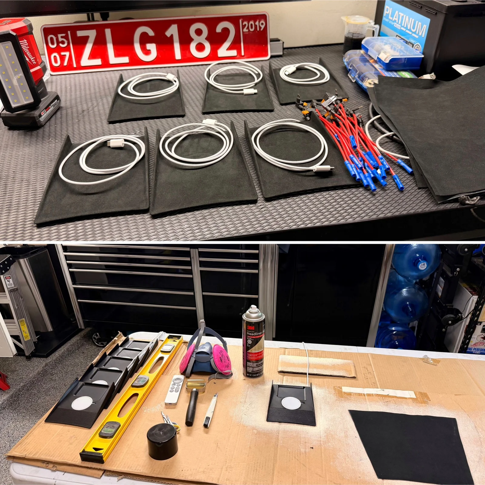

Got the remaining parts yesterday. Testing everything today and then I’ll start upholstering over the weekend.
Sniffed glue all weekend getting these done!
Shipments will go out today or tomorrow, keep an eye on your PMs for tracking info.

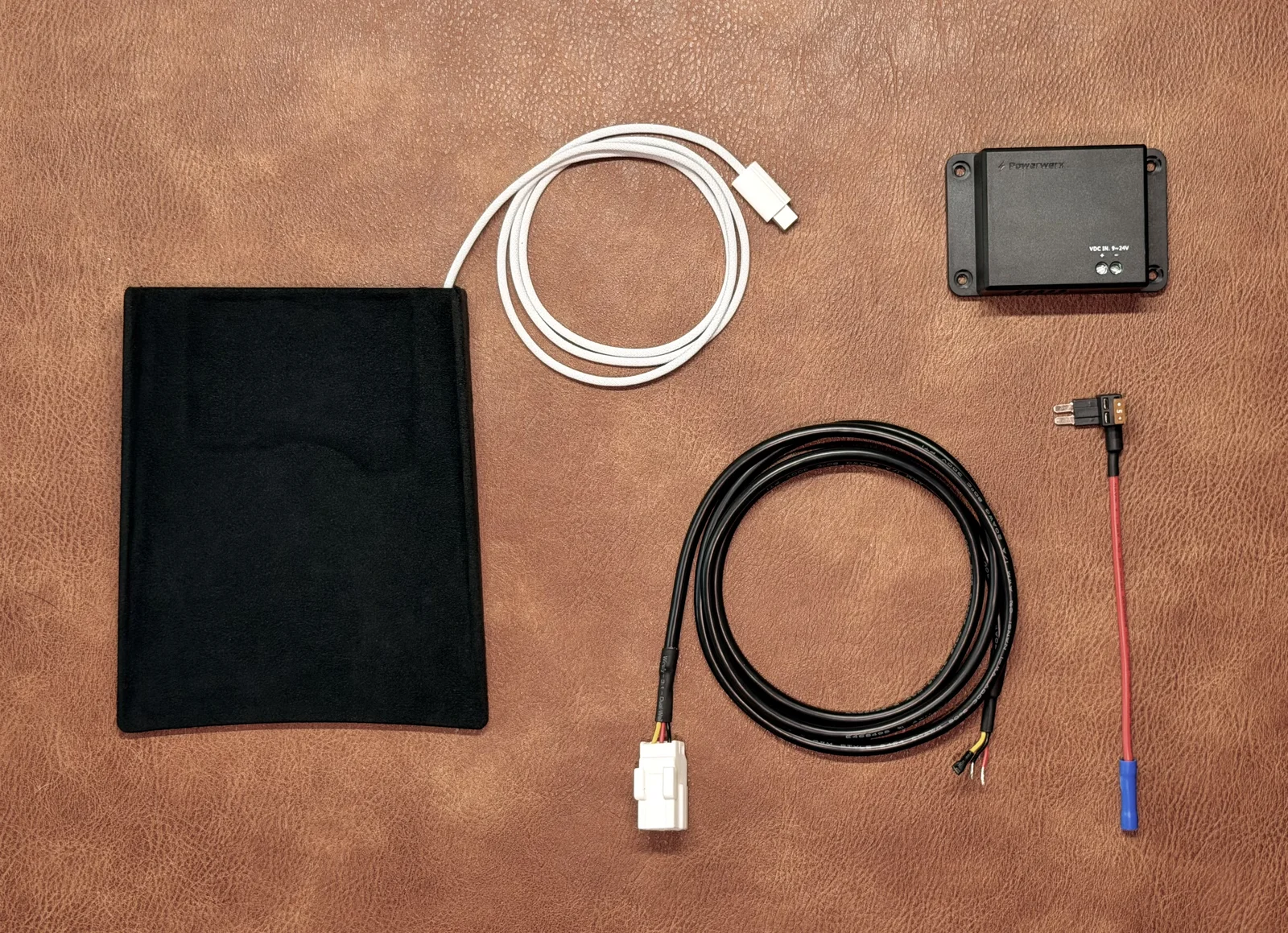

What's the red lead and fuse adaptor for?
Didn't see that in the instal instructions you posted.
Also intrigued by the yellow wire with sealed end?
Jon
It is a fuse tap in case your car doesn't happen to have the connector behind the glovebox. From my post here
And one last thing. I’ve had 2 forum members in Europe (Spain and Switzerland) report that their cars did not have the connector behind the glove box. Both V6 first editions. One manual one auto. Because of this I will include a fuse tap kit in case your car doesn’t have the connector, you know, for Lotus reasons lol.
I will update the instructions once I get these shipped out.
Jon
The connector behind the glovebox has 3 pins (ign, bat and ground). The yellow wire is the unused bat connection with constant 12v. The cable I use has 3 conductors so I just extend the yellow wire in case anybody wants to:
1. Cable the charger so it works with ignition off (not recommended as it could potentially drain your battery)
2. Use the cable to power another device such as a dashcam with parking mode.
Basically, it is extra and not used for the charger but it's there if you need it.

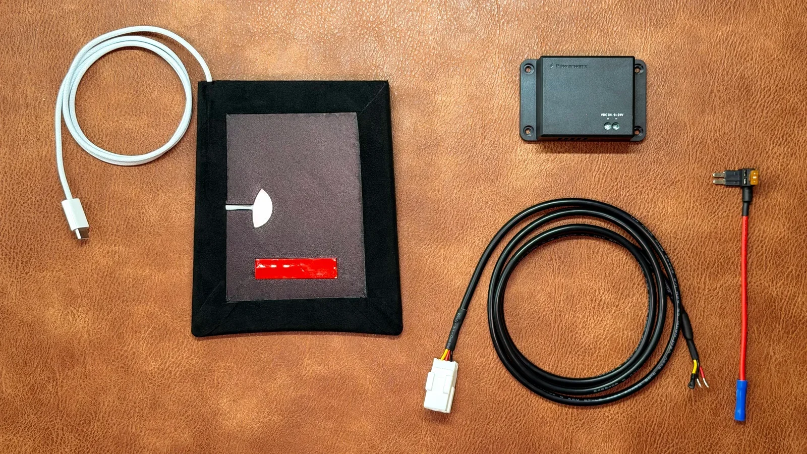

One more update to the tray I forgot to mention. There is strip of double sided tape that is partially recessed in the under side of the tray. This is to keep it from lifting up when taking your phone out of the cubby.
