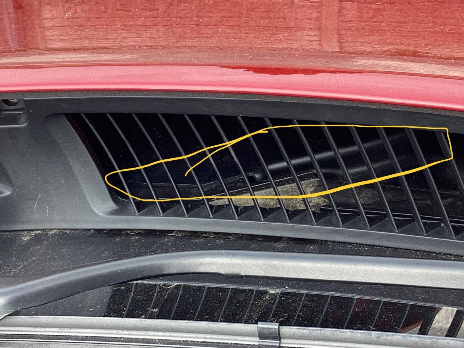

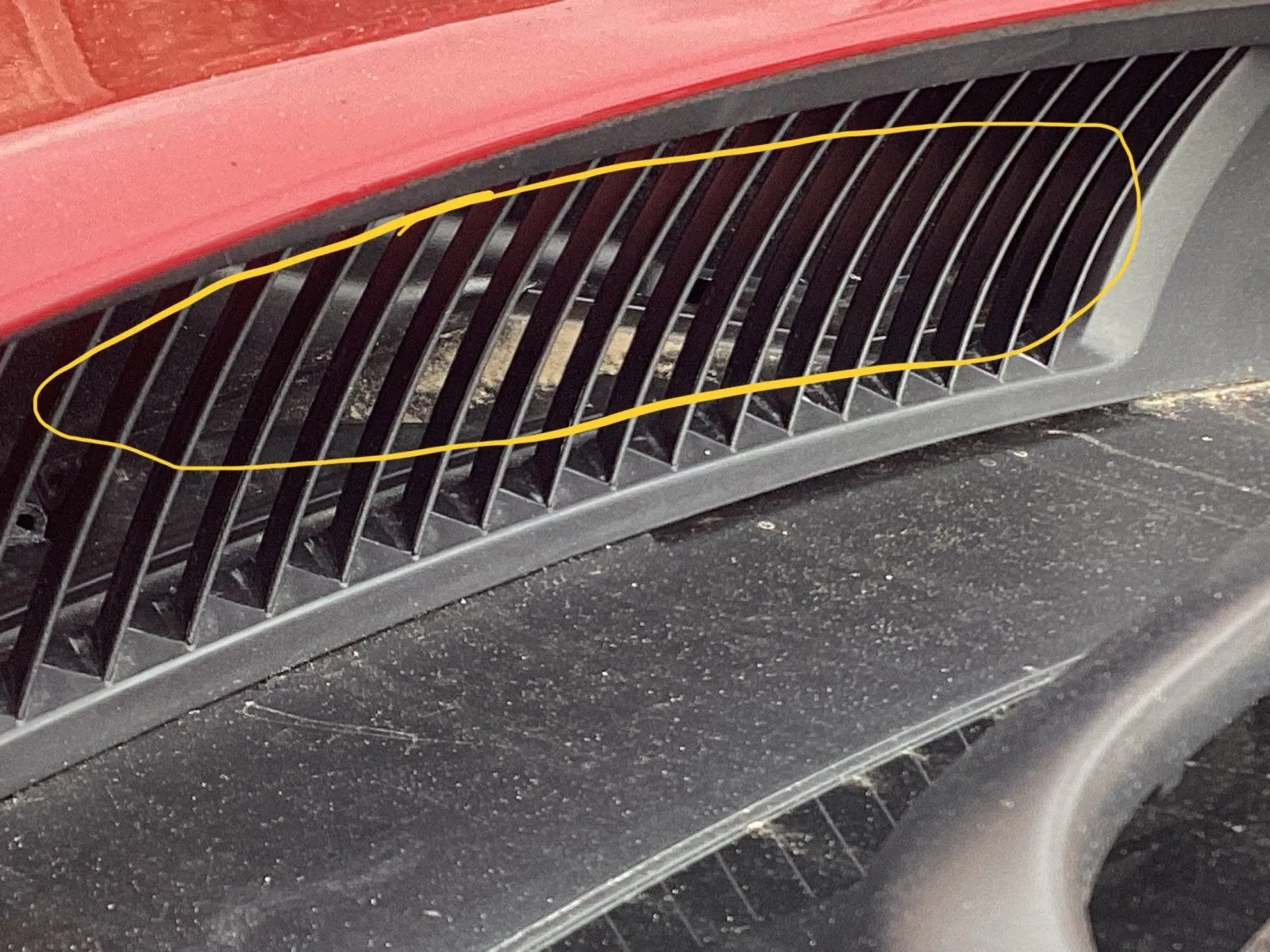

Update on my car I’ve picked it up from the dealership and the HVAC has been fixed and they changed the wiring harness and i am one of the first to have the new cover of sorts fitted just under the grill between the windscreen and the bonnet (hood)Sorry to the carbon fibre guys probably more weight. see pics my car is very dirty at the moment but you can see the new clean rubber cover that keeps the water off the HVAC unit and wiring harness. I asked the dealership not to wash my car because I got PPF Fitted and wanted to wash it myself.
I asked how much it cost to carry out this repair and it’s just over £14k for parts and labour, Happy its all done under warranty and great to have my car back all the panels are replaced perfectly and no squeaks rattles or scratches
also all updates and my first service done so big thank you to the Bristol dealership, so looking forward for some nice weather and trouble free motoring 👍

£14k :oops: or £1.4k ?- it's around 10 hours labour maximum and a £40 part for the HVAC resistor replacement, plus the new rubber shield..... £14k sounds like either a LOT or a typo.....

the 14 k was also for the wiring harness and that’s a 25 hour job £150 a hour plus all the parts and it’s a complete strip down of the car all the body parts off

The good thing is you can visibly see if the corrected part(s) have already been installed from the exterior thanks to @Tonygcar.
