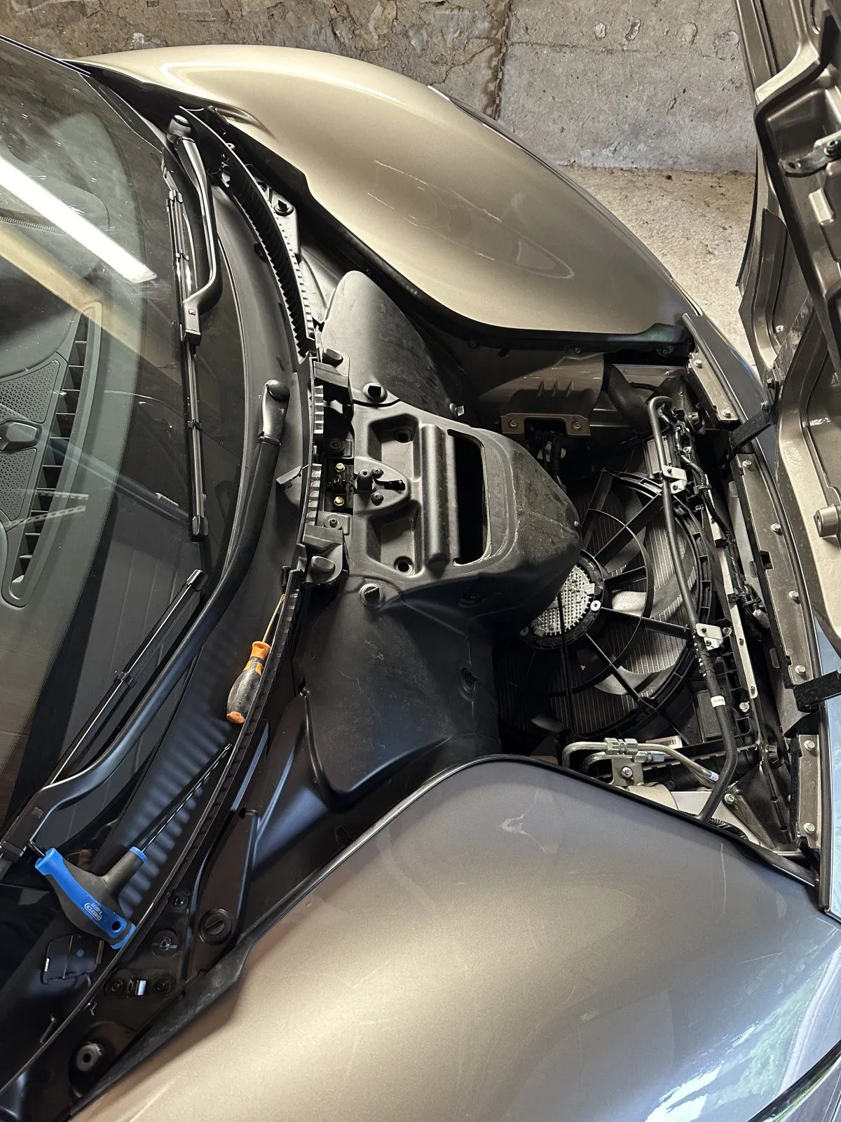

Does anyone have a picture of the front bonnet open ? I'm trying to figure out if I had the so called shield fitted (it looks so) but idk how it looked before. I remember some member with a blue emira long time ago took a picture of the bonnet open but I just couldn’t find it to see the difference. Or maybe someone can confirm if it has been installed or not (added pic). Thanks in advance :)

Good pic. Can someone draw an arrow showing where the A/C resistor is located?
Using the pics of a shield that was already installed from earlier in this thread…
It appears the shield would be here somewhere…
Can we get better pics of this area @Shahaf2911 ?
From others’ descriptions of the repair, this area “funnels” water down into the deeper recesses of the car where the resistor is located. That’s why they have to take fenders off. I don’t believe the resistor is visible with just the hood up. The shield prevents the funneling of water from what I understood. If that’s incorrect someone else speak up.

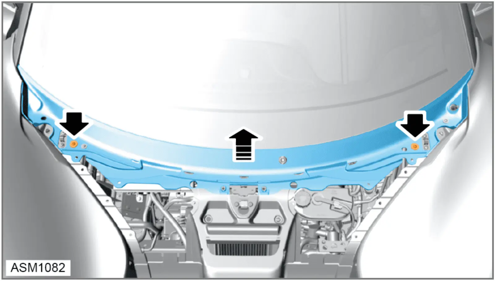

Here's an image from the service manual for removing the windshield. It doesn't show those wings on either side of the central boxy thing like you have that covers all that stuff you can see in this graphic.
