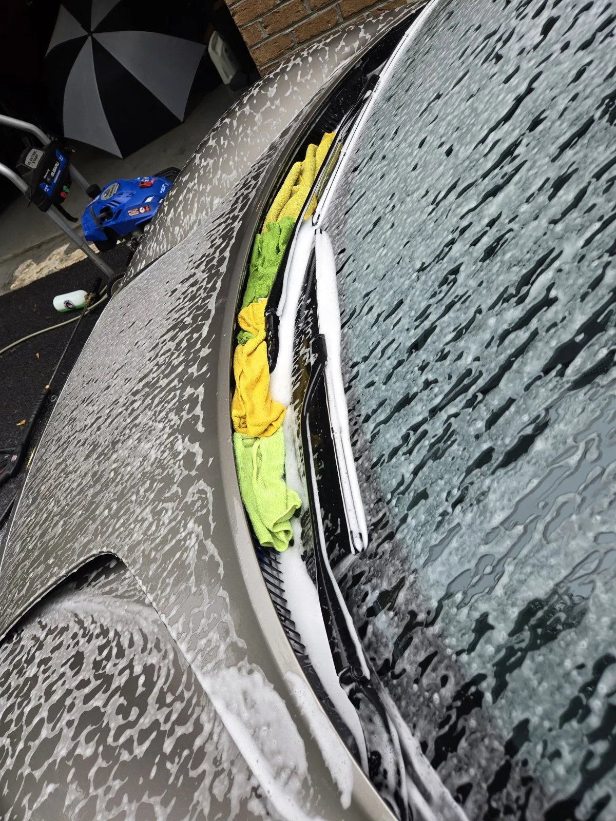

@Nova any updates on your experiment?
No news is good news? I washed my car over the weekend and placed towels on the vents to limit water spray.
This is the way.
Btw, any areas to cover on the rear deck lid or trunk? Does the engine bay just get all wet during a car wash?
Hmm... I didn't check the rear hatch. I angled my pressure washer away from the opening most of the time.
