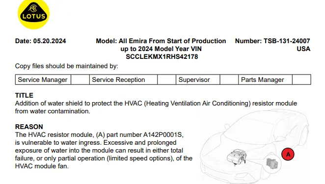

Air con known issue -no fix yet [EDIT: now with official fix]
It would be nice if someone near a dealer could find out what the VIN range is for the cars this TSB applies to.
I can inquire when I get my car back some time this week or early next week
Here you go!

Just picked up my car after the hvac tsb has been performed. A/C works as expected, the dealer - the Lotus of North Jersey - told me they are not delivering cars anymore unless the diaper (their term) is installed.
My concern with this would be is the fan resistor pack already damaged when they put the protective diaper on it, or is it in 💯 working condition? I’d hope they’d replace the diaper AND the resistor just to be safe.
A lot of the cars are experiencing partial failures that aren’t really evident to the owners. Weak fan speed, intermittent functions, etc… There are a few people in this thread that didn’t realize a fully functioning AC fan should sound like a jet engine and not the weaker fan speed they were semi content with.

Absolutely. Mine was broken from day one and I didn’t know. Just thought the AC performance was subpar on this car. After it was fixed it almost blew me out the windows 😂
I spoke with my dealer yesterday. They are aware of the A/C resistor issue and are attempting to correct affected cars with updated parts prior to delivery.
What I'm curious about is if anyone with a VIN higher than 2178 has been affected? 2179 and above are supposed have the fix installed from the factory
