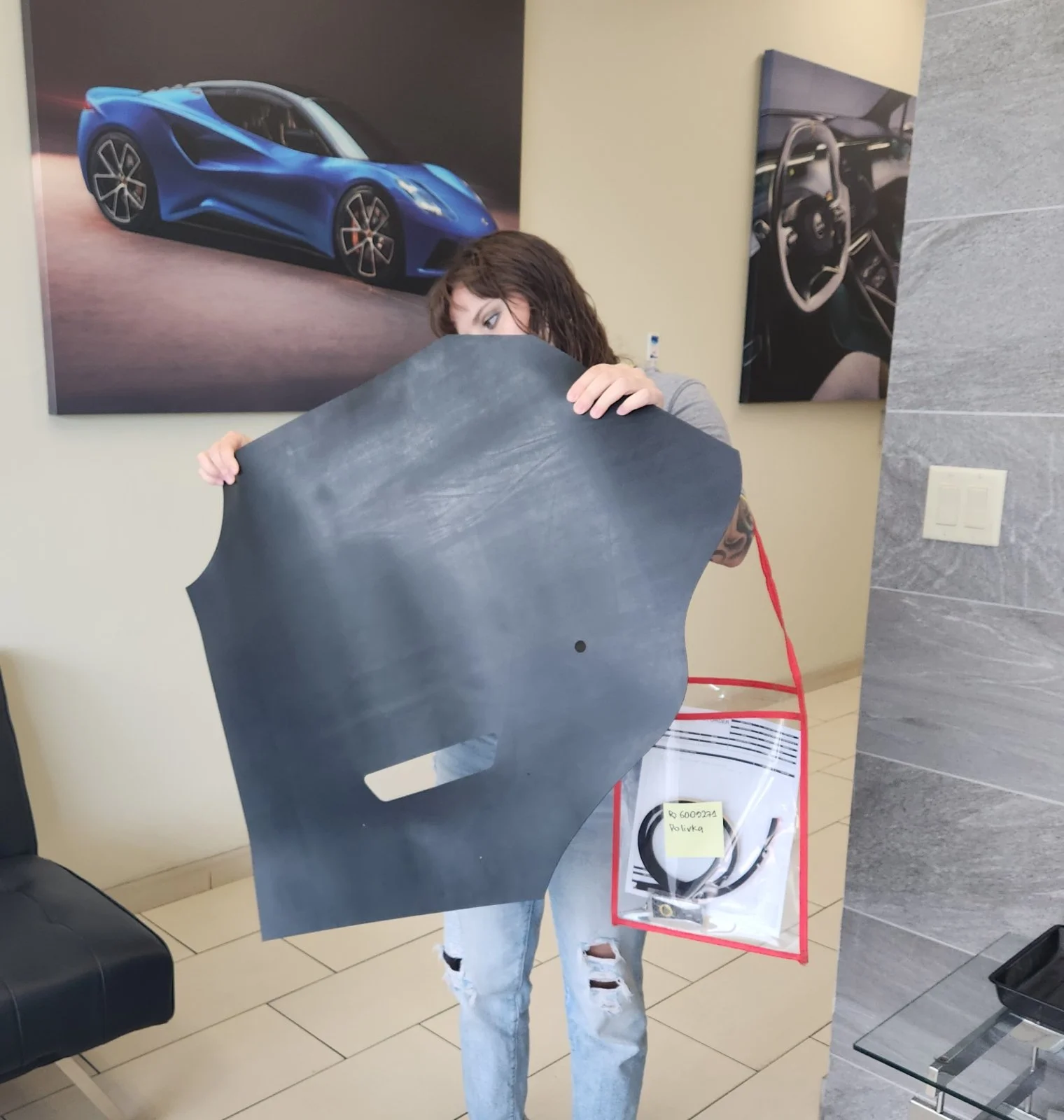

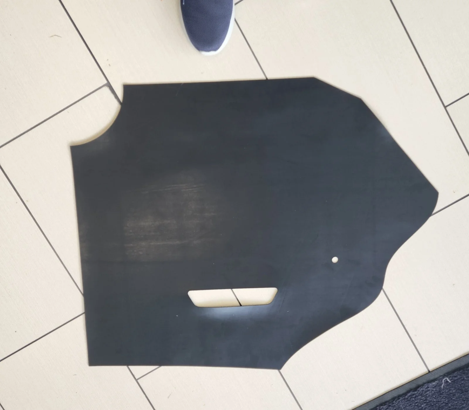

It would appear so. See part pix (shoe for scale). I imagined something more elegant from Lotus Engineering but post #288 in this thread is correct. Fine if it does the trick for water ingress protection of sensitive electronics. Check with your Dealer if you are having issues. The "update is a Lotus warranty matter. Skip this item should you wish to 'add lightness" in minor way.
View attachment 47798View attachment 47799
Geez that thing is big!
Did you weigh that? It's big enough to make this a 50/50 car.
No.
No. Was shown the part prior to install. It looks hefty but its not heavy. Imagine a rubber SUV car mat. Something else may not have the desired durability. Dealer said there is a huge demand for them, therefore hard to get and keep in inventory. If it fixes a problem you may be having, what's not to like? Yes, I wish it was more elegant, but have no idea how it appears installed.
As far as the F/R weight improvement, by god yes!
