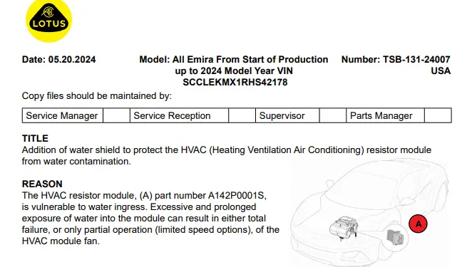

I saw this posted much earlier on in the 18 pages of this thread... does this mean the water-sensitive Resistor is an officially known issue / official recall? seems everyone here is just going in 1 person at a time, rather than under a formal service initiative ...
I saw this posted much earlier on in the 18 pages of this thread... does this mean the water-sensitive Resistor is an officially known issue / official recall? seems everyone here is just going in 1 person at a time, rather than under a formal service initiative ... View attachment 52065
The resistor pack issue is a well known problem (water ingress leading to failure) and sooner or later will affect all Emiras produced before measures taken to rectify (improved water shielding). Lotus fully aware and should be a recall. Currently down to owners to catch AC problems and raise with their Lotus dealers within the 3 year warranty period.

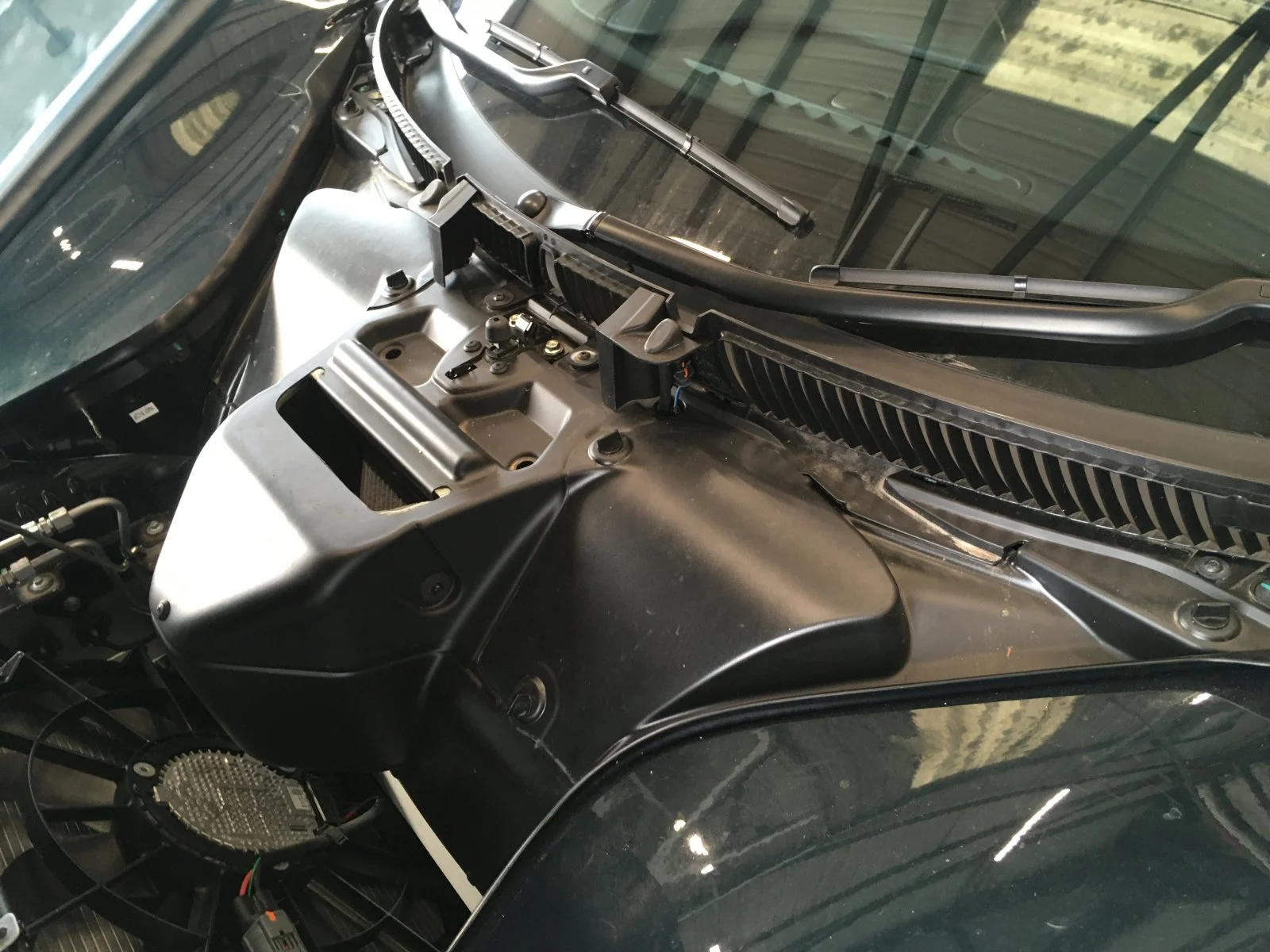

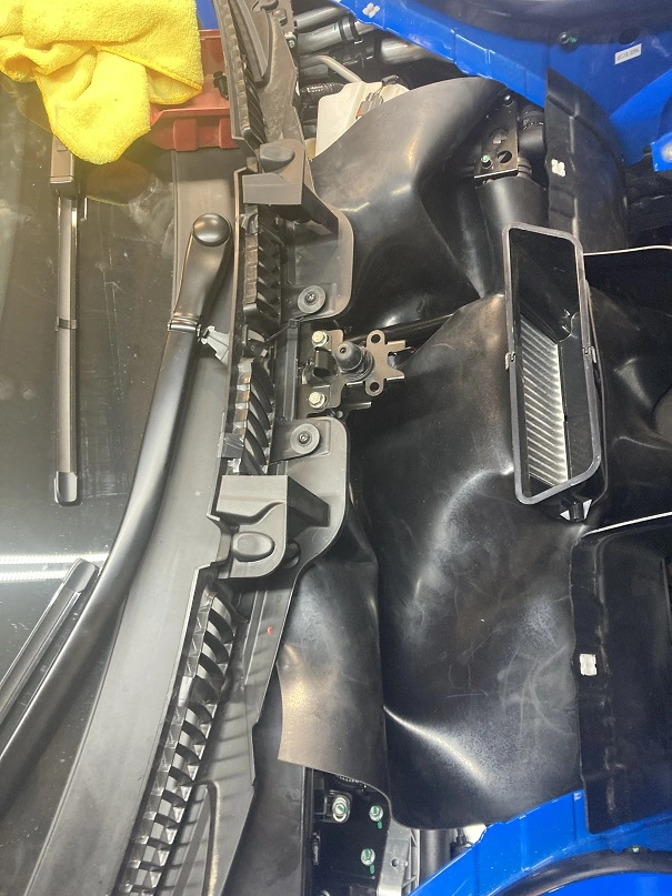

Just had the AC 'shield' thing done and was tracking down a possible issue in the cowl. (see NA prob thread) Was curious also for a better view (both sides) of the shield too. Here is a better view of it. Basically a large flap of plastic. I slightly improved the folds to channel water away and not pool up.
The way the shield is attached may add an extra minor step when its time to do the pollen filter though.

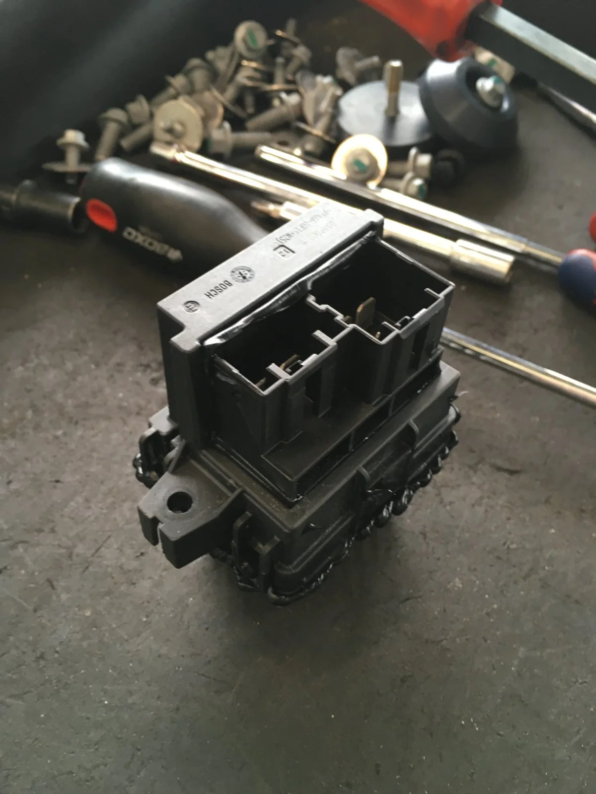

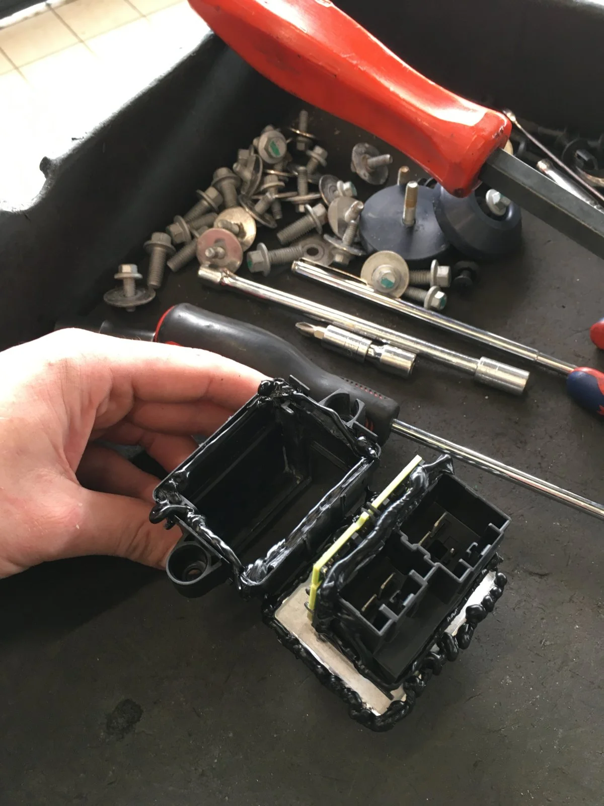

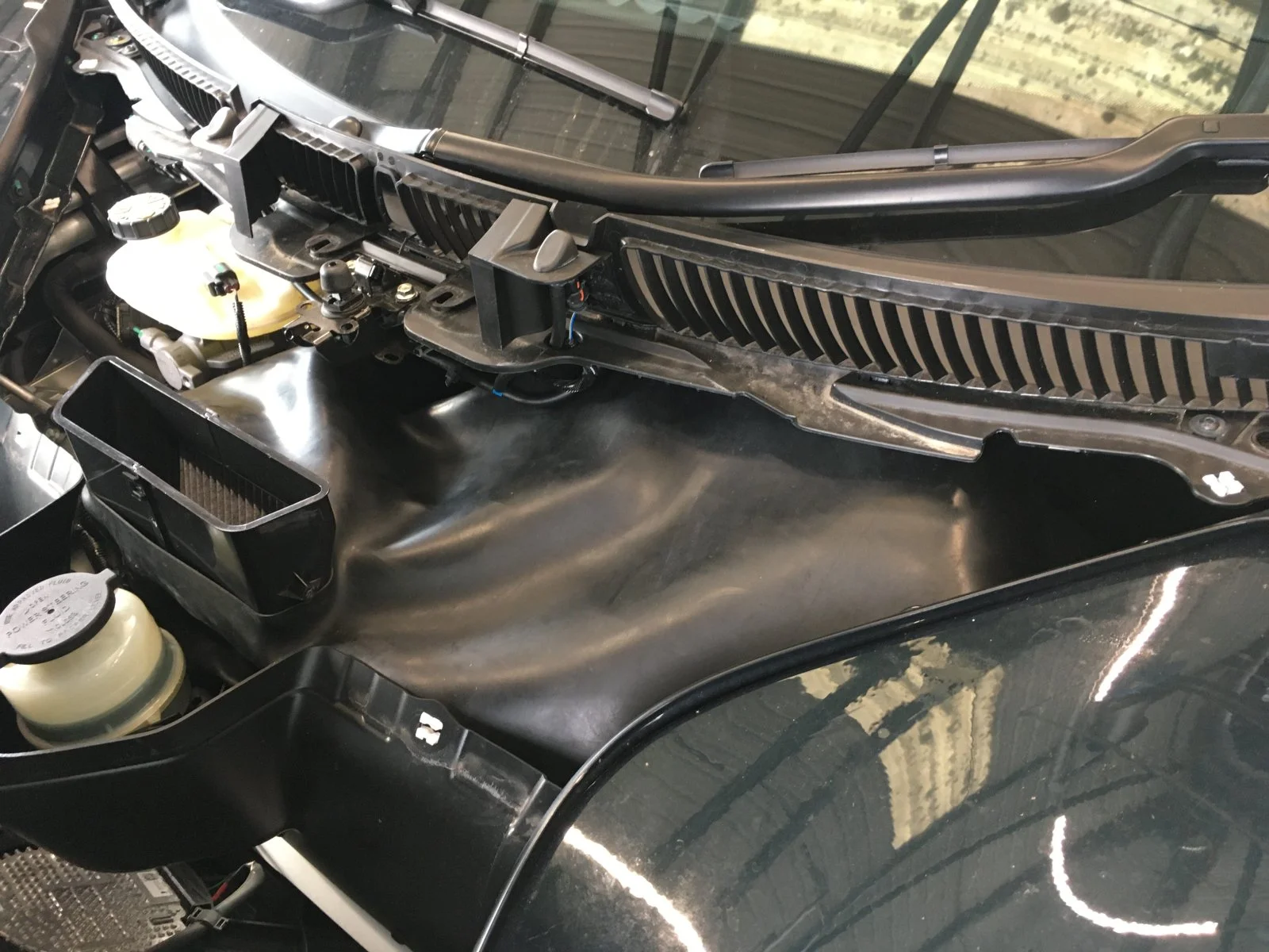

I received some pics from Lotus Kent when they replaced my failed resistor - hope this is helpful to some people?
the 'water shield' sheet was already fitted upon delivery (pictured), so they have beefed up the water protection by sealing the plastic enclosure that the resistor lives inside.. so hopefully its going to be forever waterproof now.
Yikes. That’s ALOT of bolts.
Your first pic that shows the shield in place looks quite different (better) than my install by dealer (2 posts up). LHD and RHD differences aside. The folds and fitment is different.
Dont think mine has that reservoir labeled power steering on cap in front of the cabin/pollen filter either. On the V6 the manual says thats in the engine bay.
EDIT: Maybe you have the AMG?
Not the best looking solution but I suppose if it fixes the problem.
Yup - AMG!

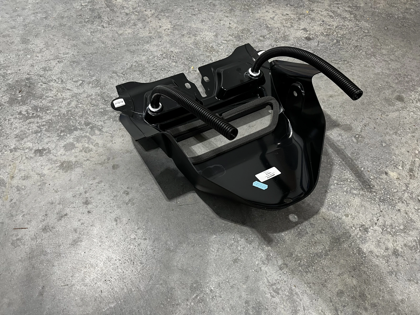

Since my Emira is indoors for the winter and I live 150 miles from the dealership, I decided to make my own rubber air con resistor pack water shield. I bought a 36" x 36" rubber sheet (1/16" thick). I made a template using the photo in post #314. Here's a pdf if you want to use it. You will see that I shortened the part that goes under the cowl because it was way too much material to stuff under there. Also my center cover has two hoses attached that direct water down and away from electrical connectors. Does anyone else have them? I haven't seen them mentioned. If you cannot enlarge the pdf, DM me and I'll try to send you a full size template in another file format.
Since my Emira is indoors for the winter and I live 150 miles from the dealership, I decided to make my own rubber air con resistor pack water shield. I bought a 36" x 36" rubber sheet (1/16" thick). I made a template using the photo in post #314. Here's a pdf if you want to use it. You will see that I shortened the part that goes under the cowl because it was way too much material to stuff under there. Also my center cover has two hoses attached that direct water down and away from electrical connectors. Does anyone else have them? I haven't seen them mentioned. If you cannot enlarge the pdf, DM me and I'll try to send you a full size template in another file format.View attachment 59337
Yes, have drain tubes.
