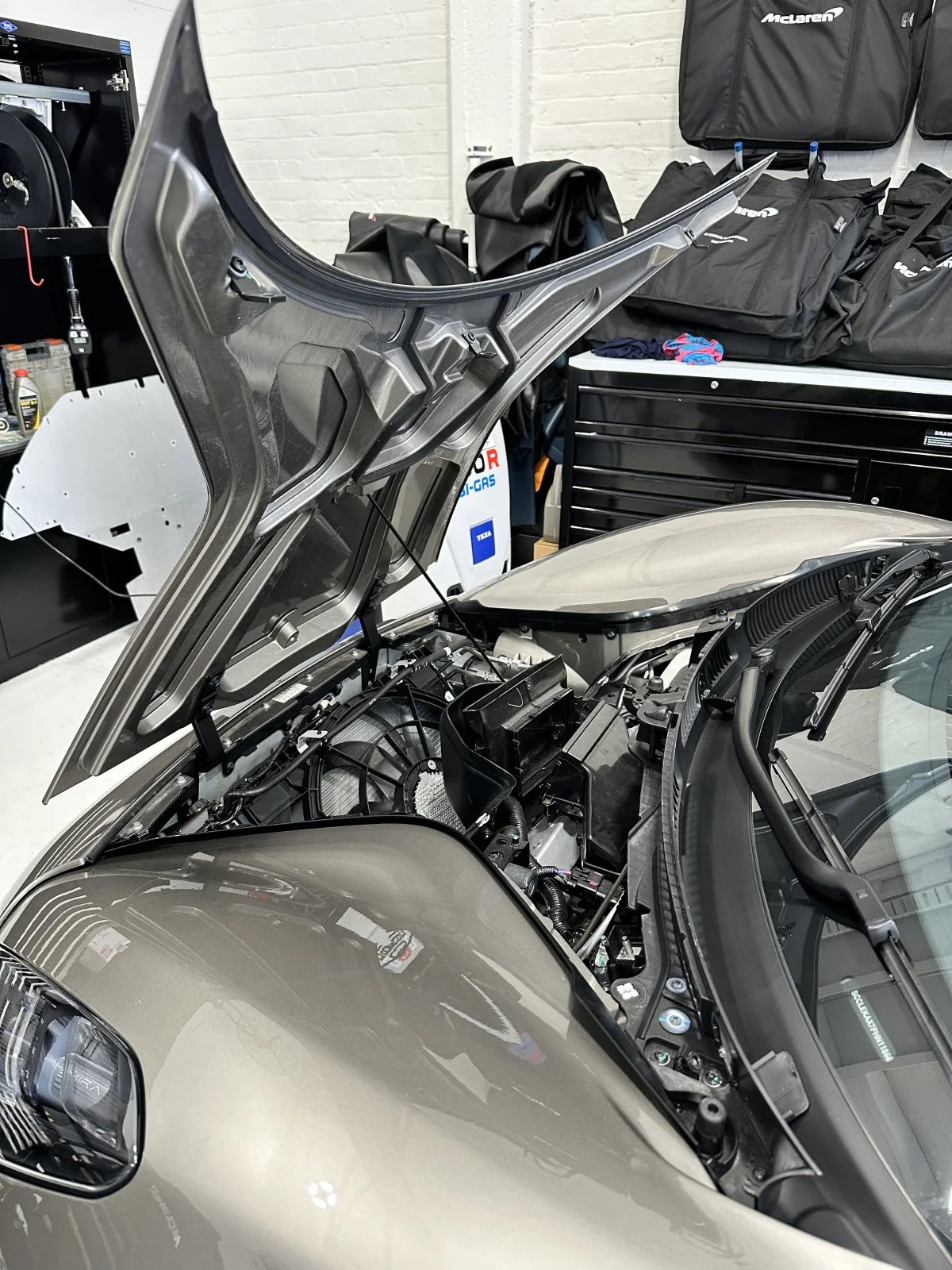

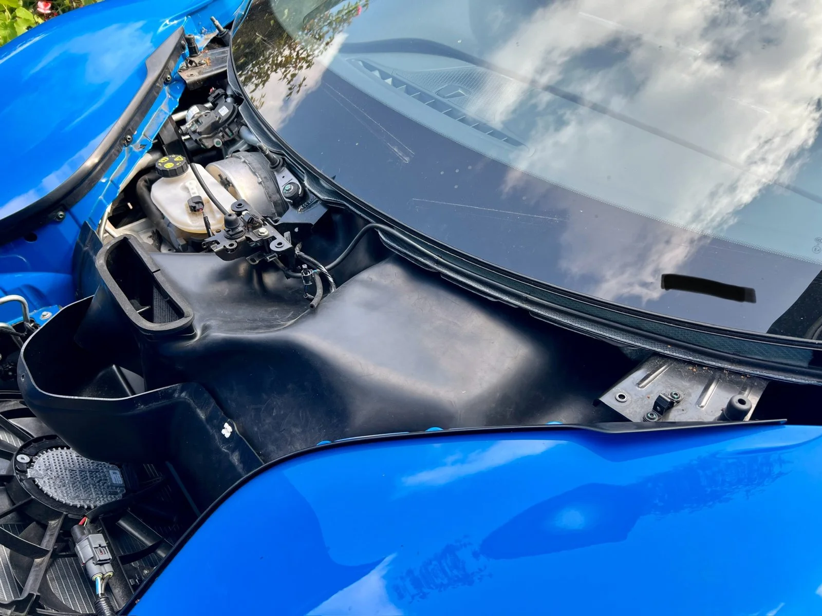

Not as sad as you’ll be when you actually see it:
A sheet of rubber stuffed up under the screen.
Complete with a channel to collect water.
And if access is required to the fusebox it’ll have to be dragged out and stuffed back in afterwards.

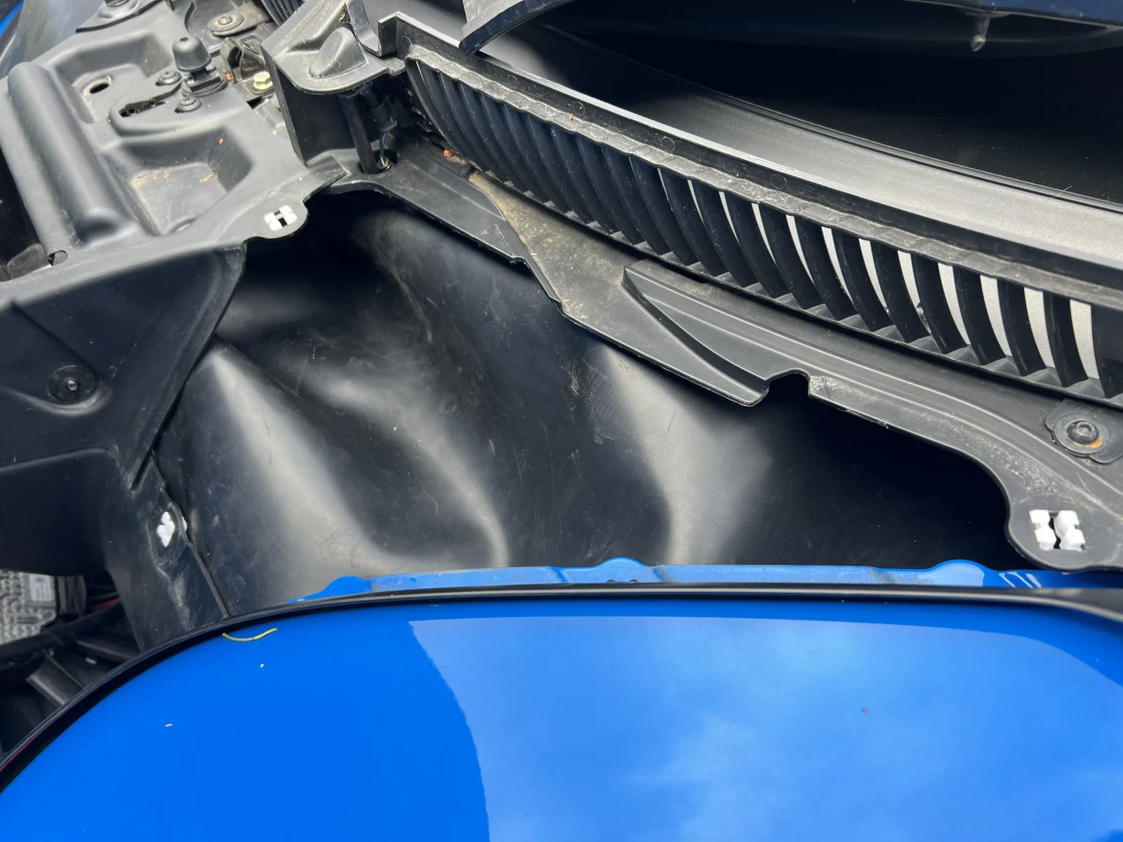

I didn’t like the look of it so tidied mine up:
Are the plastic covers re-installed after the shield is put in place? Or is this the final result?
Yes they are, so if installed correctly by the dealer all you see when you open the frunk is the plastic covers which are detachable by turning the plastic retaining fasteners. The finished job is actually quite neat and your resistor pack shouldn’t get any water ingress in the future.
