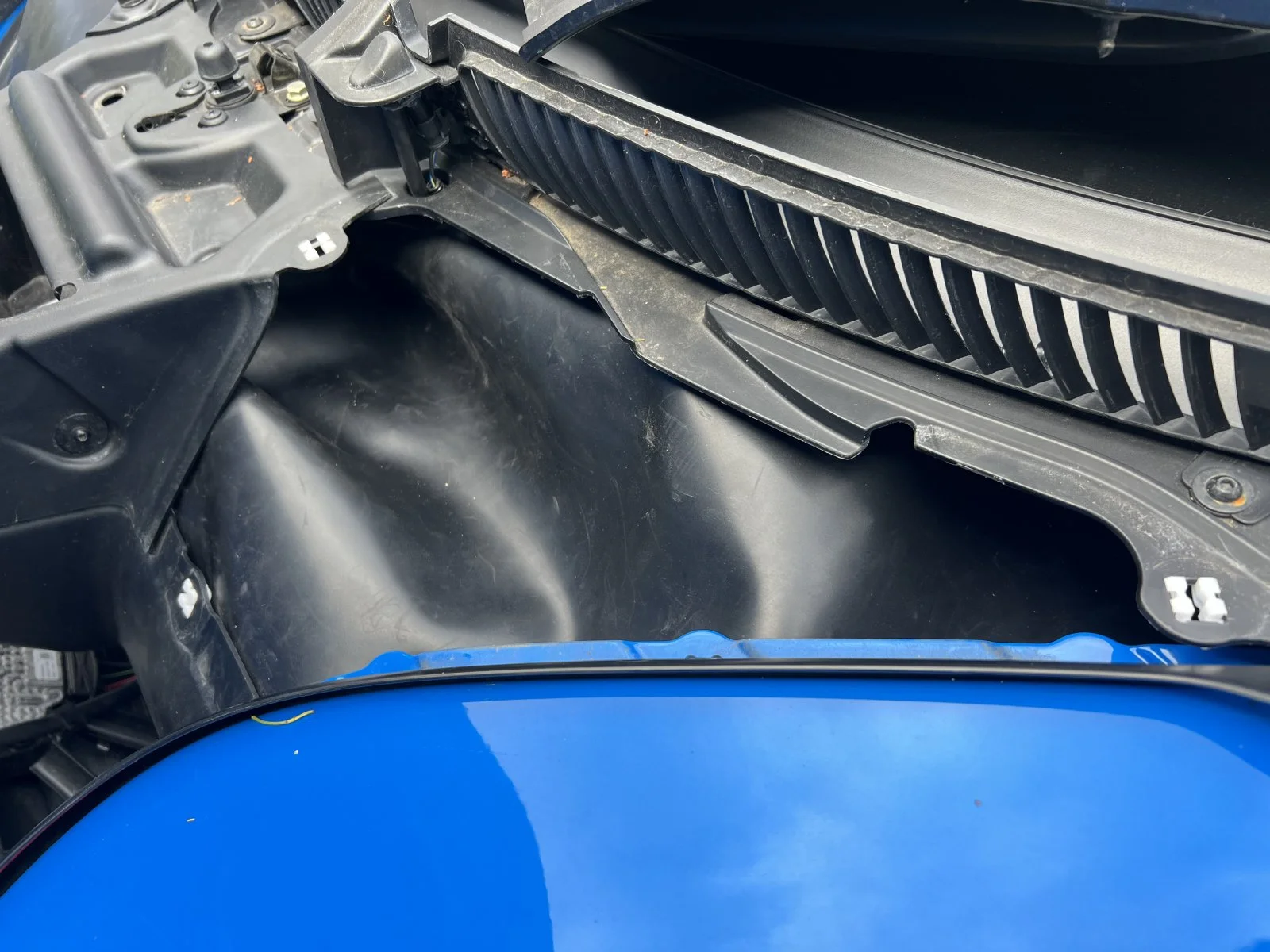

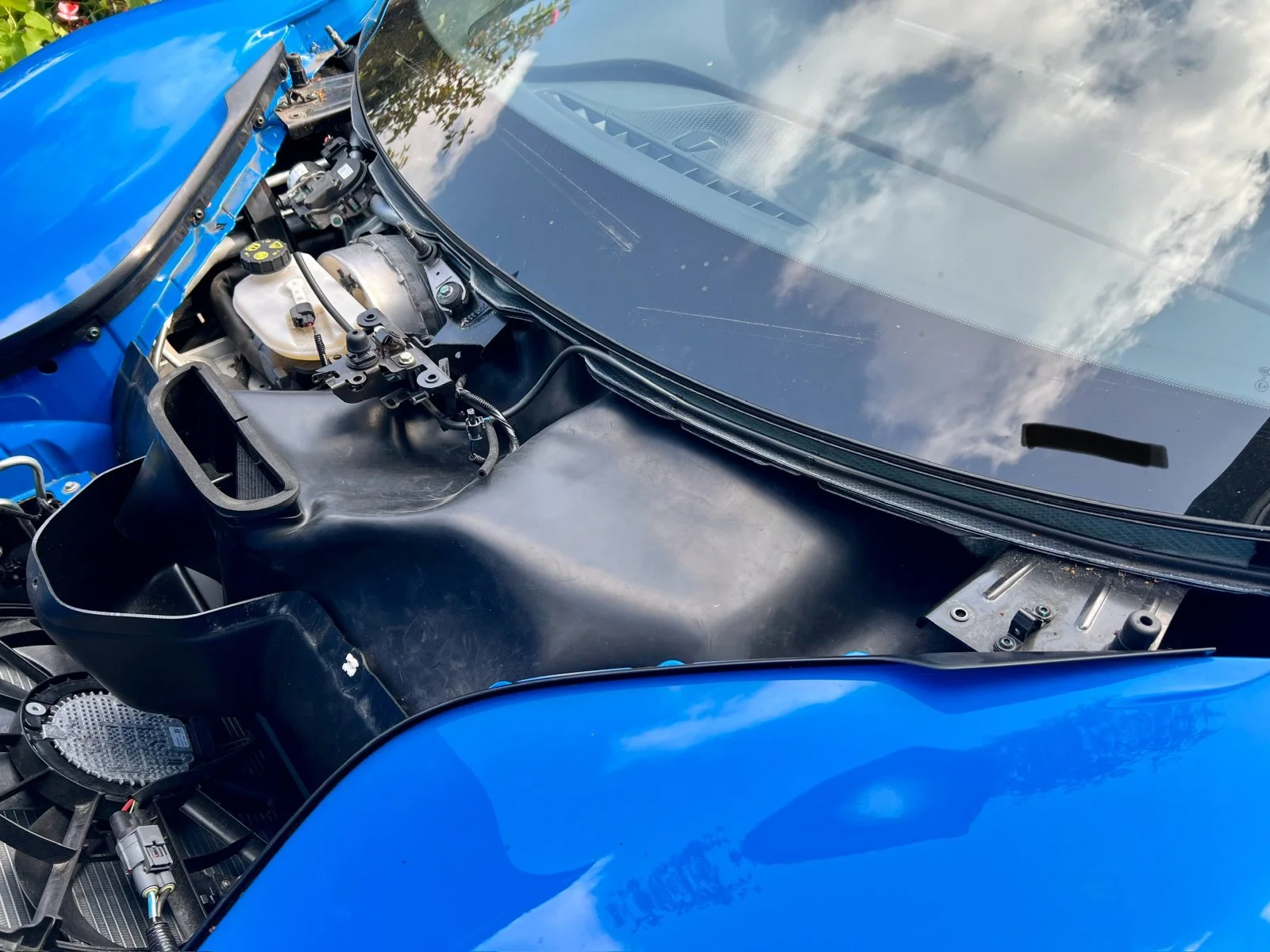

Not as sad as you’ll be when you actually see it:
A sheet of rubber stuffed up under the screen.
Complete with a channel to collect water.
And if access is required to the fusebox it’ll have to be dragged out and stuffed back in afterwards.
I didn’t like the look of it so tidied mine up:
If it works as intended I don’t care what it looks like. Being functional is more important to me than being pretty in this case. You’ll never see it unless you’re having to do repairs.

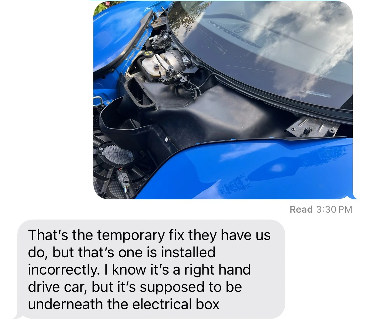

Wonder if US fix is the same? Mine goes in on the 15th of July to get fitted. I will try to get a picture and info on it.

Hmmm, looks like they actually remove quite a bit of parts and the cover/mat is pretty large in size.
