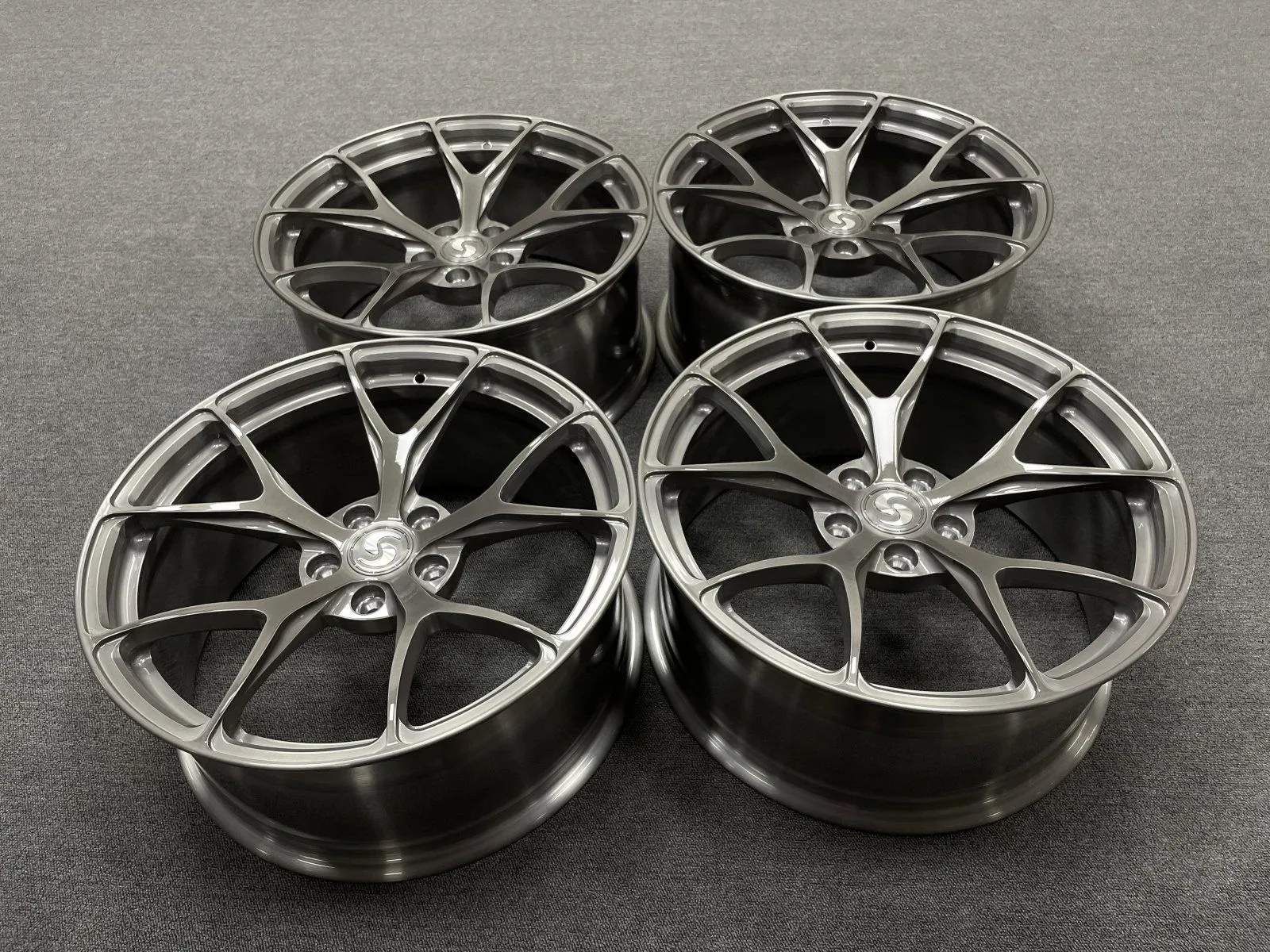

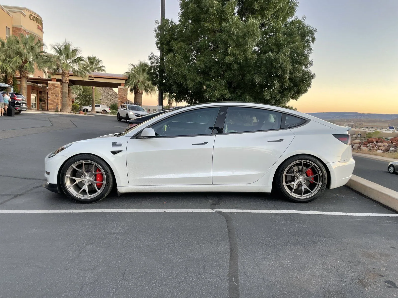

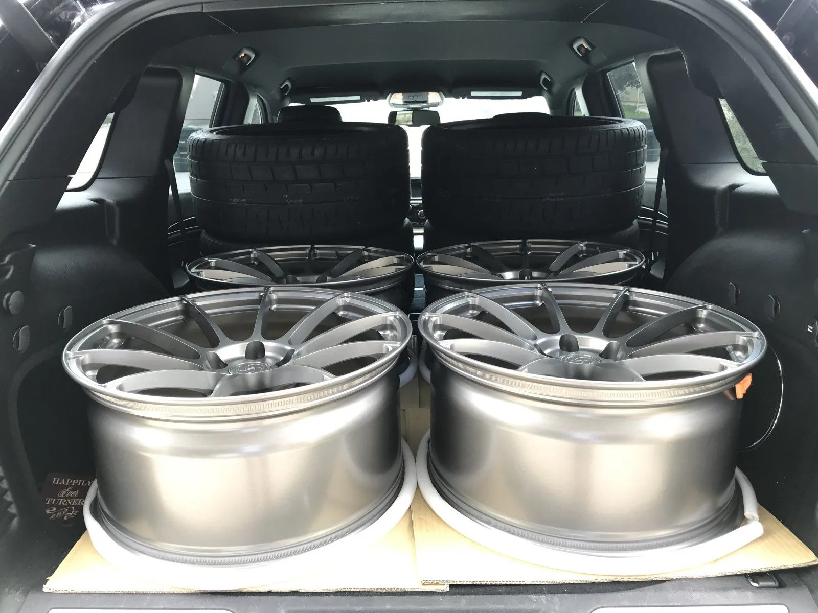

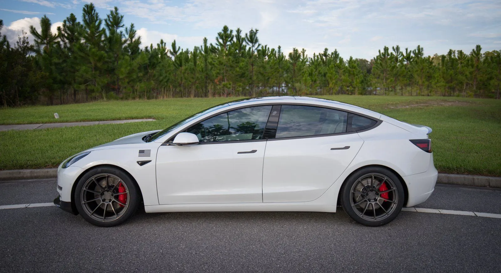

I was told to expect 19-20lbs (9kg) for the front and 20-22lbs (10kg) for the rear in stock Emira sizes. Since they're made to order, I'll likely push the offsets out 5-8mm from stock to get a little more concavity and more flush fitment. Example pics below:
Track:
Signature SV501, Matte Gunmetal, 19"x9.5" +35, 19.4lbs (cost $3600 shipped in 2019)
Street:
Signature SV104, Brushed Titanium, 19"x8.5" +20, 18.8lbs (cost $3800 shipped in 2021)
Track:

Street:

Track: Signature SV501, Matte Gunmetal, 19"x9.5" +35, 19.4lbs (cost $3600 shipped in 2019)
Street: Signature SV104, Brushed Titanium, 19"x8.5" +20, 18.8lbs (cost $3800 shipped in 2021)
