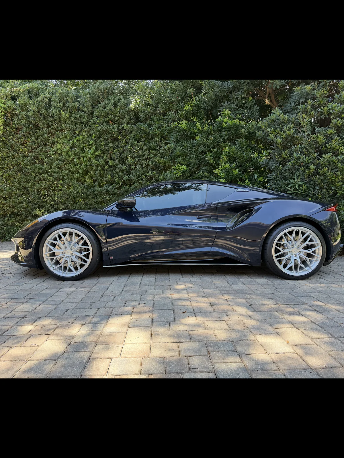

Very nice. Is that a 2 piece wheel?
Is the center a gold color or is it all the same as the polished lip?
Yup. 2 piece and the face is sort of a champagne gold in a polished finished with the lip being polished silver. I really like how subtle the gold is.

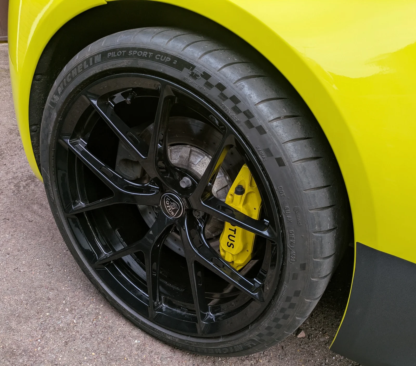

Almost a year after they were delivered I've finally been able to mount my new Aerie V2 wheels. Gloss black - so I had to dust them a bit as they had been sitting a year in my shed - you can see I missed a bit on the rear wheel from the photos.
The seem to very well made, no issues at all with them I can see, no fitting issues and my usual tyre guys had no problems fitting the tyres on them.
The difference in weight between these and the stock wheels is noticeable just from moving the wheels/tyres around (between shed and the car).
I think they look great on the car.
