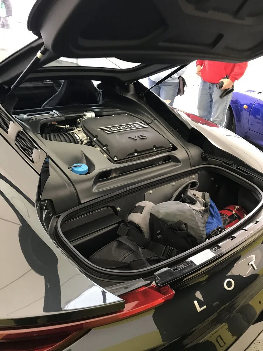

It'll certainly stand out. This is what it looks like on an Evora V6:
... and here's the Emira from the same angle for comparison:
